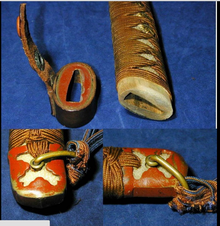

Rather large sarute
Mark C
 Plain sarute are quite common, and especially so on plainer mounts as would be expected. This one looks like a replacement though. Most Gunto mounts are brass, but with a copper finish, either electroplated on, or possibly achieved by acid treating to remove the zinc from the alloy. The reason most likely being that casting brass is quite easy, but copper is a different matter needing a higher temperature and not flowing into the mold as readily or accurately. Brass is also a fair bit tougher and harder than copper
 The copper finish does rub off though either through wear or overpolishing.

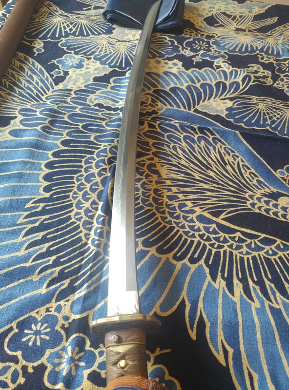

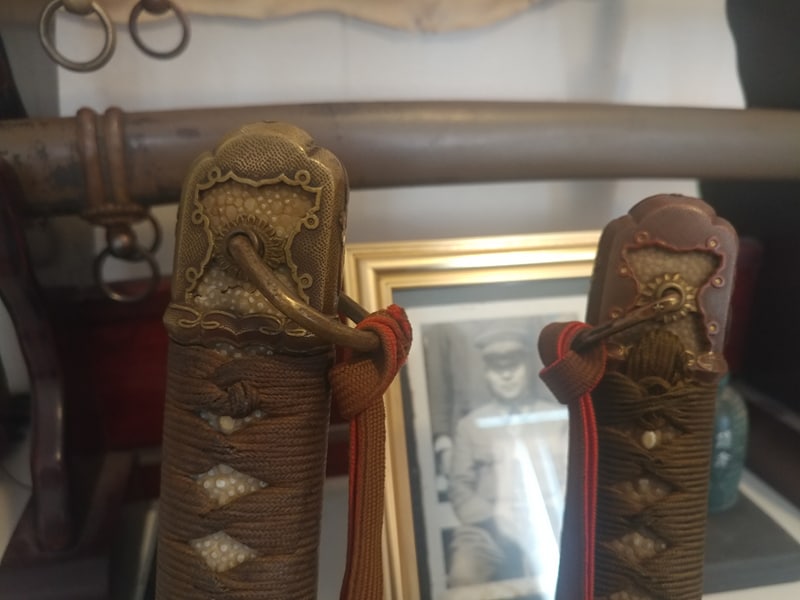

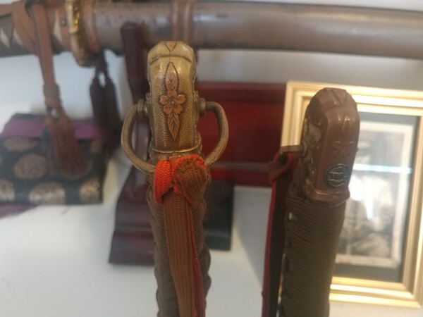

A few more pictures of the rest. The blade I'm still trying to work out, Mumei, 241/4" nagasa.
Pierced tsuba, 6 seppa and an ashi which I have not encountered before.
