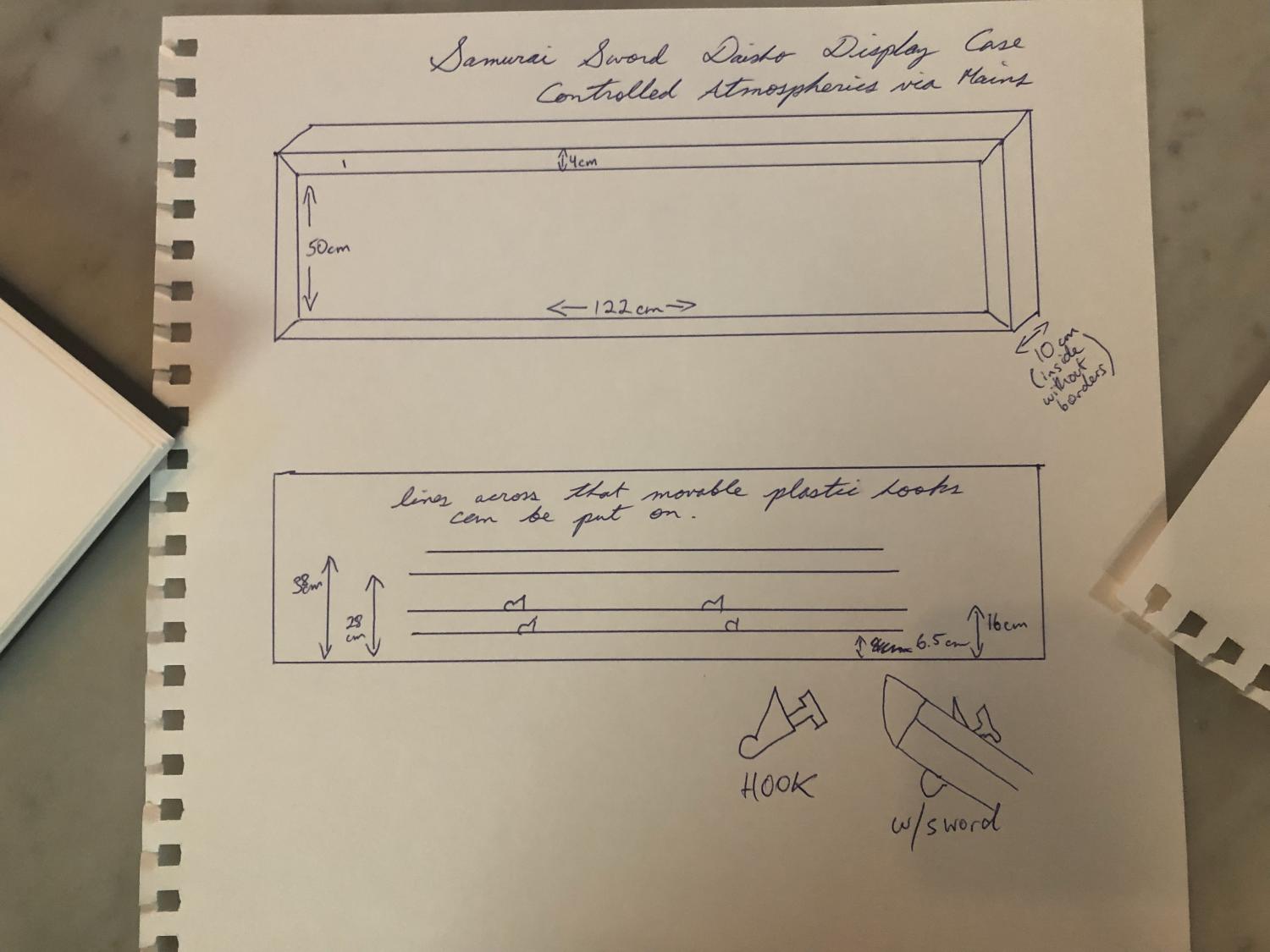

Thought I would get some consensus from the community on a project I'm trying to get done.
BLUF- Trying to make a sensible medium-term display case that doesn't inherently constitute damaging the blade but in which the BLADE IS OUTSIDE OF THE SHIRASAYA.
Intro- I have not come across a display case (bar one made to handle earthquake tremors) that really is custom-made for nihtono. 'Museum case/choji oil pot in the corner' seems of limited value as its impractical for my home setting and the atmosphere control is poor.

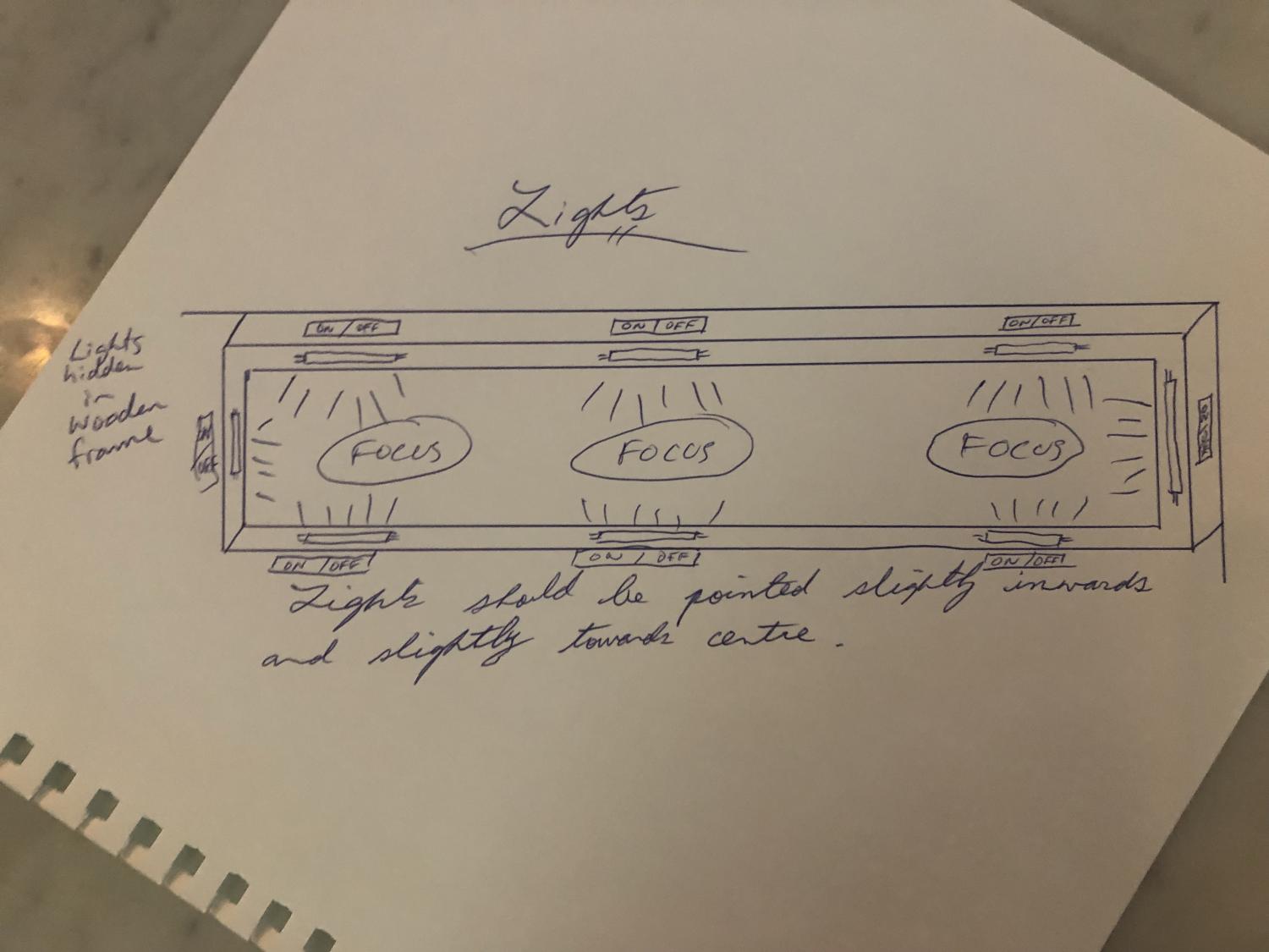

Aim- So I'm trying to configure a wall mounted display case, electronically controlled atmosphere, maybe filled with gas instead to give that added security. I can't find anyone who's tried this so I am aware it may be a novel idea for some. Nonetheless, why not? Got initial quotes, bulb requirements from Nakahara's book (trying to recess the bulbs into the frame to minimize atmospheric affects).
If it isn't obvious already, the end-state is an ability to appreciate the nihonto as practically as possible behind protection on an  everyday basis.
Does anyone have any practical advice/experience for such a project?
Regards,
Cameron
Draft_Case.pdf

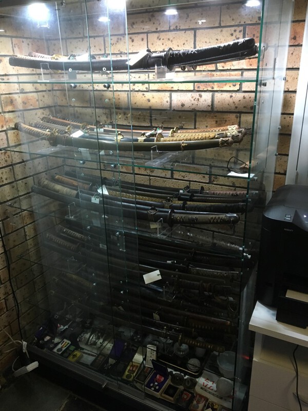

Hi Cameron, I picked up some glass, shop display cases, each holds upto 45-50 swords. I got a sign factory to make some perspex stands to my design. Try a shop-fitting company. These have LED lights, and room on the base for other stuff.
  • Like 6
