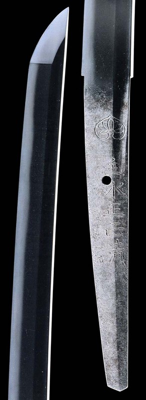

I just now have found a wakizashi with cutting test, by Echizen Yasutsugu 1st with Hollyhock crest, retained by the shoguns Tokugawa Ieyasu and Hidetada. The cutting test was executed  three  times on three different bodies. Also, has horimono  cherry blossom tree with (plum) flowers.Christie's Catalogue1551  3/29/05. I'll post a picture as soon as I find my camera.

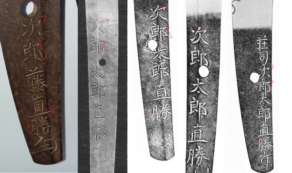

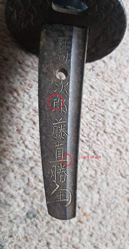

Alternatively, you can compare the signature to that of examples which have already been judged as legitimate by shinsa - as I have already done for you (most of the examples shown are from around the same date in the Tempo era). Unfortunately, however, in my opinion, there are too many discrepancies in the signature for it to be considered legitimate.

Thanks Kyle for the signature comparison. From the samples you provide I clearly agree with you, too many discrepancies. That's a pity because the story of the custom order and the dating seemed to be in line. Steve, I took a closer look at the blade, there are lamination flaws as you say. Naokatsu made close to perfect blades. He would not have had any lamination flaws on a custom order blade.
Still worth to have it handled by a local collector or two. Sometimes we have variations in signatures that are not accounted for in the documented examples...
