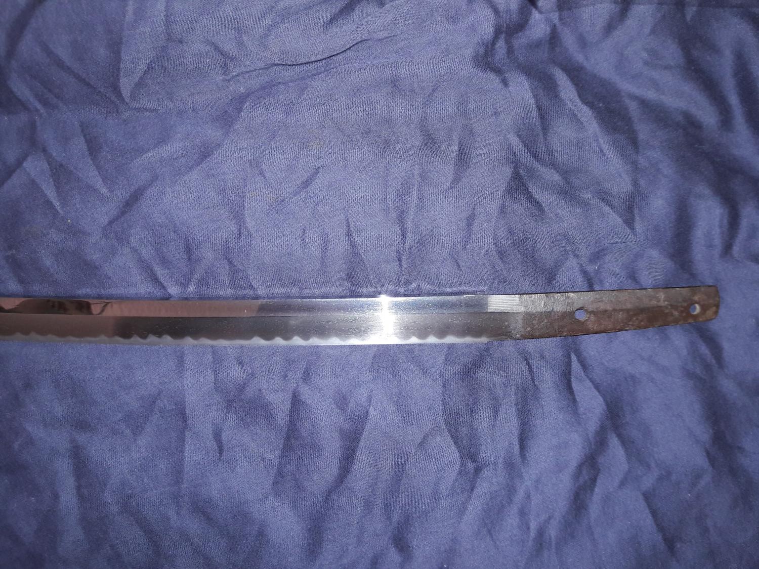

I wanted to post this again with better pics and more info. Please critique away as I feel my attempt at Kantei could be wrong on certain areas. I also wanted to know if this could be earlier than Muromachi or possibly Naoe Shizu or Ichimonji? Not saying it is, just being hopeful. Blade is tired in some areas from polishing but other than that, it's good.
Nagasa: Approx. 18.5"
Nakago: Approx. 4"
Mihaba: Approx. 1"
Sori: Approx. .2" (.6cm)

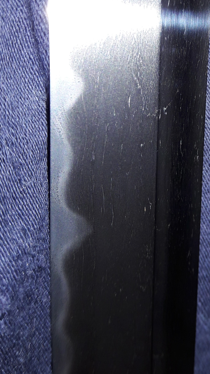

At first it looks like "Sanbon-sugi" but the more I look at it, the more I see a Gunome/Ko-Gunome with some Ko-Midare or areas of Suguha. There are no uniform points or "3 cedar". It's very uneven.

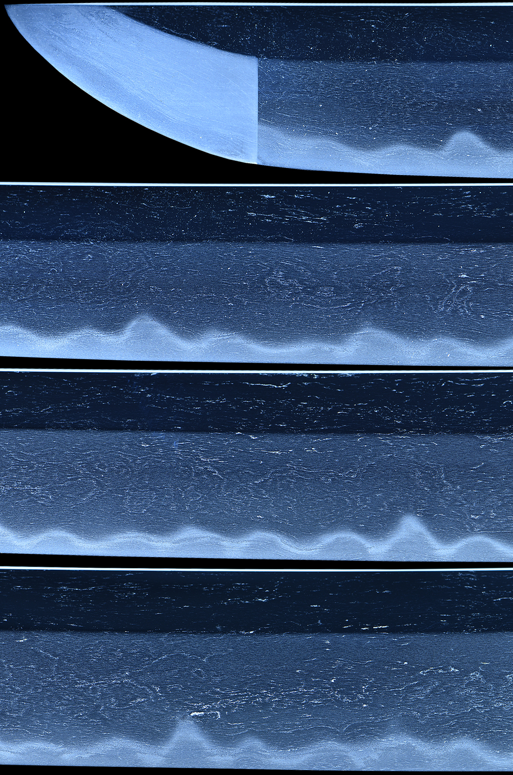

The Utsuri is amazing and cannot be captured with the camera. With the naked eye, the hamon appears totally Gunome/Ko-gunome (without pointed tops) but under the right lighting, the tops become more pointed, with foggy, almost ghost like tops that disappear when the sword is moved(Nie Kuzure maybe?). Up close you can find many other things as well as Sunagashi and nie all along the Ha.
The jihada appears to be a rough O-mokume with masame along the ha and at the very top close to the mune. The Mokume is in the Hiraji, on the Shinogi line and somewhat into the Shinogi-ji. It only stops for a few MM close to the mune and ha, where the masame(sunagashi along ha) takes over.

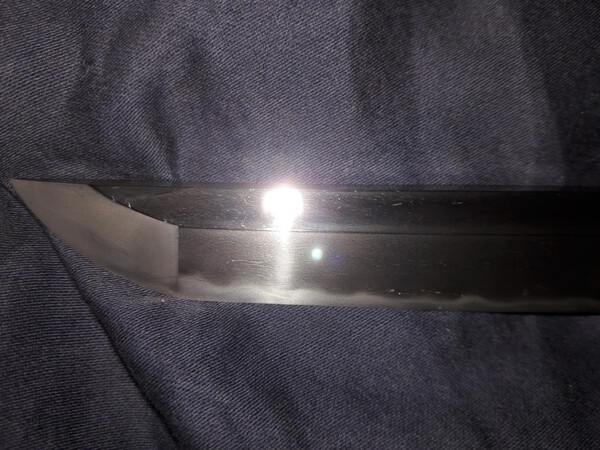

I'm sure you've all seen the Chu-Kissaki with the crazy Hakikake "swirl".

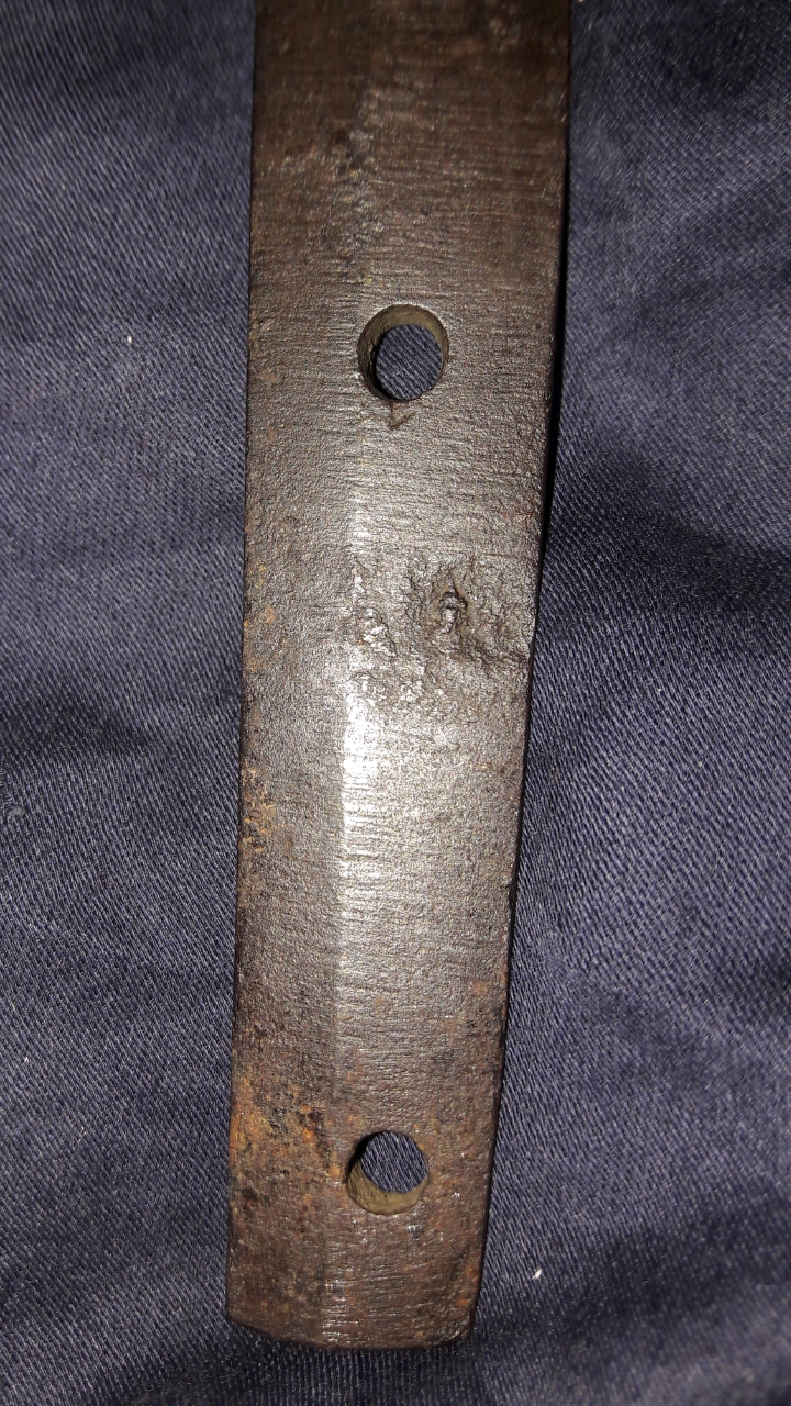

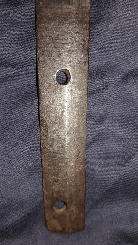

The nakago is Kiri with kiri yasurime. No Mei. Looks to be O-suriage
Mune is Iori.
So at first this looks to be a typical Mino "Sanbon-sugi but looking closer, all kinds of things start jumping out. The steel/iron has a blue/light blue look to it with billions of sparkling microscopic aspect in the steel. The Shinogiji is mirror burnished but appears black as night in certain light..

Mino and what is being described is the effect of nie scintillating on the blade.
Interesting, thanks!
For reference, you can see it in pic #5 and last few pics. Without flash, or at a different angle, the "shadow" on the top right, is what I'm talking about. Otherwise it's invisible
One of the pics towards the end shows it directly on top of a "peak", making it look pointed but when you look at it at a different angle or light, it becomes almost flat, making it appear more Gunome
