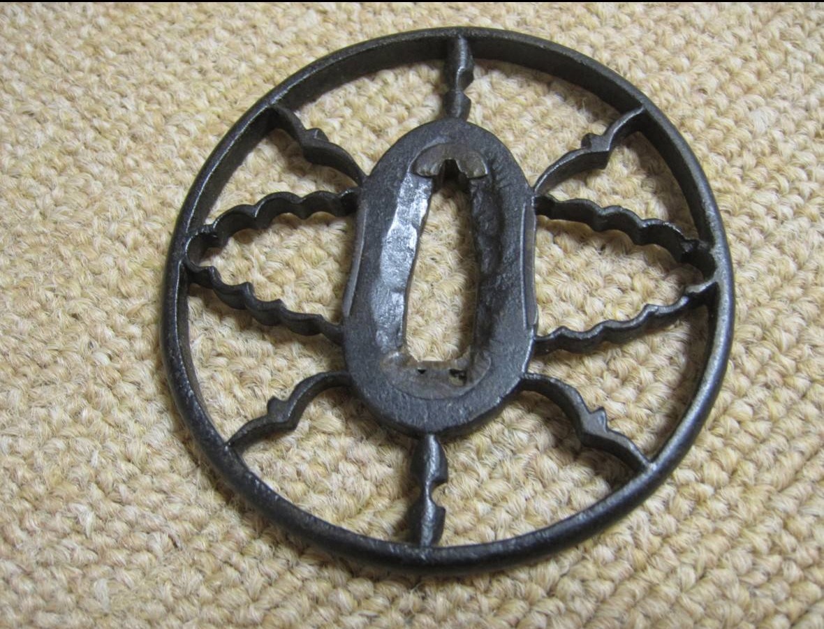

Iron tsuba are not usually my thing, but the simplicity of this one appealed to me. In particular, the naïve design of geese in flight, the quality of the iron, and the shakudo sekigane.
Whilst I see Akasaka and Owari characteristics, I'm not confident in making any such attribution. I would, however, appreciate the opinions of those well-versed in iron tsuba.

My take is Owari with the possibility of Kanayama.  The dishing / concave tagane of the seppadai is very Owari.  The size points to a possibility of Kanayama.  I suppose Akasaka is possible but I'm not buying that even though the seppadai is a bit tapered.  It's a very nice tsuba in any case with interesting sekigane placed later in kuchibeni style.

There seems to be a consensus on 'Owari'. I'm pretty happy with that!

Other than one point of iron loss near the 3 o'clock position, it is a very clean nice condition example.
I wouldn't bother throwing money away getting it papered, but might have had a fitted box for it to show off the sukashi if it proved as nice in hand as it looks in the pictures.
