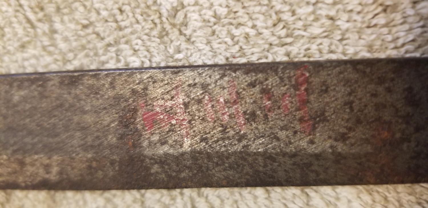

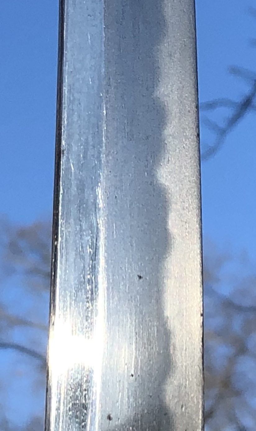

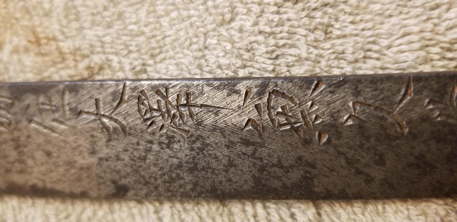

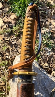

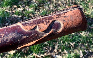

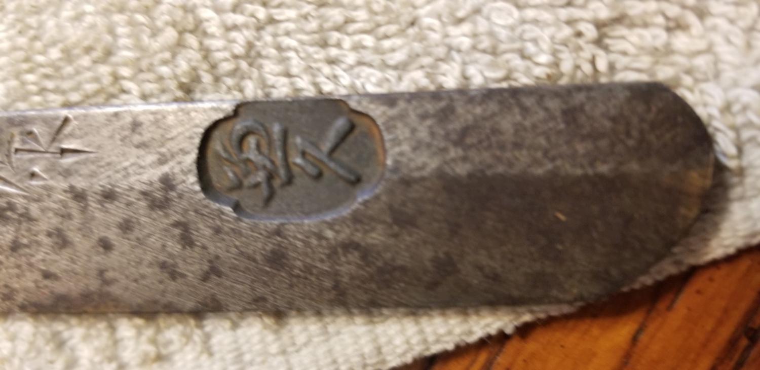

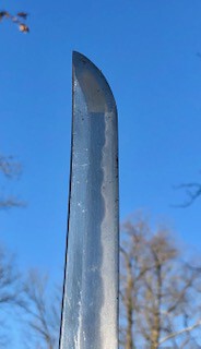

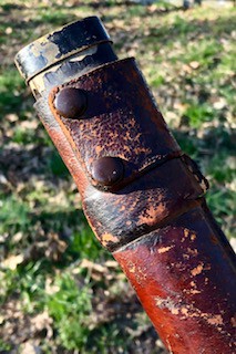

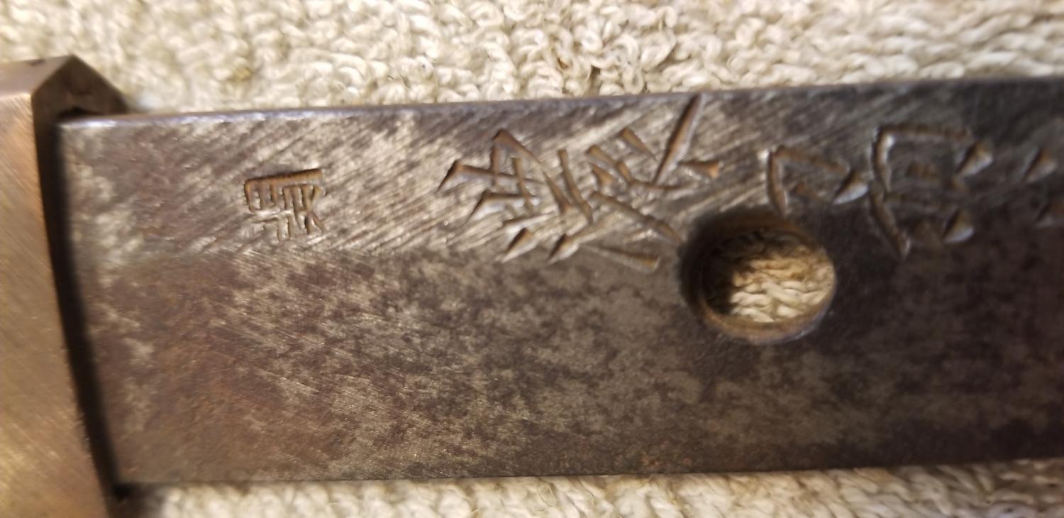

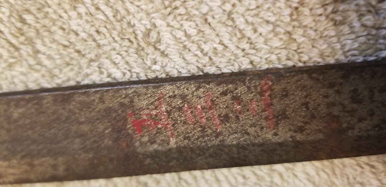

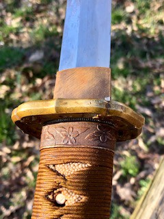

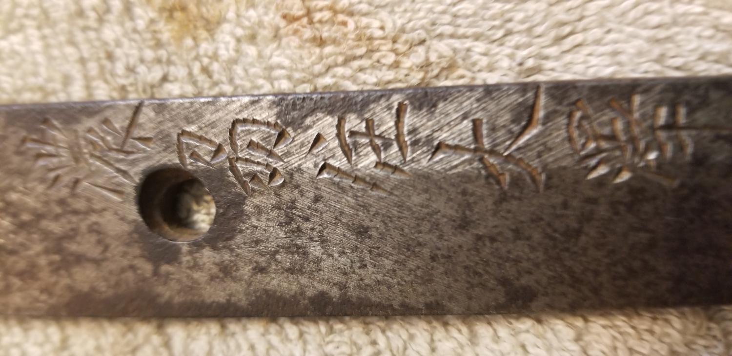

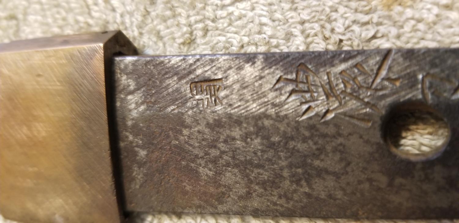

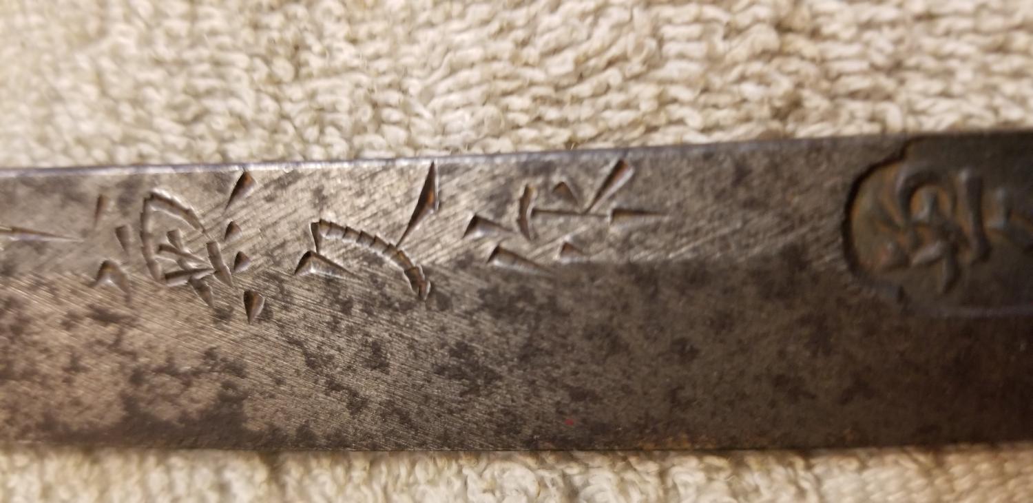

This sword is my first Japanese Shin Gunto sword. I have ordered 2 books but they will not arrive for a while Any info on Maker, Date, Where is was made, etc would be so helpful I am not having luck on the internet through Google and a friend's Japanese Girlfriend could not understand it.post-4896-0-34726300-1553312445_thumb.jpgpost-4896-0-52590200-1553312435_thumb.jpgpost-4896-0-15251100-1553312427_thumb.jpgpost-4896-0-70437900-1553312417_thumb.jpgpost-4896-0-87378800-1553312404_thumb.jpgpost-4896-0-00768600-1553312374_thumb.jpgpost-4896-0-70875300-1553312366_thumb.jpgpost-4896-0-29226500-1553312348_thumb.jpgpost-4896-0-67731700-1553312332_thumb.jpgpost-4896-0-26943100-1553312264_thumb.jpgpost-4896-0-60848500-1553312245_thumb.jpgpost-4896-0-60848500-1553312245_thumb.jpgpost-4896-0-48681000-1553312210_thumb.jpgpost-4896-0-57595400-1553312199_thumb.jpgpost-4896-0-16897100-1553312187_thumb.jpg
Noshu Ju Ozawa Kanehisa Saku (Resident of Noshu Province, Ozawa Kanehisa Made) with the Seki Arsenal stamp at the top and a hot stamp (personal seal) at the bottom.  This is a non-traditionally made sword and there is no date but during the war for sure.  The red paint is the number 533, used to keep track of parts.

As to the girlfriend's inability to translate the kanji - the kanji used during the war were much simpler than the ones used today. When I first started out, with my dad's Mantetsu, I asked an older Japanese lady to translate the Koa Isshin slogan. She got most of the individual sounds right, but not being familiar with the wartime slogan, she had no idea what it said or it's meaning.
