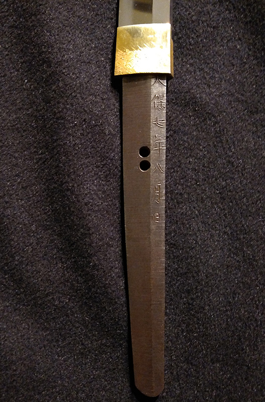

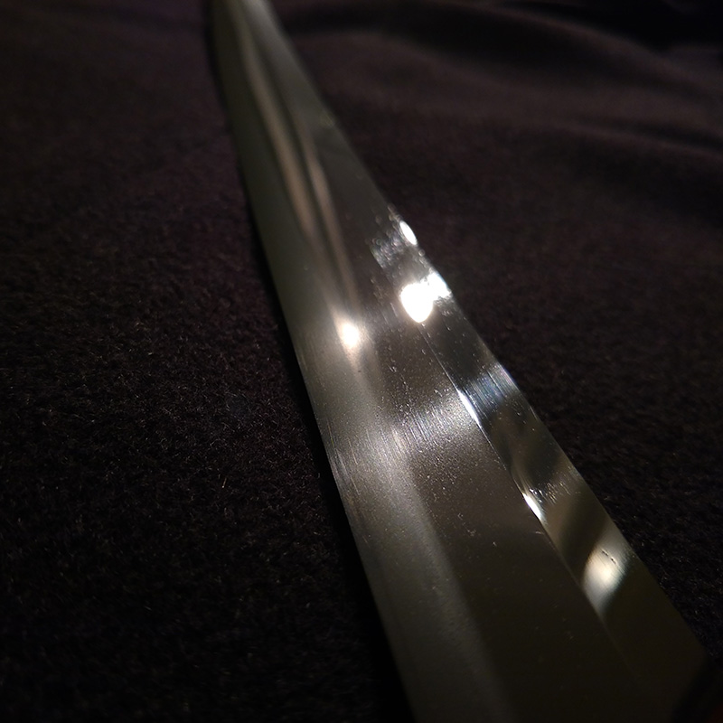

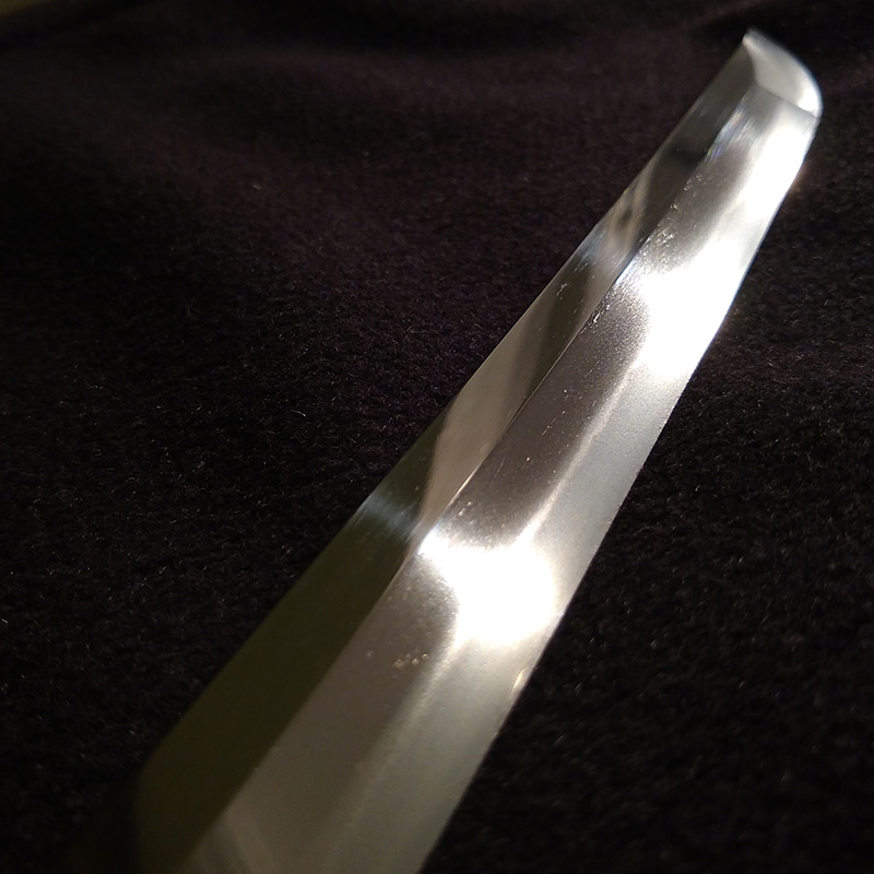

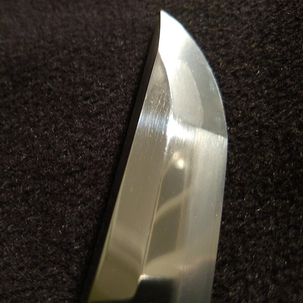

This is something quite special. The blade is a long tachi by the hachidai (eighth generation) of the mainline Tadayoshi school. He was considered one of the best smiths of the entire Hizen-to lineage. Unlike most examples one will see, this sword is signed with the smith's zokumei (personal name). It is dated a day in the 8th month of 1836. The nagasa is 69.4cm and the blade is extremely healthy, even to the point of showing a trace of ubu-ba. The hamon is extremely interesting, and shows even better work than I have typically seen from this smith. The hamon while suguha based, is mixed with ko-choji and has deep ashi and yo. It resembles one of the fine works of Rai Kunimitsu and was clearly made to reflect the great works of the Rai school. The jihada is a uniformly tight and well forged ko-itame with ji-nie (konuka-hada). The blade is in shirasaya with gold foil habaki. This Tadayoshi tachi has been authenticated by the NTHK.

Hi Ray.....although this post is some 3 odd year old I do have a question from an newbie (me).....I have access to a potential Tadayoshi here in the UK. I am assuming at all stages that its Gimei un til I can prove otherwise. I am using a host of literature and currently looking at both the Mei and nagato shape. Mei 'appears' to be 8th gen (hence my query here). However the literature seems to suggest the nagato shape is 9th - i.e. the curve on most 8th gen is fairly symmetrical - in that the left hand highest point is almost the same on the right. Mine seems to be higher on the right-hand side very much like yours.
Do you have any comment? is the majority of literature based on 'common' and there are always variations - thus possible an 8th gen tang can be same as a 9th gen?
