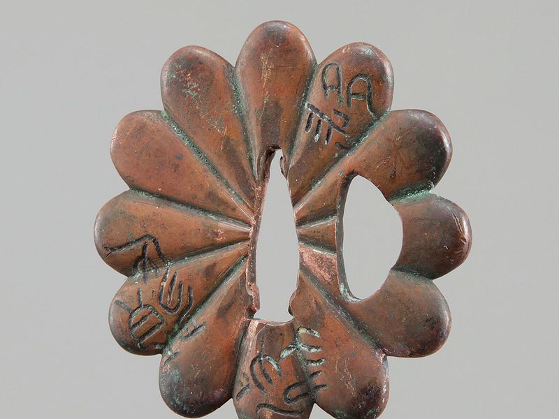

May I ask again why this tsuba needs any cleaning, waxing, manicure, detoxification, aroma therapy, or the like?
And btw, while an iron tsuba might benefit from the application of wax in certain instances, I don't advise using it on soft metals. And it also doesn't matter if you use a brush made from the hair of a virgin cut during a full moon.
Case in point: in 2006 I sold a papered shinchū Nara tsuba, and saw it again last year. The new owner felt the need to “clean” it. Judge for yourself, the one that left my hands to the left, the “improved” one to the right.

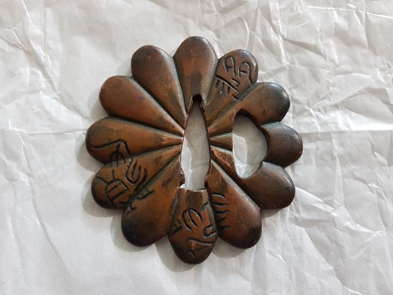

Hello, At the risk of being flamed to hell and back, below are two pictures of the same cheap Tsuba (one pic by me the other from a seller). the only real difference between the two pics are : untouched vs light brushing with wax as per Tetsugendo method
