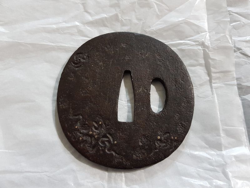

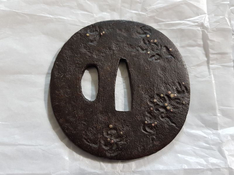

Hello all, I have this Tsuba which has dot inlays which are 'flattened' or near flush with the base metal. My question is a quick one and hopefully simple, are the inlays supposed to be like this (flat) or is this a product of time and wear and the inlays should be raised/domed?
Thank you for your time viewing

Fair enough Jean, what would be the tell tail signs this is not traditionally made? I am genuinely interested in finding out more as to why.
I know the Tsuba is in a somewhat rough condition and potentially has a non original coating on it. Is it perhaps because it is unsigned and in a Kaneie (spelling) style?

Thank you! It makes sense, but I did not know this
Stephen,
Research is great, but in this case is not applicable to your tsuba:  1-your tsuba is not a casting.   2- simple direct observation shows that the inlay on your tsuba did not start out flat.   3- Mauros' exemplars show TWO distinctly different types of inlay, the first one shows RAISED dot inlay, the second flat inlay of an unrelated pattern so the point of the comparison....simply leaves me scratching my head?

.....what would be the tell tail signs this is not traditionally made?.....I know the Tsuba is in a somewhat rough condition and potentially has a non original coating on it. Is it perhaps because it is unsigned and in a Kaneie (spelling) style?
Stephen,
the surface treatment with very coarse grinding marks is not a TSUBAKO technique, and the NAKAGO-ANA has a shape that reminds me of later 'tourist' TSUBA. The neighbouring surface of KOGAI HITSU also looks a bit strange to me.
KANEIE style is mostly related to a realistic scenery or landscape (e.g. SANSUI). In your TSUBA I do not see anything realistic but a random design.
But all that may be my old eyes and/or the fact that I am looking only at photos.
Thank you Jean, I understand and see what you mean regarding the nakago and hitsu shapes/ finishes.

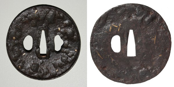

The only reason I mentioned Kaneie was because of the similar surface treatment to the 'shoreline' Tsuba as seen on the 'Tsuba Gallery' website by Elliot Long.
Im ok with it being an un-original, was part of a lot I picked up for lunch money a while back
Stephen,
I see no evidence of modern mechanical grinding on the surface of your tsuba.  Sometimes the simplest way to solve a riddle is common sense.  This is NOT the kind of thing that makes any sense to fake, certainly not with gold inlay ...not in the past....certainly  not now.  It is what it is,  a simple honest piece of no pretense, not new, not fake, not of great antiquity or value.  A lot of this quasi-early looking stuff was in vogue during the later two thirds of the 19th century, some of it was even made by informed amateur hands.
