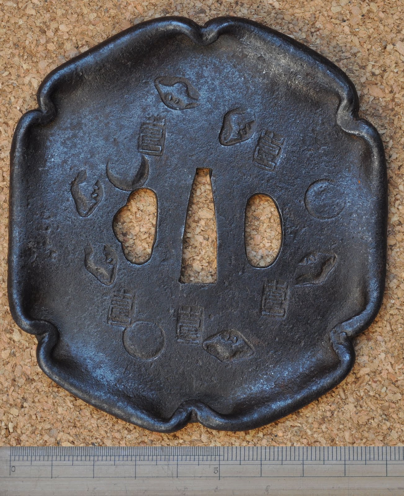

Hi All,
I've been dipping my toes into tosogu and have seen several pieces with a nice bat & moon theme. I quite like this theme and would like to learn more about it - is there a particular story behind it, symbology, etc.
I've also been looking for nice examples of it but so far have only found a few pieces. If anyone has any pictures to share of high quality tosogu featuring this theme I would very much appreciate it!

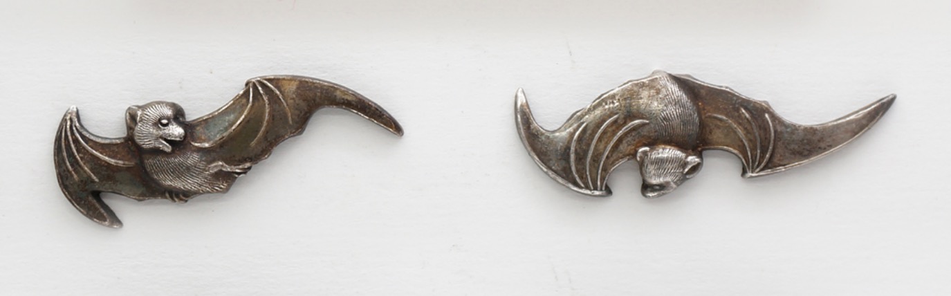

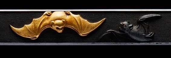

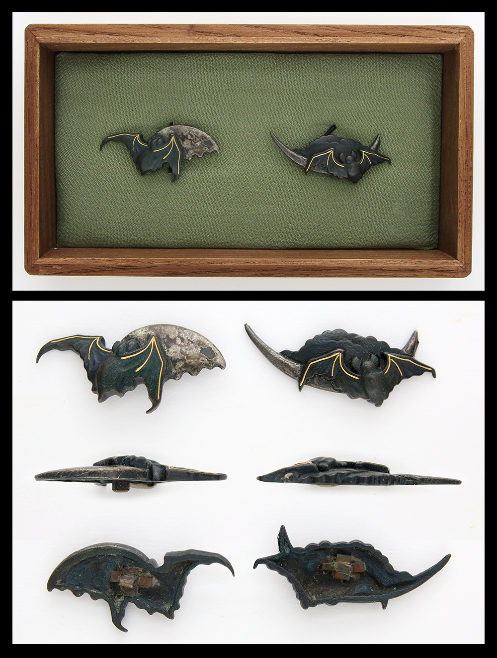

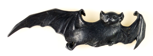

After posting earlier I dug a little bit further and found some more.

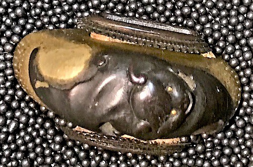

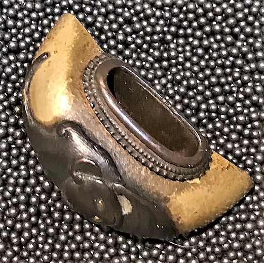

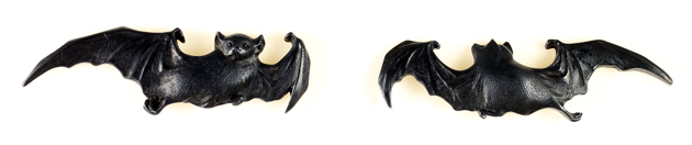

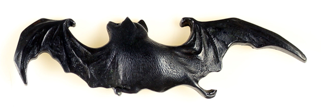

Menuki
Moon and the flying bat carved on Shakudo plate with gold and silver color - mumei
Bats in shakudo - mumei
Bats in silver or shibuichi - Noriyuki

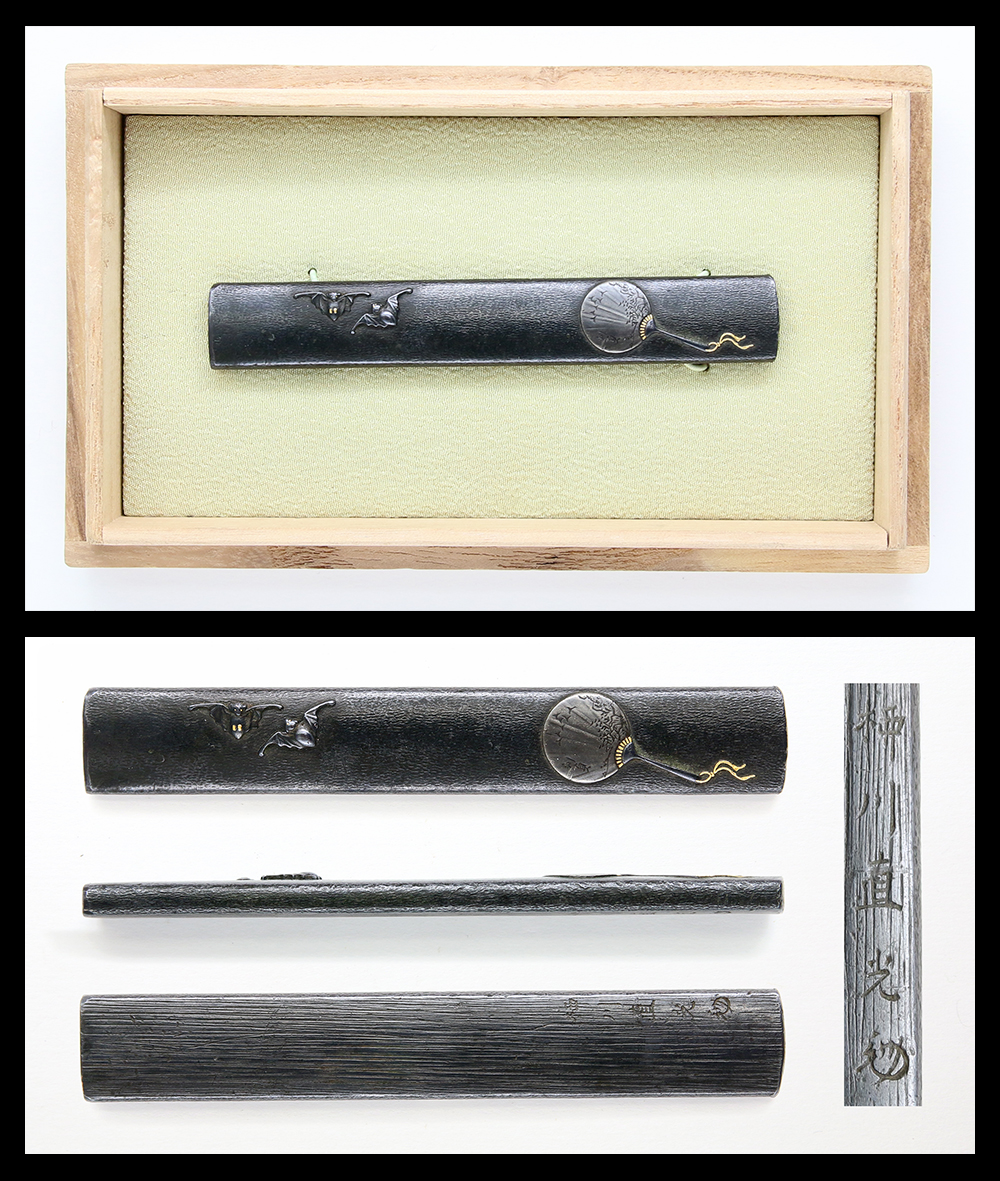

Kozuka
On Shakudo Shukumen-JI (wrinkle-Ji) plate, bat and fan is engraved and inlaid with gold - Yanagawa Naomitsu (Kao)

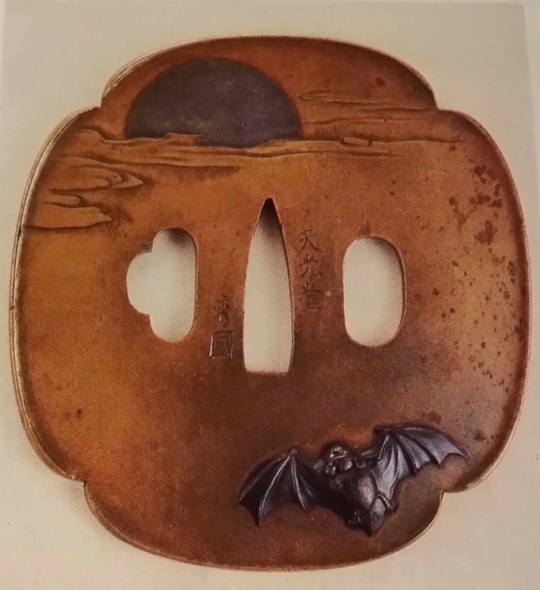

A few weeks back Darcy had a wonderful iron tsuba by  Goto Ichijo on his site. You can find the tsuba in
"Iron Tsuba -The works of the exhibition Kurogane no hana" page 123. Since I have not the right of use/
copyright I will not show a pic. But perhaps Darcy will show his photos.
Uwe G.

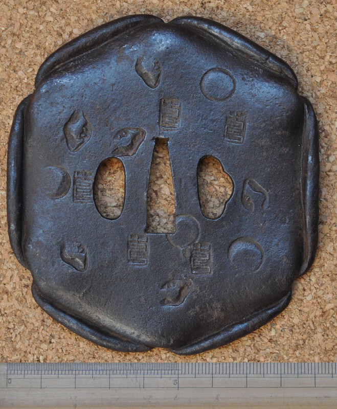

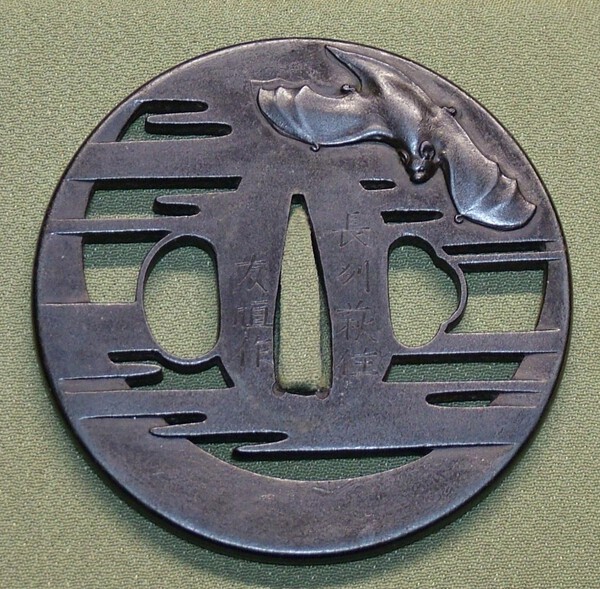

The Bat/Moon tsuba Axel posted above is signed, Inshu Ju Suruga Takaoki.  According to Haynes, he became ninth master of the Suruga family school in 1837.  His father Takashige, was made a retainer of the Matsudaira Daimyo in 1818. Nice Tsuba.
