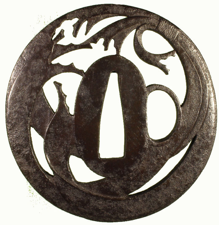

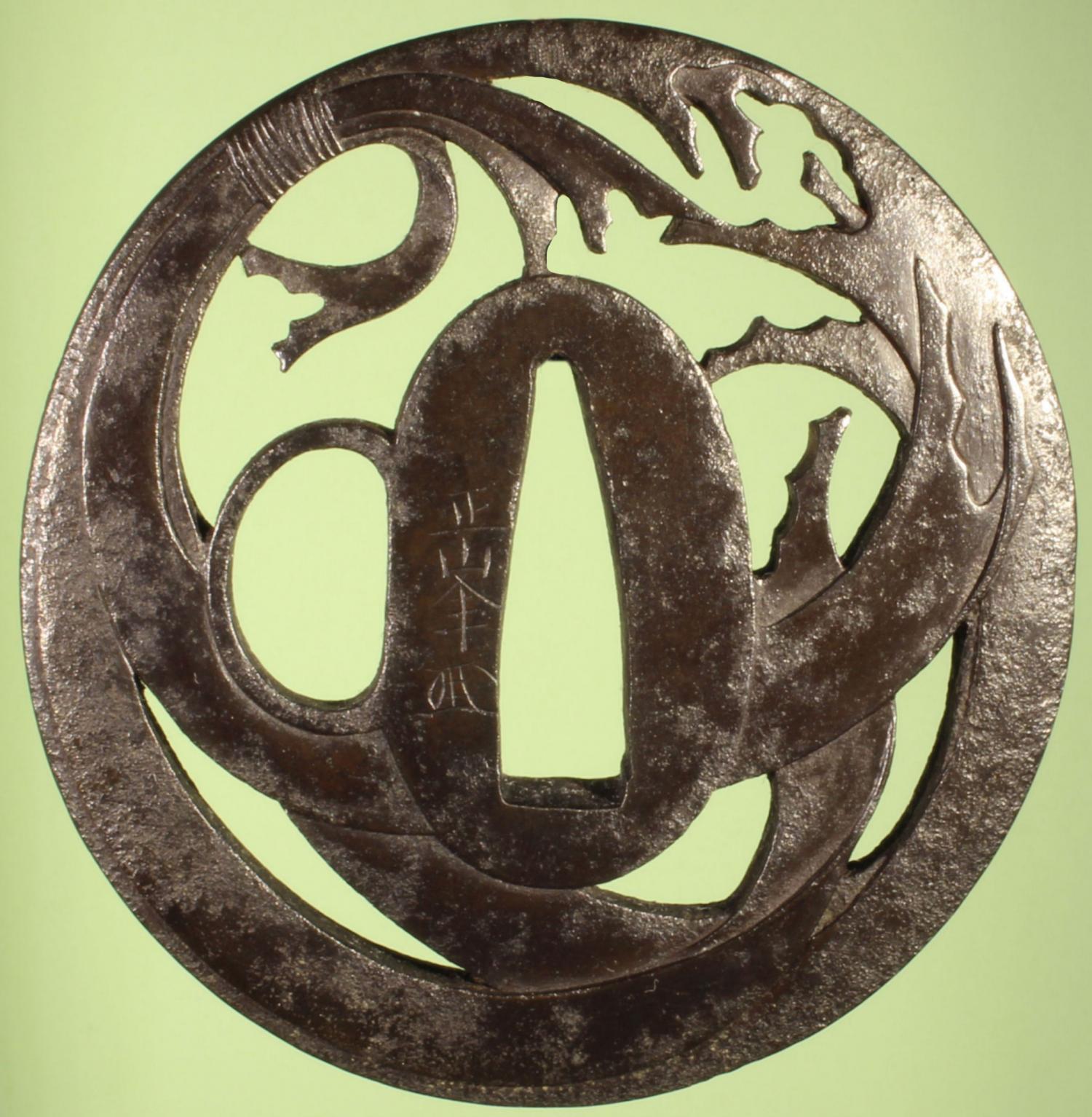

Is this likely to be from the Choshu school?
Would it be described as:
O-mikuji or noshi
Strips of paper used in temples, prayers and poems
Size = 71 x 69 x 5.2mm
Front and back images
Grev
Here is another tsuba design, described as "noshi". Looks similar, excepting of course yours look ripped and frayed. I don't know what the significance is.

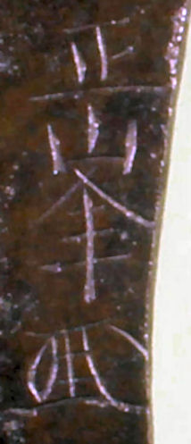

For the mei, I am leaning towards 正峯 (Masamine). The kanji for mine has two common forms: one with the mountain radical on the left (峰), and one with the mountain radical on top (峯). Yours, I think, is Masamine with the mountain radical on top, and this is probably the Chōshū Masamine mentioned in Wakayama on page 366. In the reference, Wakayama uses the mine with the radical on the left, but I don't think that has any significance here.
One of the things that makes me think this is mine, is the  crossed diagonal lines just under the mountain radical. I think these are a shorthand for the 久 that is written just after 山. Hope this makes sense.
