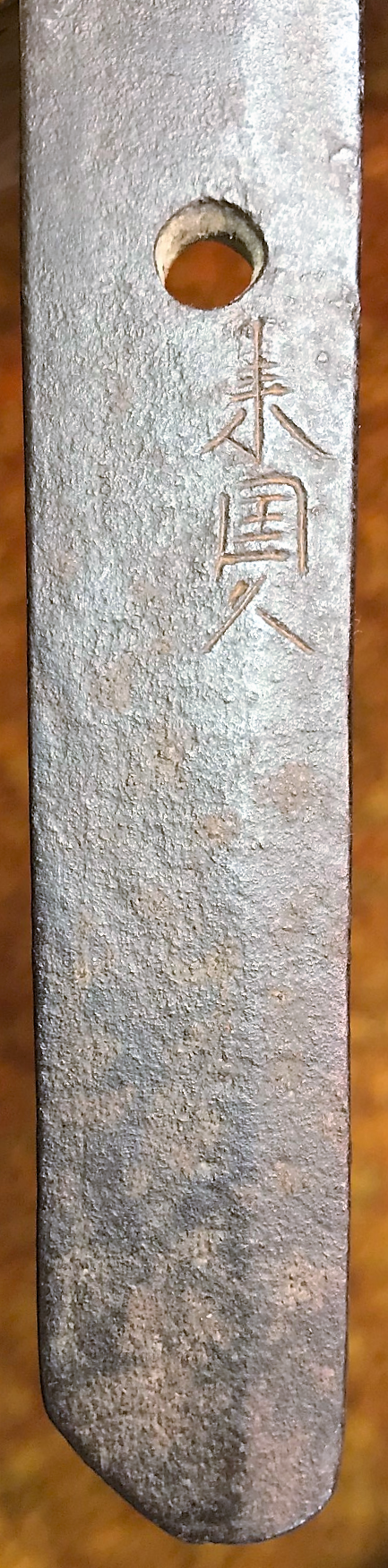

Studying a nicely made wakizashi today signed: RAI KUNIHISA. Based on the nakago and its shape ha-aguri and the hamon which "resembles" Bizen, but is not, I believe this could be one of the Rai Kunihisa from Bungo province, sue-koto? I can not locate an example the mei for any of these guys. Book Bungo Swords (indexed by Sesko) didn't show anything. Does anyone know where an example of mei can be found? If from Bungo, he is not a big smith so maybe nothing exists other than listing the three Bungo smiths. Worth asking. Thanks,  Ron STL

You always come up with interesting challenges and expert observations.But...
Frankly I am just always  suspicious of swords signed "Rai Kunianyhting" and this nakago doesn't show me a lot of character.  If you can go beyond that, why are you looking at Bungo rather then one of the Yamashiro guys who actually did sign "Rai Kunihisa"? KUN 272ff How much masame is there?

As Peter said, seeing any mei starting off with Rai needs to be closely looked at. My very first "antique" sword was signed "Rai Kunimitsu" and immediately made my novice mind thing missing NT...it was not, by any strech of the imajination.  :( This wakizashi we looked at yesterday is definitely not Yamashiro and has nothing (especially the sword's sugata) that would push it back that old. The quality of the forging is simply not of Yamashiro (Awataguchi, Ryokai) quality. Hawley lists over a page of Kunihisa, a few being from Yamashiro, but you will see three listings from Bungo, sue-koto era and only one of those, I think, noted a date-period. This made me look into the book on Bungo swords, but nothing was found on a Rai Kunihisa. I haven't had time to look in the Meikan. The sword is nice, with some thickness to it and a fairly deep sori. The nakago with it's shape and ha-agiri made me think Bungo was a good opinion on the blade. I'll attach a couple random pages from the book. The sword is not anything to get too excited about, but I just found it interesting (and an opportunity to dig into the books) to try and pin the smith down. Retirement entertainment? Talking to Howard Sloan today, he says the sword did have masame hada approaching the shinogi. The sword may also be showing utsuri, but  the condition of the polish always makes me question what "appears" to be there.
