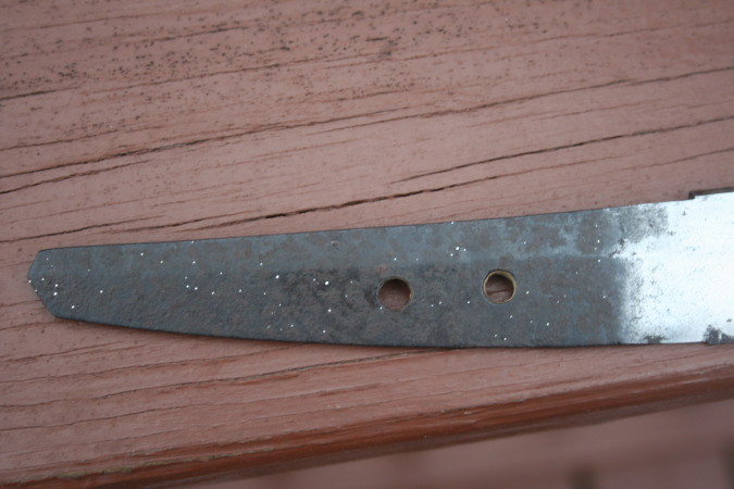

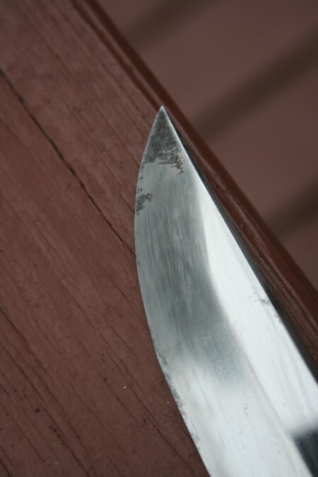

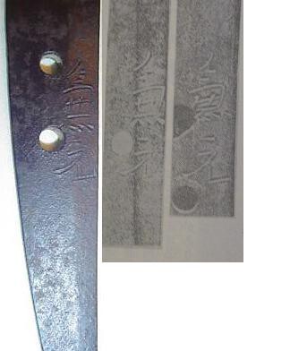

Hi James, this is my opinion only, based on small research I made on mino Kanemoto as well as on Nihonto Koza vol. 3. I don't think that your sword is by second kanemoto, the boshi don't look correct to Magoroku (should be midarekomi with a hint of jizo), also the hamon looks a bit to organize comparing Magoroku, the mei is difficult to see, though I don't think it fits exactly. I think the right side of the moto kanji is a bit shorter and the kane kanji don't look the same as Magoroku. I hope I am wrong ;) Mike
James,

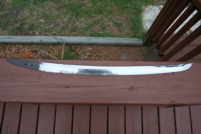

I won't say anything about hamon because of poor pictures provided.
Mei : kanji don't match with examples provided
Nakago : Were it not for the fuzzy overall picture of the blade and koshirae, I would have sworn that the makago had a soshu flavour from the other pictures.
Nakago : Compare your examples to the pictures, the one in the picture is very curved on the ha side. Mekugi ana are not aligned in the same manner as in your example

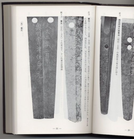

I've just acquired a Toko Taikan and looked up the Nidai there (page 136).
Have a look at the following comparison. It looks pretty good to me, especially the first example.

here's a scan from the Yoran, looks close to me. id have the shinsa team look at it and if they say good, that'd be great, if bad get another opinion as they are known for making a few head shakers.

True, but not always, as these oshigatas show; Nagayama's book gives only general points.

Here are a few more photos...sorry they're not higher quality. If anyone has requests for particular views that might help in making an educated guess as to which kanemoto (if not Magaroku, then which generation...?) let me know and I'll try to get them.
Hello,

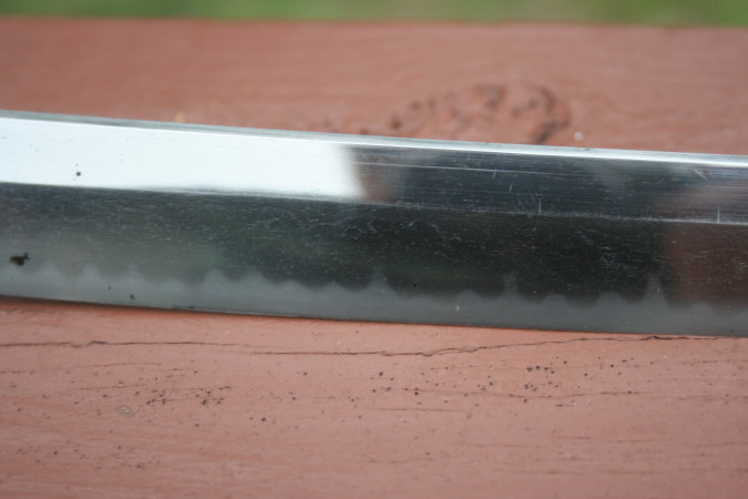

If i'm not mistaking the hamon to me looks very regular.
This sanbonsugi hamon was according to the Japanese experts invented by Magoroku Kanemoto (nidai)
But his hamon is not as regular as on this particular sword.
So in my humbl opinion this sword is made by one of the later generation Kanemoto
Greetings jos
Hawley's lists some 20 Mino based smiths using the name Kanemoto from Koto through Shito times. Since the sanbonsuji hamon is so regular on this blade, if it's by Kanemoto at all it has to be one of the much later smiths using that name. Unfortunately many of those later smiths are not well documented, so finding examples of genuine mei from the later generations may be rather difficult. Then too, the blade could have been made by any number of Mino smiths working in the style of Kanemoto and either adding a gimei signature or leaving the blade mumei with some later sword dealer "improving" the blade by adding a false signature.
Ed Harbulak
Thanks to everyone for the input. When I purchased this sword, I bought it for the fact that it was a reasonably priced, signed, and healthy wakizashi...I've not yet bought an unpapered blade based on the mei.
That said, I still think this one has a shot at being the nidai...the boshi is spot-on for the one Kanemoto is most well known for, the hada seems right, the mei is at least close (any additional comment being welcome) and the hamon is also at least close. It is my understanding that Magoroku's sanbon-sugi evolved during his career, but is generally irregular, and the "points" of the hamon are generally more rounded than later generations. I would expect to see, on a late generation kanemoto sanbon-sugi, a "regular 'two short and one tall' hamon"...this one is pretty well controlled, but does seem to fit the bill as irregular in that, in the large part of the hamon, there doesn't seem to be a strict adherence to this pattern. I'll see if I can take another pic or two to show some of the more "irregular" areas of the hamon and post them tonight...
Thanks again for all of the input, and I hope for more.
In the end, as is so often stated here, "Only shinsa will decide". 8)
I don't think the hamon rules out the nidai Kanemoto. The later generation Kanemoto smiths when they made regular sanbonsugi, it was like it was coming out of a machine, like the notches on a ginsu knife.
Nidai Kanemoto did make them more irregular than this at times so that you have to almost search to find sanbonsugi.
So I think that overall it could be second or third generation just looking at the hamon. I haven't checked the mei.

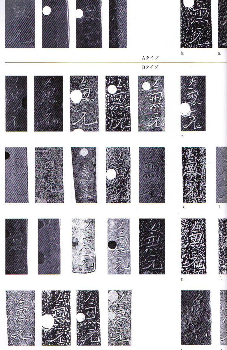

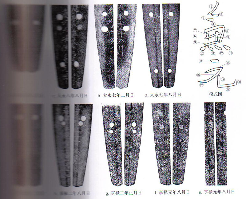

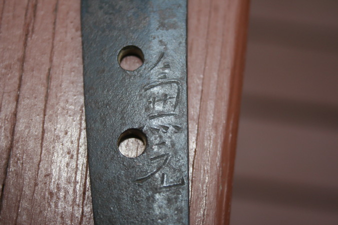

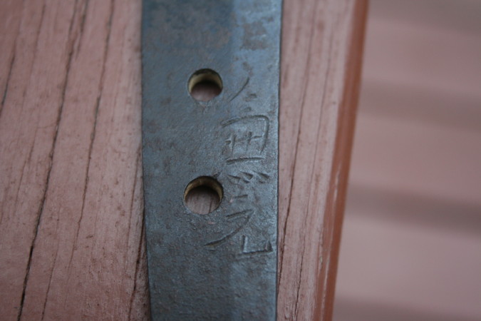

Sorry for my absence, but I've been away "enjoying an extended Mesopotamian vacation" and now I'm back and still scratching my head about this wakizashi. Pg 110, vol III of the Koza states that there are "special traits" in the third and fourth stroke of the ji for MOTO. I have been staring at my blade and all of the oshigata I can find, and it seems to match for the Nidai Kanemoto/shodai "Magoroku". What I need at this point is a few sets of fresh eyes to evaluate the mei, since I am afraid of falling into the familiar trap of seeing what I want to see. :roll:
"Digital Kantei" is difficult, as everyone knows, especially when the photographer's skills are lacking (as mine are), AND the blade is in relatively poor polish (which mine is). What I think we can do adequately with photos, however, is evaluate mei, so that is what I hope to do.
Well James, I can't argue with your assessment! :D
However, I don't believe I'll have the opportunity to travel to a sword show or shinsa before my next "extended vacation", and don't really want to send it through someone else. Just looking for opinions here regarding the mei.
