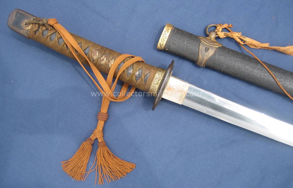

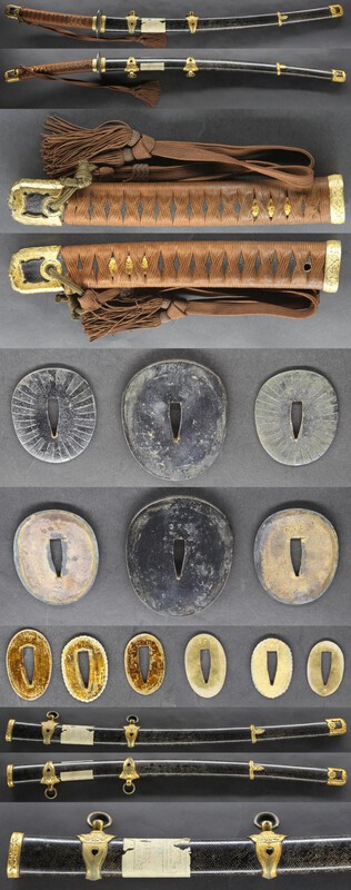

Is anyone aware of why some silk Sarute on Kai Gunto were so long? I've noticed a few examples with these extended Sarute but can't rightly understand why they are so long, it places the tassel in a fairly awkward position. Could it be related to the long, thin silk retention cord sometimes found on Kai Gunto? As you can see in the picture it's nearly 3x the length of a normal silk Sarute.

The join is usually hidden within the kabuto-gane.

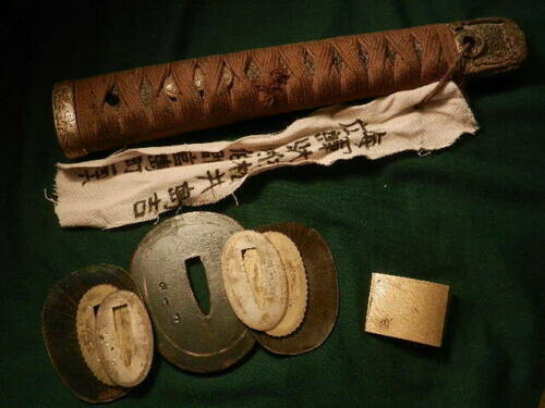

Dave, I've seen this with IJA gunto, but have never owned a Kai with the fabric sarute. Are they anchored inside the same way? If so, I agree with all the above comments. This long one is knotted. I doubt the factory assembly would have knotted a sarute like that.
Hi John, I still believe tied sarutes are replacements, even probably replaced/tied during war time as a repair. But not as originally issued.
Of the dozens of original examples I have, Kai Gunto and Shin Gunto, the colour of the sarute cord is a close or even perfect match in colour to the handle wrap.

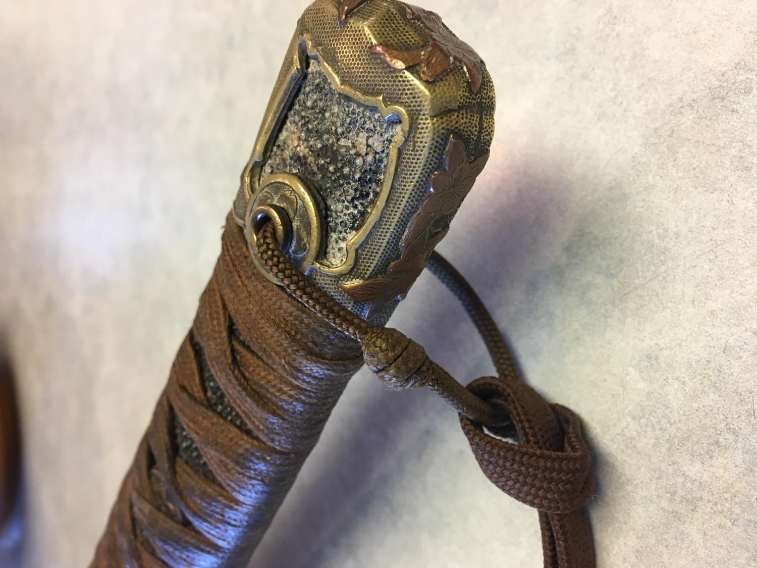

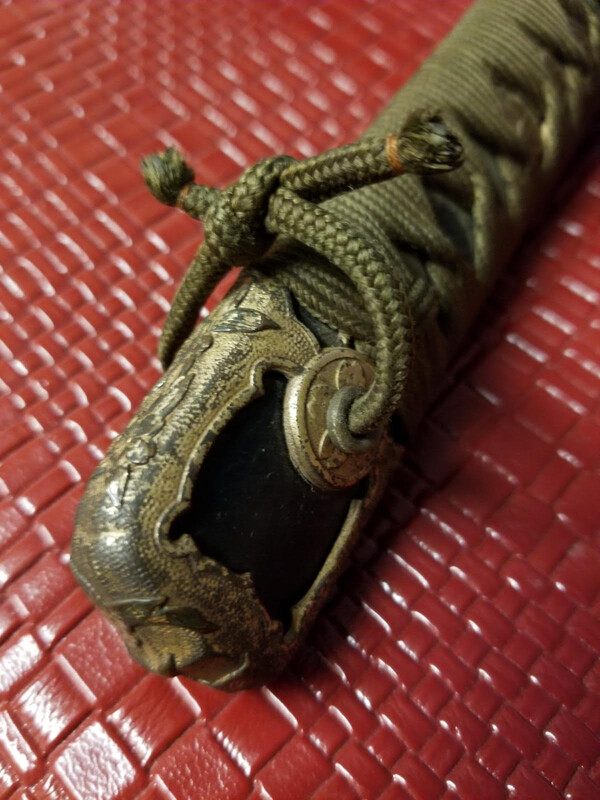

The seller of that Kai-Gunto in John's earlier post accepted my offer, and it arrived today. Takayama Forge made blade by Hattori Masahiro.(I think the seller made a post here last year to get the translation.)
All the koshirae, including the handle and scabbard, are numbered and matching (#19).  So it seems completly original. I took a couple photos of the cord sarute. It's a single piece, not joined inside the handle. The color matches the handle wrapping.
One little detail I didn't notice until I had it in hand is that each of the cord ends are each tied off with a very small thread, probably to prevent fraying. It seems like rather delicate work. Again, it makes me wonder if at least some of these Naval cord sarutes were an option when originally purchasing the sword?
Anyway, some pics...

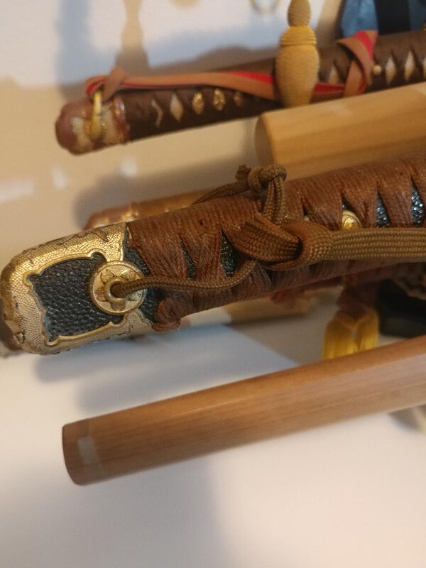

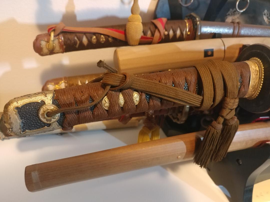

Geez! I had one of these and didn't realize it until today as I was doing some work on this one! It's on a '43 Sukekuni, Seki stamped Kaigunto. The knot is very well tied with the ends secured inside the knot.
After seeing the differing methods of knot tieing, it makes me wonder if they are done in the field by the owners, or was there simply no set standard at the factories for tieing the knots?post-3487-0-21068500-1550419337_thumb.jpeg
