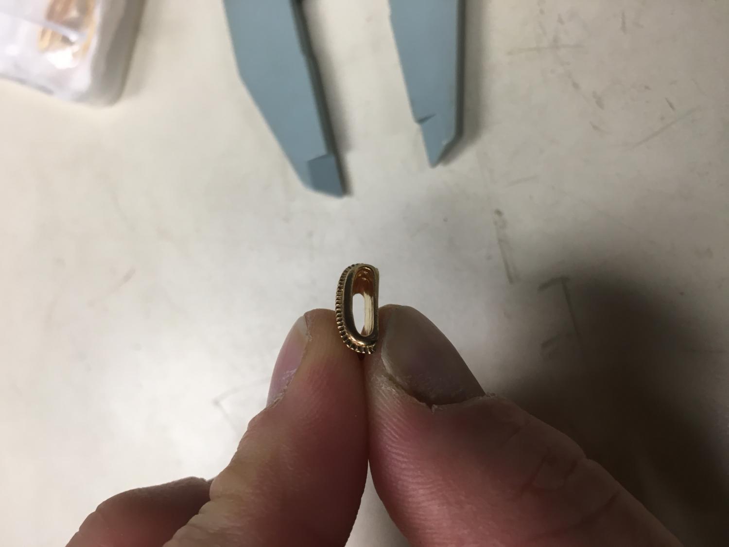

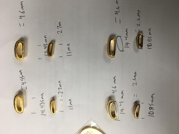

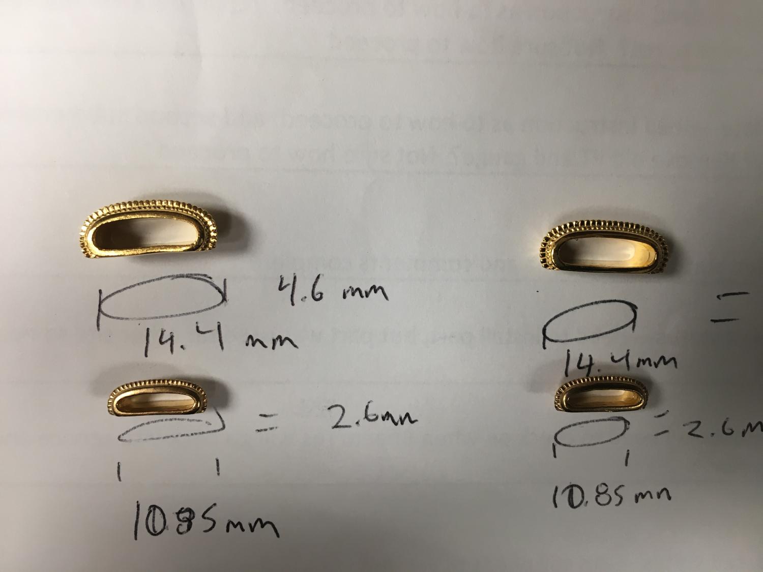

Mr. Hallam San turned me on to this place (Namikawa Heibei) for sourcing urushi (I think), but I purchased shitodome and was so happy with the product that I wanted to share with you all. I purchased both quality offerings they had (reg and top quality), for both kashira and kurigata. While I was asked not to discuss the price (Japanese can be so considerate of others, possibly resellers, is all), I was told that they would be happy for me to discuss the quality. The fisrt thing was that the ?barrel? sizes are all almost perfectly matched, and there were no rough spots on the inner surface to wear the silk. The top quality ones are silver base. the kashira Shitodome all fit almost perfectly in the old kashira I am working with. The top quality kurigata ones are built to have a slight taper, as to fit nicely flat to the kurigata. The ordering is via email or fax, and they accept PayPal. They had the parts to me within a week of ordering, also ridiculously fast. I ordered (2) 100gr tubes urushi, a susudake piece that was much larger than I expected (for the price - I’m tiptoeing here), a top quality seppa (not thrilled but nice enough, should make my own with these), and the Shitodome; shipping was 2000 yen. They mostly are sellers of sword polishing equipment (don’t worry, no plans going there), and have been in operation for over 150 years. They will send pictures via email and did for me without me asking.
