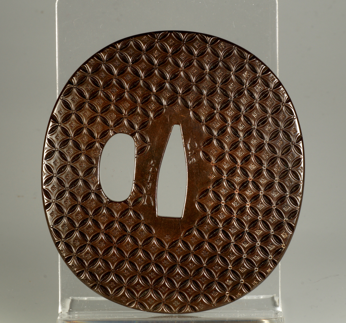

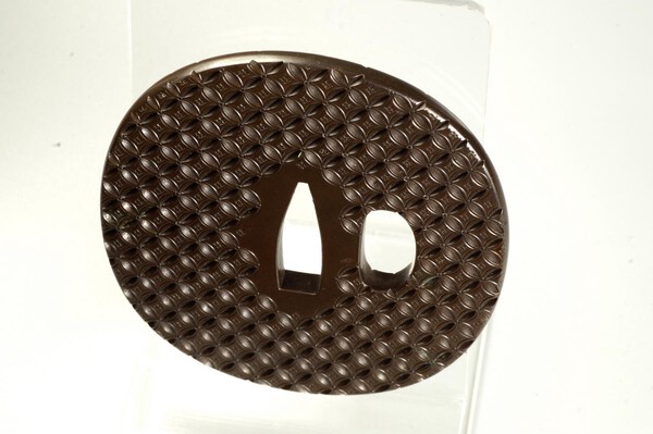

The good thing about finding a signature of a minor artist on a piece of kodugu is that it is probably genuine.  As the fame of the artist increases, so do the number of copies, fakes, homages and utsushi.  I have a few iron Nobuie and Kaneie tsuba with passable signatures, but look as if they were made yesterday!  The tsuba that I am presenting today for comment is from a bag of 19 loose tsuba, one of about 100 items that represented the remnants of the stock of the a Cape Town Oriental art dealer who died about 30 years ago.  The items had remained in boxes until a recent auction.
 This oval shibuichi tsuba is decorated with a shippo (七, literally seven treasures) design, and referred to as a shippo tsunagi (shippo chain) when the inner and outer circles are interlinked, as this example.  The symbol is found in ancient Egypt as well as Asia and is at least 3,500 years old and embodies a wish for family happiness and financial success.  The design is finely cut with smooth even lines with the major open areas between the circles all cut to the same depth.  The evenness of the cutting is so skilful that it looks as if the pattern were made by a machine, rather than by hand.  The tsuba has a single kodzuka hitsu and both the size and overall design indicates that it was made for a wakizashi rather than a katana.  There appears to be some wear on the seppa dai, but the nagako ana looks pristine as this tsuba was probably tailor made for the sword and thus did not require seki gane or punch closure of the nagako ana to obtain a precise fit.

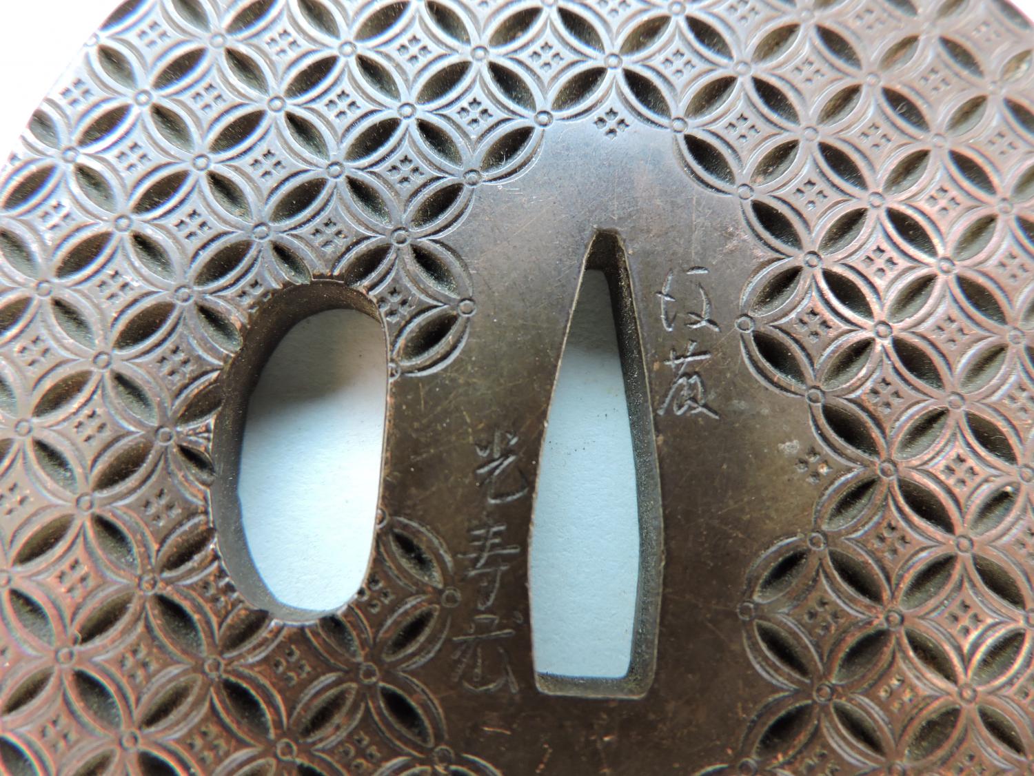

The tsuba bears the signature of Goto Mitsunobu/Mitsutoshi (後藤光寿) with a kakihan. According to some web pages, Fukushi reads the signature as Mitsunobu and the Toso Kodogu Koza says that although the kanji are commonly read as Mitsutoshi, Goto documents list the artist as Mitsunobu, with furigana reading aides by his name.   As the Goto family read his name as Mitsunobu, it would seem that Mitsutoshi may be a modern mistake which has been repeated enough as to cause confusion.
 Goto Mitsunobu was possibly the third son of Senjo and adopted by Renjo (10th generation master of Goto Shirobei line of family) after the death of Renjo’s son, Mitsuyoshi, aged 25.  Mitsunobu married Renjo’s daughter (probably a good career move) and became head of the Goto school aged 34.  Mitsunobu became Tsujo (11th generation master, 1663-1721) and lived in Edo.

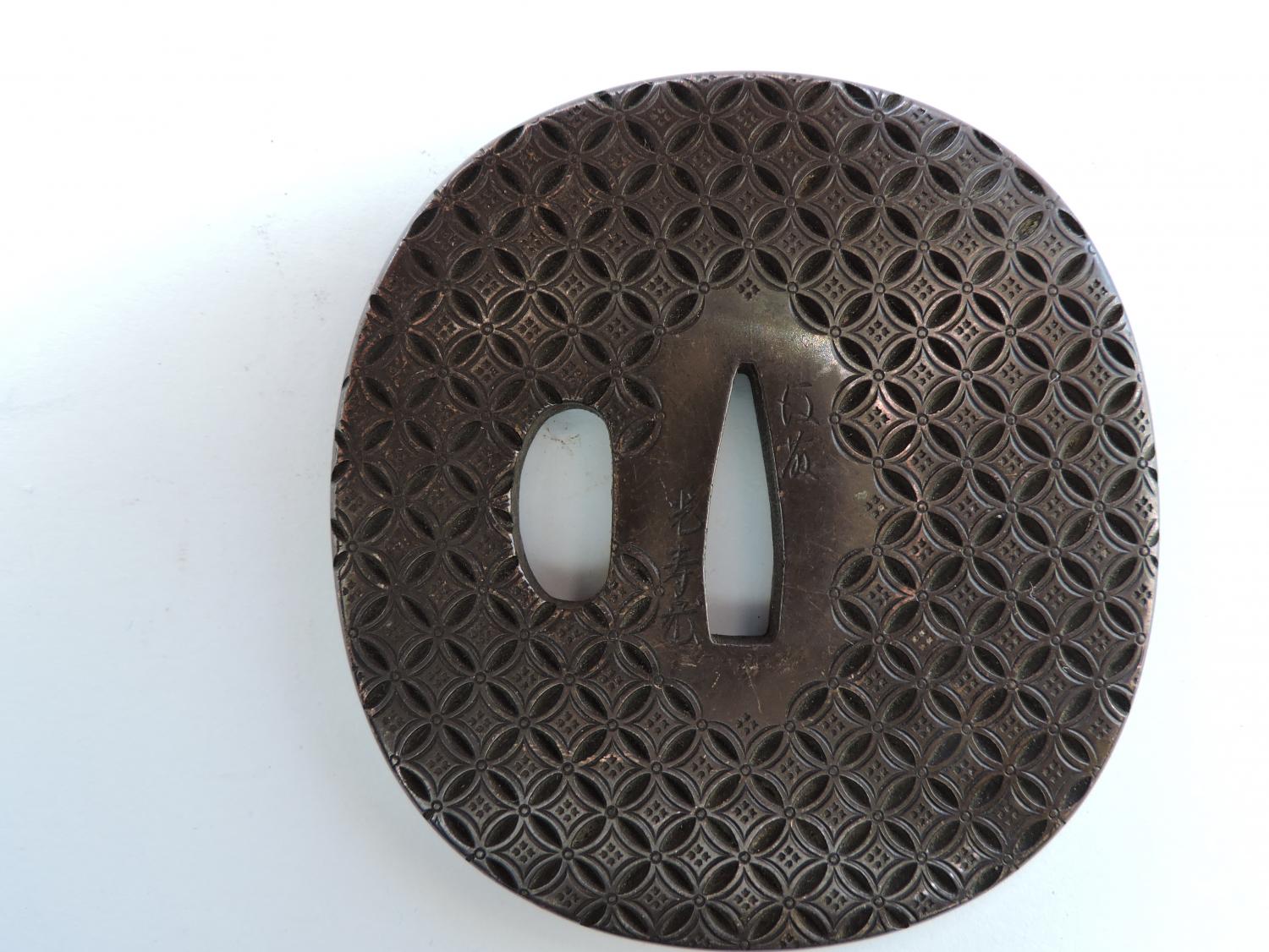

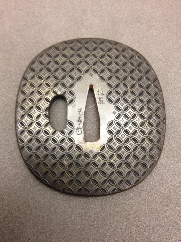

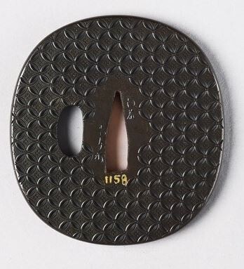

The Ashmolean Museum in Oxford has a virtually identical tsuba to this in the AH Church Collection (Accession number EAX. 10899 with collectors number 1158, see pic).  Some of the detail (especially the signature) is difficult to see in the Church example, but the distribution of the circles is the same, as is the placing of the signature.  Only the karahana (four pettalled flowers in the centre of the circles) look slightly different, and are more like four dots in my example (a different punch was evidently used).  As far as can be seen from the Church collection photo, the kakihan appears the same, but the rest of the signature lacks clarity for a critical comparison.  However, the signature on the tsuba in the Church collection is probably misread and is listed as being signed by Goto Mitsunaga.  It is also stated as probably not by Tsujo, the XIth master.

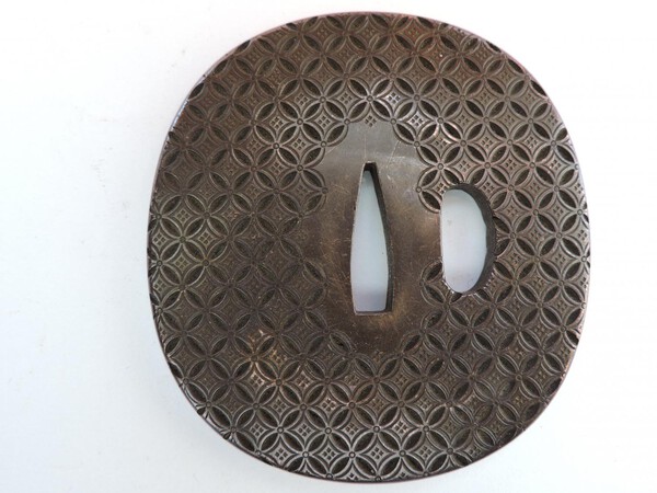

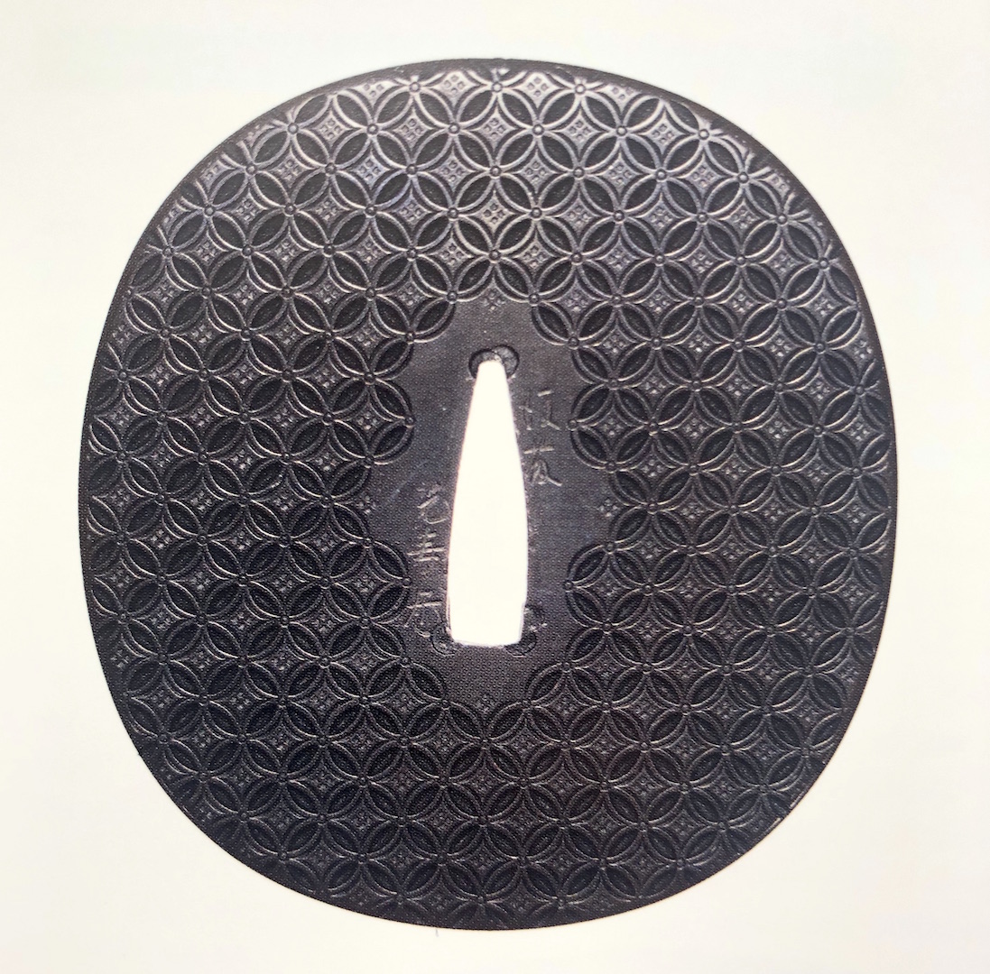

The Boston Museum of Fine Arts has another identical example (accession number: 11.5433) signed ‘Goto Mitsutoshi’ (see pic).  This has the same karahana, as the Church example, and the two look as if they could have been turned out together from a 3-D printer. The ‘Toshi/Nobu’ kanji differs from mine in that it appears stiffer and the lower half has a square rather than a single stroke.
The three tsuba are so similar that I would say that they came from the same workshop and perhaps from the same hand (though probably not Tsujo’s).  One source reports that 24 items by Tsujo have passed Juyo, so I suspect that there are more utsushi extant than genuine works.  The difference in the second kanji of his name is interesting.  Perhaps Tsujo was called Mitsutoshi and Mitsunobu, slightly changing the kanji when he changed his name.  Unlikely, but I like to think outside the box.
Whether genuine or fake I think that it is a skilfully made tsuba and I wish to treat it with care.  Close examination of the piercings reveals some dirt and crud.  What is the best way to remove this without affecting the patina?  Washing with a water based detergent, spraying with an aerosol electrical contact cleaner (alcohol based, no chlorinated material), or soak in white spirit to remove grease?
Dimensions: Height: 7.05 cm, Width: 6.65 cm, Thickness (rim):  0.35 cm
Thanks in advance for any help.

Thanks Kyle,
Your photo of the Asmolean tsuba is much better than their on-line version.  I would say that the signature and kakihan are identical to mine, as is everything else about the two tsuba.  So they were probably made in the same workshop, by the same hand, though probably not Goto Renjo.
