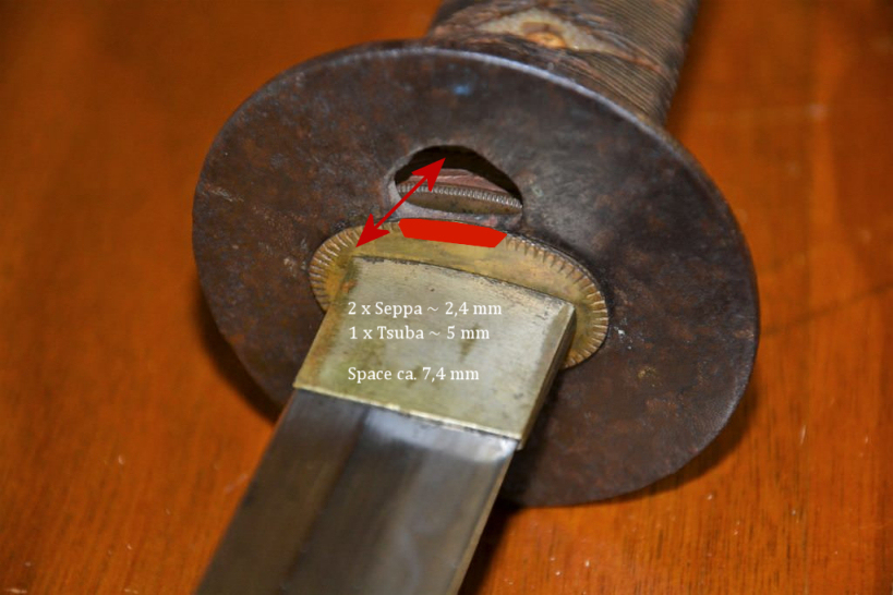

Didier on this picture is see 3 Seppa in the fittings. Some one has put a nice NCO Tassel on it.
I would say that the blade was fitted as Type 98 Gunto. The Seppa are to different to each other. Take it as it is.
Chris, there are indeed three seppa in all, and I must say that I have suspected the shiny one to be a replacement or a later addition.
I have taken for granted that the NCO tassel was a copy : it looks brand new.
