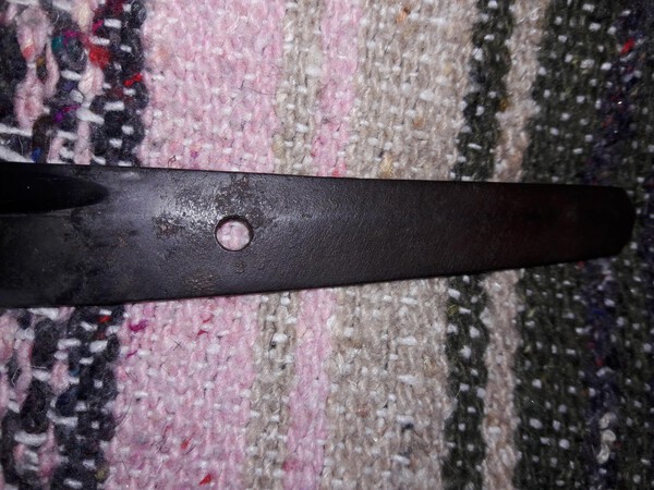

Recent Find Edo Wakizashi
Blazeaglory
Mumei Wakizashi Blade with Hi. Late Shinto or Shin-Shinto.
Hmm. I was thinking early or mid Shinto. But its definitely Shinto.
Also, is Hi aftermarket or original? Its quite well done but Ive never seen one end so abruptly (high up on Nakago) without being rounded. Usually this type of Hi runs the length of the Nakago no?
Ill post a full pic after others opinions. If there are others that is lol
"Mumei", bold call Chris.
"Hi after market or original", Nakamura suggest all hi are ato bori in the sense that they are added after the sword is otherwise made.  How would you expect to tell from one limited image?
"Never seen one end so abruptly",  quite common, check this out, https://www.aoijapan.com/wakizashikanenori/
Sugata gets you to age much more than nakago condition and again, one limited image.
Hope that helps.

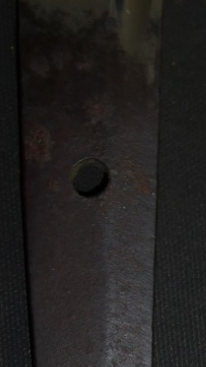

Impossible to say if the blade is mumei or not because it is the opposite side of the mei (if there is one or not) which is pictured.
Now, we can say it is mumei, otherwise Dwain won’t have posted it for information.
Impossible to date it from this picture.
Now even dating a shinto from shinshinto wakizashi from sugata can be very tricky....
What does this say to you? Era? Den? Im not asking for a full report but lets see what ya got!
Errr, struggling here Dwain. Best I can do is speculate about the nakago-ana being enlarged at a later date.
Maybe you could narrow it down a LITTLE by looking at the shape of the nakago, file marks. Have fun.
I am posting this just to draw the attention on the yasurime and the danger on dating a blade by them.
This is an Eikyo Bizen wakizashi. Look at the ura side, forget the date and the kiritsuke mei. Concentrate on the yasurime. They look fresh and could be shinshinto, the blade is koto.
https://www.aoijapan.com/wakizashi-bizen-osafune-norimitsueiroku-4-nen-2-gatsu-hi-kiritsuke-mei/
To sum up, nothing can be kanteied from this nakago.:(
Hope that helps.
Hello Geraint and thanks for the response!
The image you link to has longer hi and is what I referred to as in the post above as "runs the length" but I guess I should have been more specific. The blade in OP ends under hibaki. Linked sword in your post, the hi ends halfway down nakago.
So it seems in Kantei the little things matter? But not in case of different length bohi? I think that's what I was truly wondering.
I understand that all hi are technically added after the sword is made, that makes good sense. What I was asking is if it was added by the actual original smith or at a later date by another? But i think that might be impossible to tell?

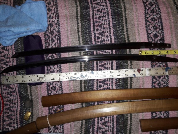

Yah I know I was just trying to have some fun with it to see what kind of answers we'd get.
When I get the blade in hand I'll take better pics and post them here.
And thanks everyone for playing along. Good conversations come out of little things!

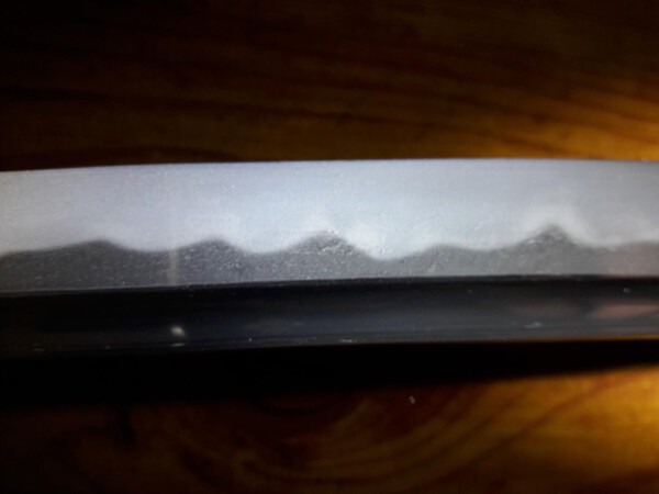

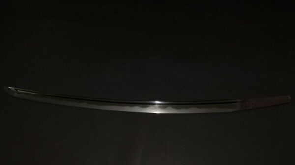

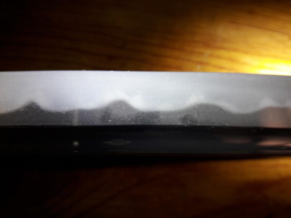

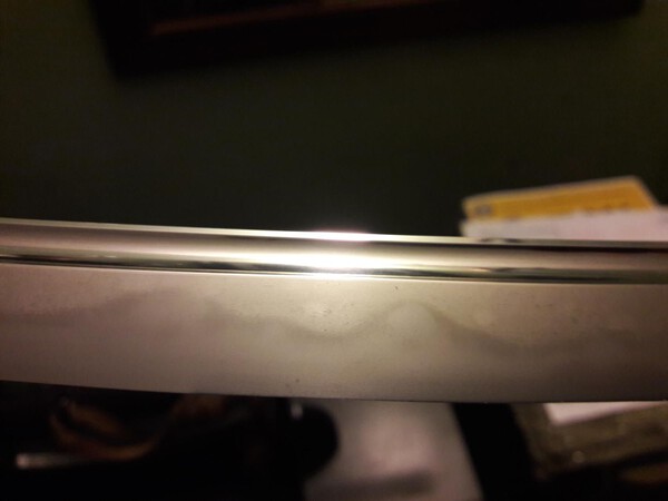

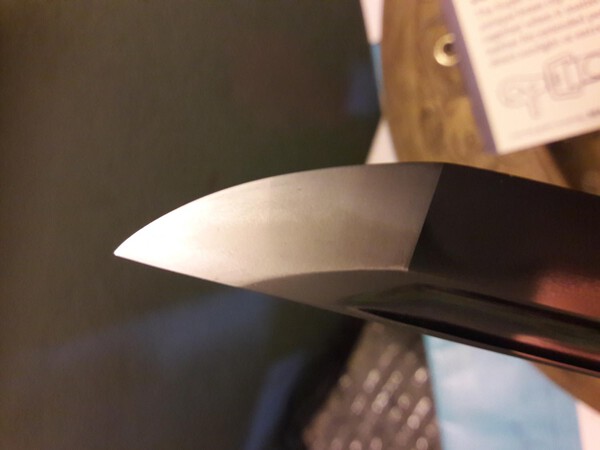

Sorry If Im offending anyone, but you think this could belong to the Kagemitsu school? Or you think this particular blade is too "young"??
Looks to be made in the Bizen (or similar influence?) style as some have said. I'm incline to agree but mention Shitahara school as a candidate. Also, as Jean said, dating from the nakago alone is tough because for me as a rookie, sometimes It looks "newer" (meaning early/mid Edo) but yet for some reason appears to possibly look older due to little things such as a possibly chiseled nakago-ana or the different stages of patina/pitting and looks in different light/angles.
Anyways, I appreciate the info. Ill give it a rest now. Im just bored and excited and thought Id post some better pics with better light for everyone. Thanks all.
EDIT: The more i look at the Hamon of this blade, it starting to resemble yamashiro and Soshu tradition IMO, possibly trying to emulate their founders work? But boshi constantly brings me back to Kotetsu (Kotetsu hamon is quite similar too). Also, as Jean said, dating from the nakago alone is tough because for me as a rookie, sometimes It looks "newer" (meaning early/mid Edo) but yet for some reason appears to possibly look older due to little things such as a possibly chiseled nakago-ana or the different stages of patina/pitting and looks in different light/angles.
Oops tried to edit and accidentally qouted????
The edit is noted above plus I was going to add these pics for posterity????????
(Thanks to Mark Seskos Kantei eReference for comparison)
