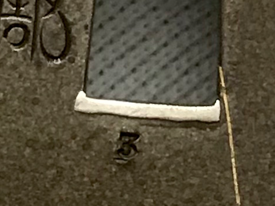

Please advise if any of you has ever came across tsuba stamped with some numbers under nakago-ana?
Looks like a museum number. Probably an American museum, that made a sale of part of its collection? Just a pure guess from my netsuke background - I recall one such a sale of netsuke in US.
I notice that too on some tsuba. I avoided buying but now i belive that these tsuba made on series. They are mostley artisan work. Late Edo/Meji. I dont know why they are stamped. But i would buy them now, because they are good work and not repro or something like that.

Hi Peter, that's interesting!
As for mine - 2 came from Europe, 1 - from US, 1 - from Japan. Enigma! Had to be quite a big collection - at least 363 kinko tsuba!
Update: obviously not only kinko but tetsu as well.
The number font is very old,
the metal around it seems moved,
but the patina looks correct.
My curiosity just went to 11.
Yes, this is one heck of an Enigma.

Pete, it was an interesting reading! I was sure not to be the first one to ask this question.
I was thinking about huge collections. Behrens? Naunton? Needs further investigation.
