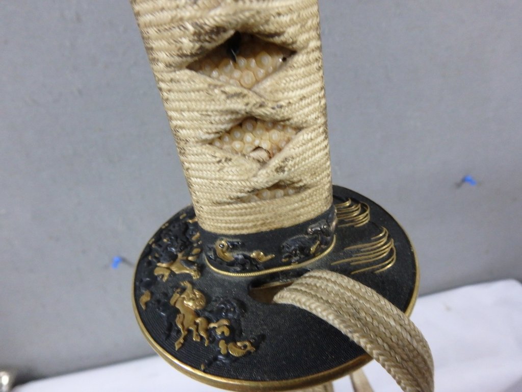

This sword just sold on ebay for $5400 or so.  Sorry I underbid because the tsuba and fuchi-kashira were made by a student of Goto Ichijo.  It looked like a little TLC would turn it into a sweet setup.  Did a NMB member end up with it?  Congratulations if so!
Congratulations Ian.  The tsuba and fuchi kashira are absolutely good, and the work looks very nice.  I was planning to bid $6600 but softened it up, feeling a little strapped lately with weddings happening and such.  Here is a page from the kinko meikan.  Sorry I didn't rotate the photos from the listing.  Anyway, I think that it will clean up really well.  I was wondering if a little acetone might take the grease out of the ito but would test to be sure it doesn't take color out as well.  Cheers, Bob

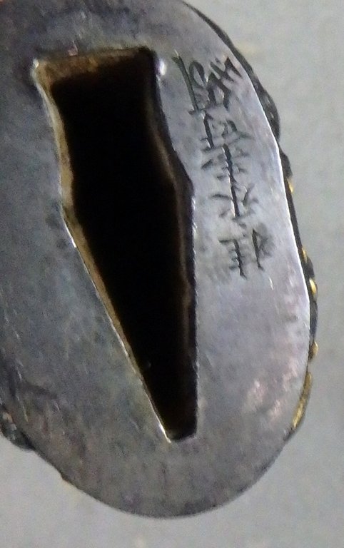

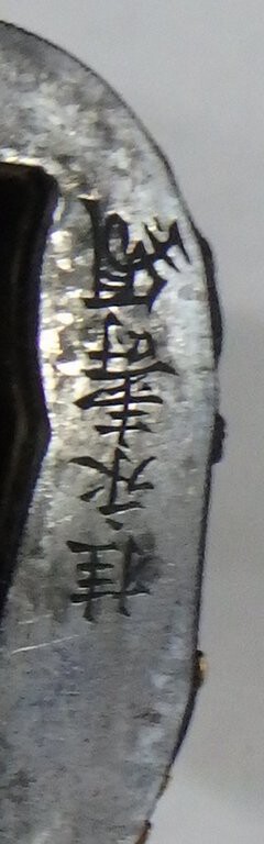

Robert - as Ian pointed out this is by Katsura Eiju who founded the Katsura School but who was not a student of Goto Ichijo as he pre-dated him.  You can find a good write up in Sesko's, 'The Japanese Toso Kinko Schools' on page 240.  He was apparently a student of Yokoya Terukiyo and possibly the second Soyo (there is some debate on this but it is totally possible).
