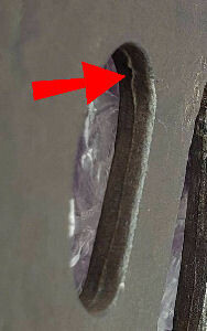

Hi Stephen. There are one place I'm sure and another I can't tell if any of the inlay has been lost, see photo. Are you referring to something else?
As for the material it is difficult to pin down if it looks more bronze or gold to my eyes. Skakudo is the gold and copper alloy right? The inlay has a almost a organic autumn leaf color if that helps? Love how it looks in natural sunlight.
I'm out of town til around Halloween then I'll be able to put up photos not quite this bad, these are all from the ebay auction.
At 1 even my untrained eyes can tell a tip of grass is gone.
At 2 I'm not sure if something is gone that was attached, the round metal encircled does not look like a fresh break point, maybe just the shape of the big leaf's left top is putting me off.
At 3 I think a flower is somewhat eroded or banged (battle damage?  :ph34r: ) but I am honestly just guessing here.
Certainly looks like this thing was used
Anything else anyone can tell me is welcome, tiny bit of metal but seemingly with a bit of a history.

Raynor make pictures without flash in natural light. The tsuba is dead flashed.
On the last side picture i see a deep brown patina it seems looking good. The application hast lost their silver gold shakudo gilding.
Late edo period my guess.
Thanks Vajo. Will do when back home. I did not even know there was another missing layer to the inlay, silver and gold no less. From a collecting/value point I recon this is not a good thing? I am impressed Mauro is able to make a guess at the school even with no signature etc.
I still enjoy the piece even if it has lost its former glory past just passing of time, I had no idea this is apparently a tsuba of some quality. Would you say it's decent enough that I take it to someone with an actual idea to get it examined or even papered?

So apparently the exposed inlay metal is copper? It's made to look more colorful then wrought or polished copper items I've seen before. I have seen detailed copper inlay used on sword scabbards before but not with a organic leaf like coloration like here.
I had no idea they used copper base under silver and gold if that is the case, but makes sense regarding material costs. I wonder how it could all come off without seemingly damaging the rest of the piece
Natural light as requested. It is quite similar to my other tsuba, which has has a bamboo basket and flower design in the same spaces as the leaves here. That one has clear gold and silver colors, where this one has no trace of it. If it was removed as some here suggested, I wonder how it could been removed this thoroughly.

Thanks Chris. So the tsuba was over zealously cleaned? Any gold is long gone, but is there anything I can do to help re patination or prevent rust from running rampant beyond storing it safely?
I imagine this looked quite nice when it was new, I'm a big fan of the plain dark shakudo with a single nature motif look.
Thank you for the tip Chris, will do. I wonder why someone would clean it so harshly as to remove all of the gilding from the leaves.
