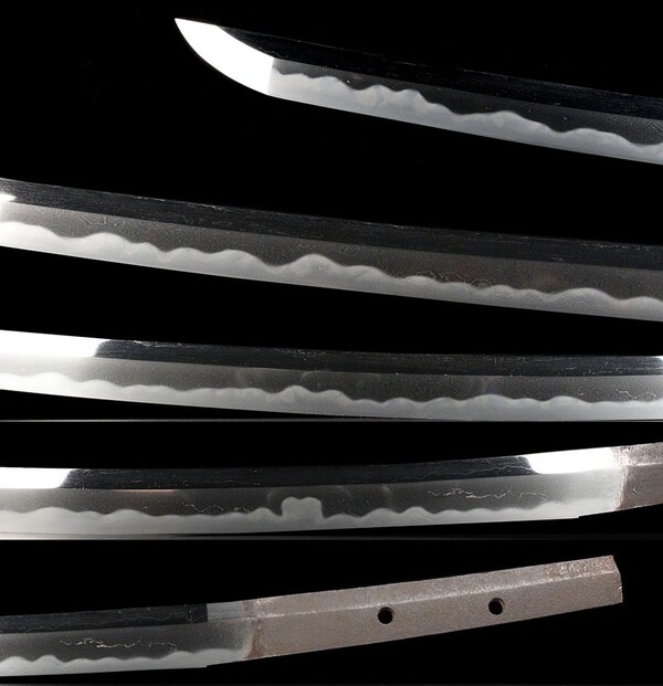

The sugata feels osuriage earlier Koto. But the workmanship seems to match this description (courtesy M Sesko) better, given the flamboyant, Bizen-style hamon and also what I think I see as patches of shiraki utsuri.

San´ami school, he made mostly katana with a stout sugata and a rather wide mihaba, the jigane is a dense ko-itame with
shirake-utsuri, some blades show a mizukage-like utsuri at the base, the hamon is a suguha or gunome, sometimes with ko-ashi,
but we also know a suguha with nijūba or a relative flamboyant koshi-no-hiraita gunome-midare which is mixed with chōji, the
bōshi is either sugu with a ko-maru-kaeri, a midare-komi that tends to jizō, or ends in a pointed manner, the yasurime are
takanoha on katana and higaki on tantō, he signed in a rather powerful manner with a thick chisel along the shinogi-ji of the
tang, wazamono, chū-jō-saku

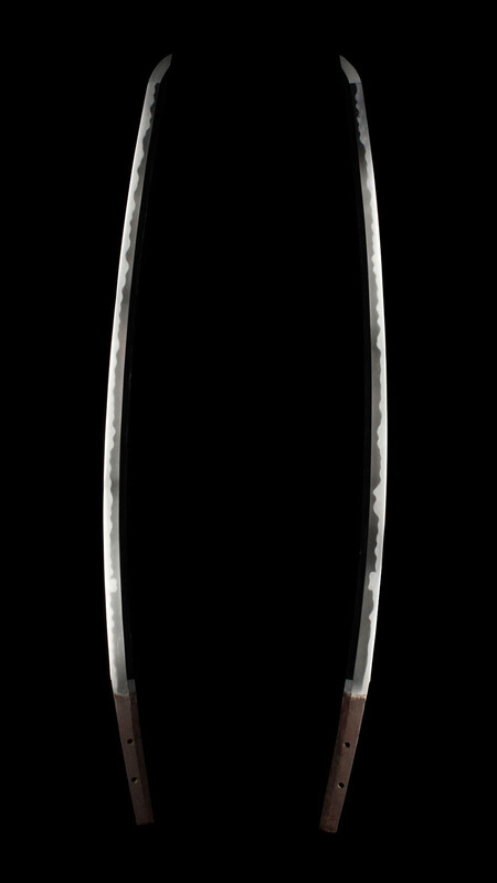

Given the length now, this would have been a reasonably long blade (late 70s or even 80cm). I would qualify it as “slender” given the thickness and mihaba as well.
By the way, whoever did the osuriage seems to have retained a small proportion of the original nakago there.
Again - to me this supports the theory for an older Kanenori.
