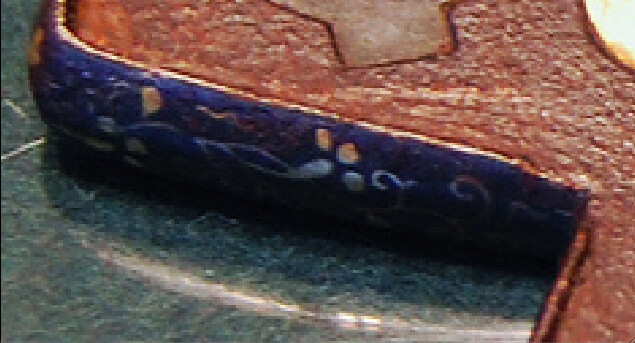

Looks like a modern cast iron fantasy tsuba to me which should be banned
Have a look at the rim. Too much work for being a "modern, cast fantasy".
reinhard
reinhard
Right Reinhard.
More pictures:
I got more details about this piece. This tsuba came with a menuki-kamon of the Mizuno clan... but I'm still looking for a link between Mizuno-someone and christianity:
Reinhard spotted the edge, and he was right, but that is a lovely tsuba there! :clap:
PS Do you have the name in writing? The Hana-omodaka Mon was used by several families, not just Mizuno. It was very slightly adapted by each. The Mizuno family attached two lines of flowing water to the bottom of the Mon, and cut short the three stems to compensate. Please cross-check with your version.
Guest reinhard
The surface looks bubbly, maybe cast and the colour looks painted, maybe chocolate brown. Just my spidey senses twitching......
The surface structure looks OK to me. The bright, reddish colour does not, but this could be easily explained by wrong lighting. Obviously the pics weren't made by a professional photographer and should be treated with a reserve concerning colour and other colour-related features. - BTW: This is also true the other way round: Many objects in the web, professionally photographed and "improved" with Photoshop or similar tools, look pretty poor when seeing them first hand.
reinhard
