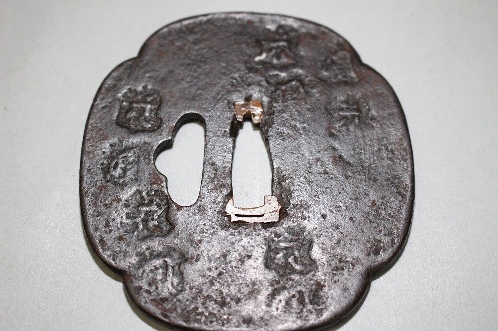

I have not posted in ages but started back up studying tsuba again. I was looking at these 5 Tenpo (Edo era) and am just starting to read up a bit on this type of tsuba. I was hoping you guys could help me evaluate this lot of 5 Tenpo tsuba.
Was interested in knowing if they all appear to be authentic and how would you rank them from best to worst (quality / workmanship)? I am attaching a single image of each and here are the dimensions :
Tenpo 1 - 8.00 x 7.65 x 0.30 cm Yamashiro Tenpo, iron plate with thin sukidashi mimi, kozuka ana and kogai ana with sakudo copper plug (umegane)

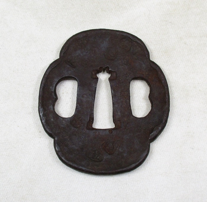

Tenpo 2 - 7.35 x 7.05 x 0.40 cm Saotome Tenpo, has typical folded rim at the four “corners” with grooves diagonally around mimi, two hitsu (one kozuka and one kogai). Has top and bottom sekigane.
Tenpo 3 - 8.60 x 8.15 x 0.35 cm Yamashiro Tenpo tsuba for katana, nakegaku (rounded square), fine tsukidashi rim, thinner iron plate.
Tenpo 4 - 8.60 x 7.80 x 0.35 cm Yamashiro Tenpo tsuba for katana, nakegaku (rounded square), rounded rim maru mimi, iron plate (itagane)
Tenpo 5 - 8.20 x 7.60 x 0.35 cm Yamashiro Tenpo, good itagane (forged iron plate) of rounded mokkogata  (4 lobe shape), sukidashi mimi, 2 hitsu ana

To my eye, about the only one that might be early-ish is the second one - the first one might be too, but is it lacquered or something?
These aren't bad, but... a lot of what gets tossed in the tempo bin is really pretty mediocre and is perhaps not what you want to study as being exemplars of their best work.  In addition, a surprising number of groups used hot stamps from time to time, so often pieces aren't even by the group - it might be better to call them tempo style...

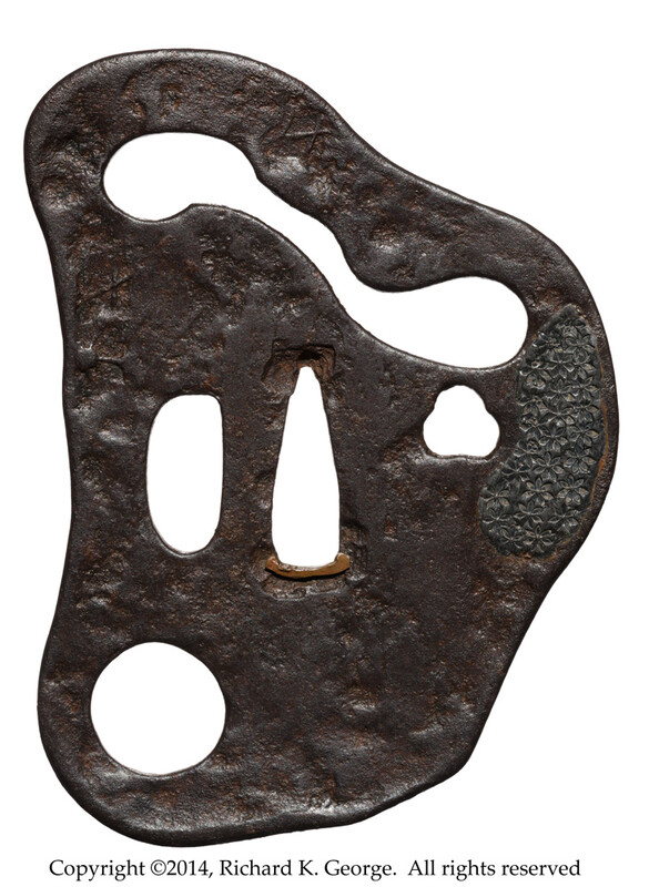

Here's a couple of (IMHO) good examples.  The first one is probably the best I've ever seen:

I agree on both points. I felt the second one ticked the most boxes for the style (mokko, folded rim, diagonal grroves, fairly thick, nice deep patina). However, it is a bit smaller in size. Oh, and I found that exact Tsuba on a web site talking about Tenpo so I felt it the "safe" choice.
The others, as you said and I agree with are probably mediocre later era pieces. Even the 2nd one might not be that early considering it's size...

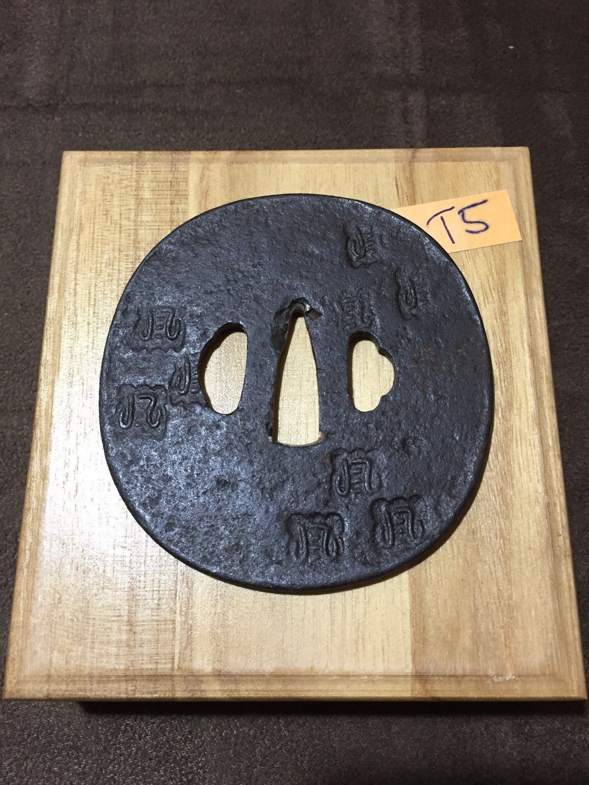

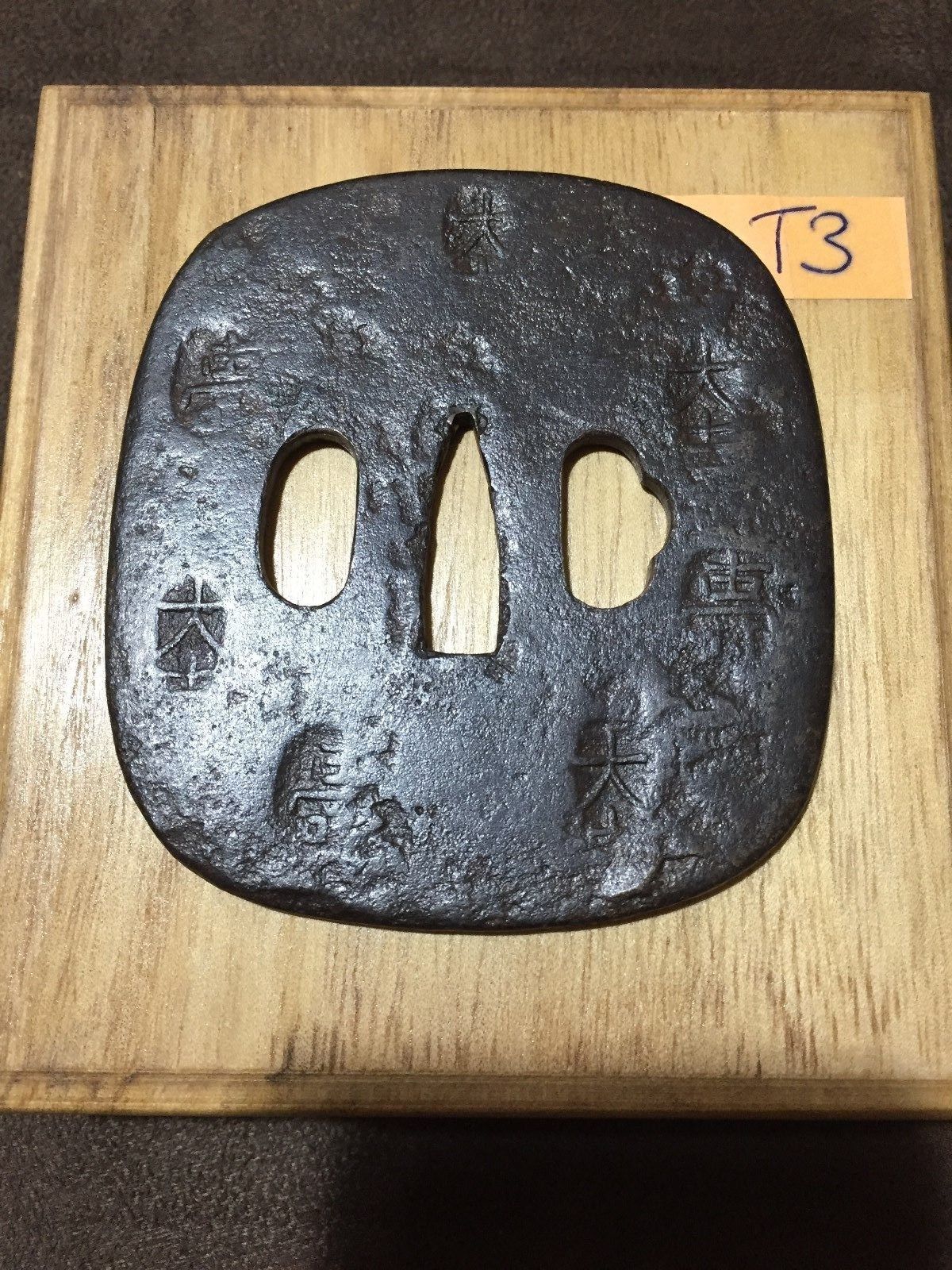

I found a few more I am calling 6,7,8 with dimensions below. 6 and 7 look pretty decent to me. I wonder if either of those are really that much better than say, number 2 from my 1st post.

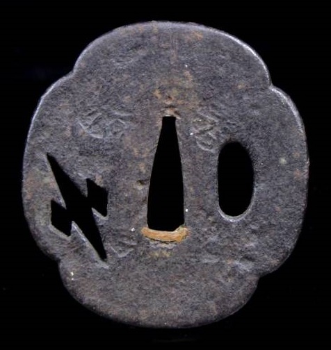

I threw in the last one that I am calling the dark horse. The pic is poor and the stamps a bit faint, but the 2 outer ana shapes are not typical. Not being an expert do those holes signify anything. Also, you can see the folds in the rim though it is a rather ugly-ish looking tsuba. Thoughts?

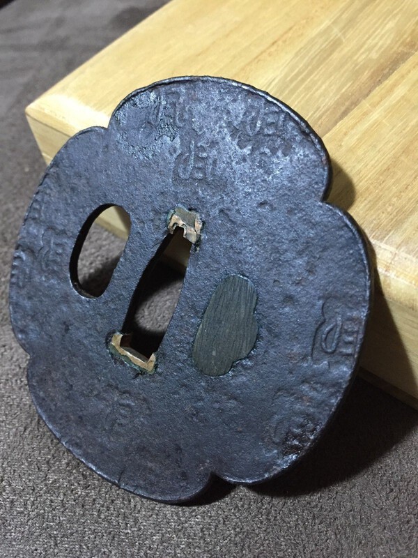

Yeah, I purchased #2. And then I found a very handsome and I "think" very old Tenpo (I assume?) Muromachi maybe?
What do you think of this one? Calling it number 9...
Dimensions Height: about 6.9cm Width: about 6.4cm Thickness: about 5mm
Curious as a I see maybe 4 stamps on front but no stamps on back...
Um, that's an image of the back and there are hot stamps on it :-) - doesn't look like a bad piece though :-)
FWIW, If you like this style of tsuba, you might consider looking for some pieces from the group is considered the school the Tempo guys came from - the Saotome group.  They seem to be known mostly for their kiku sukashi/shaped pieces, but there is a large body of pieces attributed to them (especially their earlier ones) that are excellent (great iron, composition, construction, etc) - and usually not terribly expensive.  Some of the tempo guys' earlier work (like the first two I posted earlier) match or is better, but most of the later tempo work just doesn't compare (All of this IMHO, of course).
I've posted pictures of a number of them in the past here/on the kodogu no sekai page, and you can find more with an image search - and decent ones are coming up for sale -all the time- (unlike good tempos).  and a few even have hot stamps :-)

I agree that one is very inexpensive but I already picked up #2 and it came in recently and am very happy with the condition. In fact, it is in such good shape I really question how old it is. Hoping it is because someone took really good care of it...
