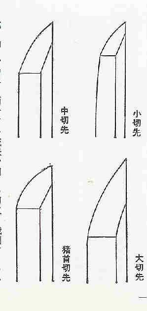

I am sorry, but I cannot agree with the theory.
If the kissaki is Ko-kissaki, Chu-kissaki, O-kissaki, or even Ikubi-kissaki, generally the distance from the tip to yokote of each type of kissaki is always longer than its yokote.
Hi,
I understand the theory. :)
However, I think that the difference between ko-kissaki and chu-kissaki is not the local proportion of the kissaki. IMHO, the difference may be identified from whole proportion of the blade.
On the picture below, upper right shows ko-kissaki and upper left shows chu-kissaki.

Moriyama-san, I understand what you're saying about looking at the shape of the blade and making a judgement, however I sometimes stll have trouble with ko-kissaki.
In your diagram I can clearly see that the image at the top left is chu-kissaki, however to me the top right image could be also be chu-kissaki as the blade width seems less than the top left image. That is why I am looking for a rough definition to help pick the difference.
I apologise in advance if this seems like a novice question.
Hi Justin,
Actually, that is the point. As for ko-kissaki blade, because the blade width near its tip is narrow, the kissaki has to be small naturally. As a result, that becomes ko-kissaki.
This is only my understanding. I am also a beginner. :)

you are right - I checked a few online ressources and they all say that the whole proportion of the blade is decisive.
Also looking at some pictures make evident that the theory I mentioned above doesn´t seem to be (always) correct and therefore can´t be a rule.
