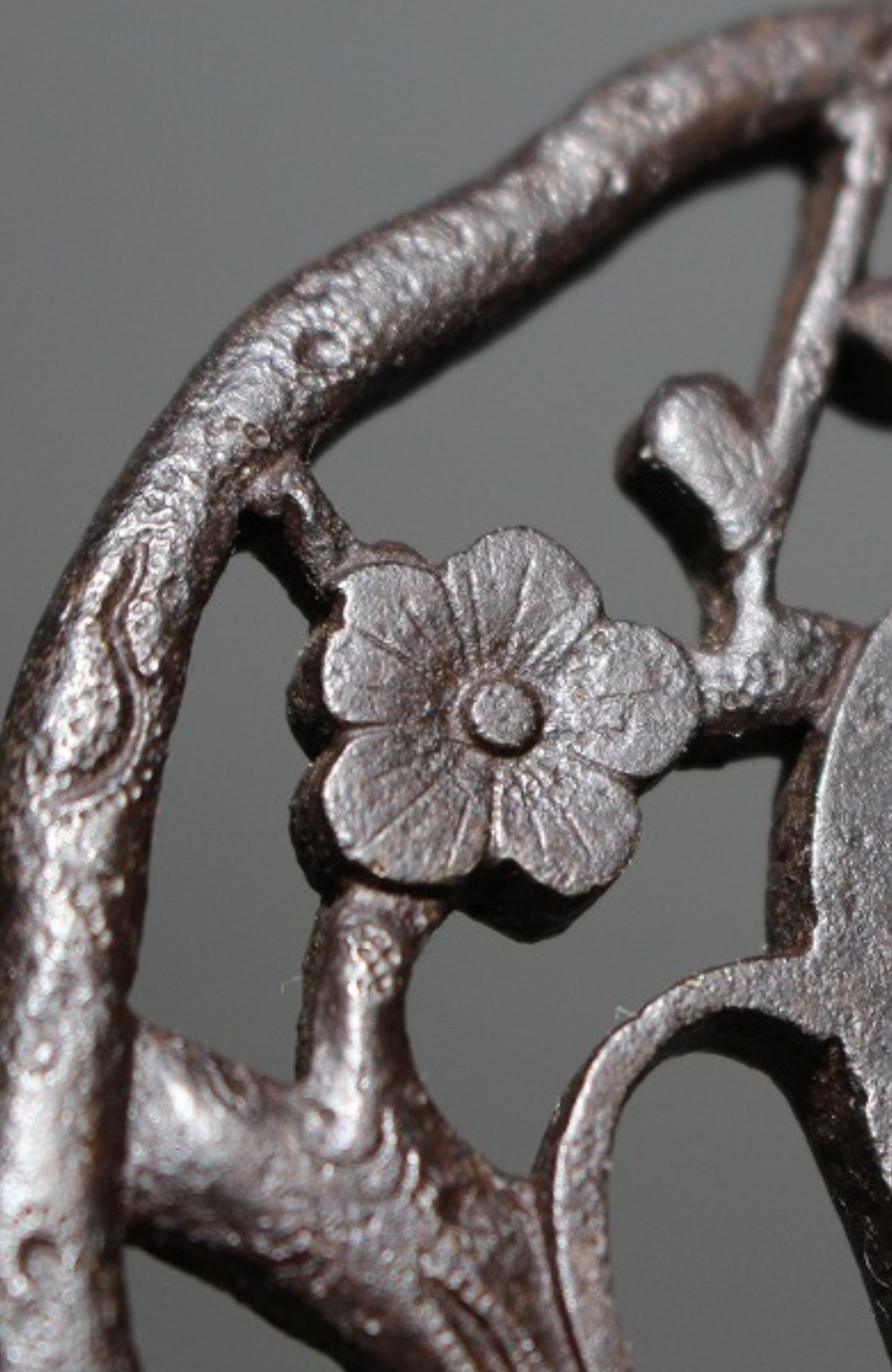

These two katana tsuba (8 cm Ø) looks on a first view very similar coming from the same artist or studio. On a scond view they are different.
My first thought was akasaka, than i go more (ko) shoami.

Akasaka is a reasonable call but the mimi (rim) is unusual
Is the pattern on the back different from the which I asume it is sp Choshu is a maybe
Kyote and Kyo Shoami but not convinced with seppadai

I would suggest these are characteristic of a type ascribed to the Bizen region.
More frequently they feature brass inlays, especially as flowers or blossoms. The curious 'worm track' carved lines and dots on the trunks are pretty unique to this group, that and the general 'naive' or robust rustic quality of the sculpting.
I see worm/tracks

Kissaki i see some bizen tsuba as Ford says, with that zogan inlays. These sakura tsuba are not fit into this group because they look very well made and they are not rough and naive. You find bones in the rim an they have a fine and different carving. But and this is the good news. An experienced and well known member of the nbthk germany has given me the right school for this.

Kyoto
Date early 17th century (1601 - 1700)
Artist/maker
Shōami School / Kyō-Shōami
Dimensions 8.1 x 8.1 cm (height x width)
Material index iron
Technique index forged, openwork, cut.
Some sources.
Reference Ashmolean Museum (EAX.10248), Völkerkundemuseum zu Dresden 1977 (Kat.-Nr. 34619)
