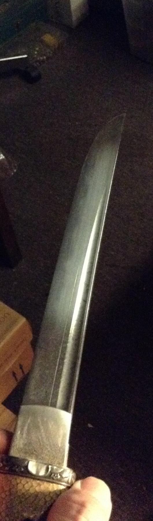

Kris, I would also like to get a better look at the jihada & hamon. Can you please take the bare blade, & take a few photos like this:
If you can show us a couple of shots like that along its length, we should be able to tell you if the blade is worth polishing.That bright line is called the nioi-guchi, by the way, & should be unbroken from the machi area down its whole length.

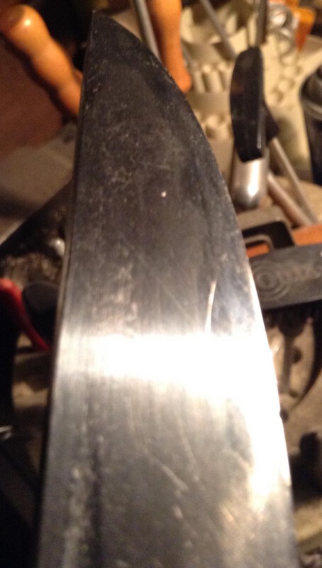

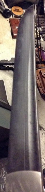

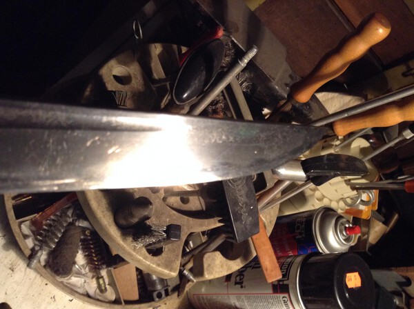

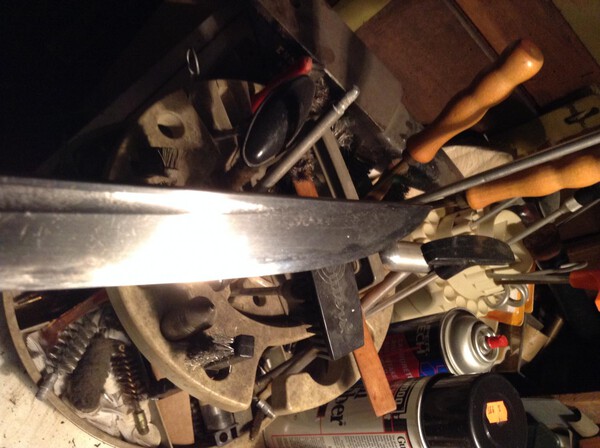

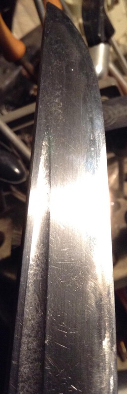

You're right, Kris, it IS difficult to get good photos, but at least there's a bit more info that I can see. There is a midare hamon of sorts, but I can't tell if it's continuous. The boshi looks to be chu-maru on the ura side. There are a couple of minor nicks on the cutting edge, but nothing serious.
What you have right now is a traditionally-made blade that could well date to very-early Muromachi, but is thoroughly beaten up. As caretakers, we should be cautious of anything that might shorten its lifetime, and polishing it would likely remove a lot of metal. Even now, its mei, jidai, & even the bo-hi are difficult to identify, & cleaning up the blade will make the bo-hi even shallower.
With the lovely koshirae, I'd be tempted to get the blade polished, but I can't advise you to have it done....
Dear Kris.
This would be a no brainer fr me, get it polished properly.  Given the quality of the koshirae then it doesn't even matter if it turns out to be gimei, (false signature).  I would certainly want to take the gamble; on one hand there is a chance this might turn out to be genuine and Steve's analysis of the mei makes that an interesting possibility.  On the other hand a blade in proper polish is always going to be more interesting to both you and whoever is the custodian of the sword next time.
Of course Ken is right the soe- bi, (small groove) is looking thin and would get thinner or even disappear in some places but the bo hi will survive just fine
Well it's your sword so of course your call but if you do decide to get it polished then we look forward to hearing about it and seeing it.
Whatever you do, do not go cheap on this one, do your research and pay for the proper polish.  It's a small investment for this sword.
