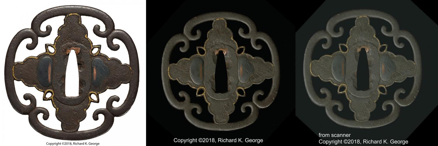

However, somebody pinged me on the kodogu no sekai facebook page recently about using a scanner for shooting fittings, and since I don't think I'd tried it in the better part of a decade (and I'm kinda under the weather so studying was hopeless anyway), just for grins I plopped that kyo-shoami (or is it Iyo shoami? :-) ) piece I had posted earlier on the scanner and gave it a go.
First off, I found that that I hadn't ever created a profile for the scanner using the particular combination of color depth and resolution I wanted to use (and if I had one it would have been dodgy anyway (since I haven't bothered to calibrate the beast since, what, 2010), and my scanner calibration software no longer functioned (gotta love windows 10 as well as companies that get bought a few times so they no longer support their products :sad: ), so I did a quick and dirty color correction by scanning a white balance card and getting the color/tint settings to apply to the images using photoshop.
Here's the result:  On the left is a version of the image shot with a camera, the center is the "final" scanned image, and the one on the right is the image out of the scanner.  Note that I ended up using a levels tweak to pull the dynamic range so it was actually across 5 stops, as well a little saturation adjustment.
I actually don't like the way scans look for a lot reasons, but as can be seen, it does let you produce a reasonably detailed image that is often better than can be gotten with a phone camera if no attention (if done without working with the lighting/care in camera placement/etc) - so... Give it a shot the next time all you can't seem to get an image that looks very good with your phone....
