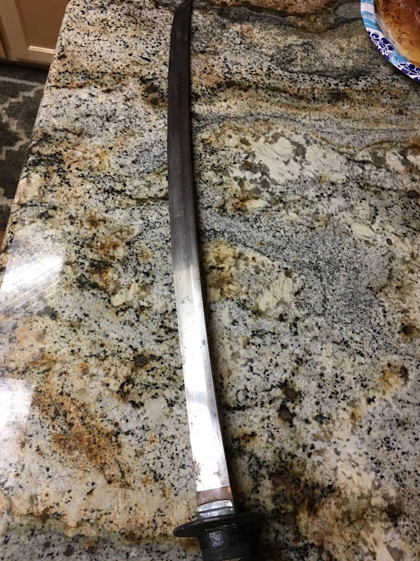

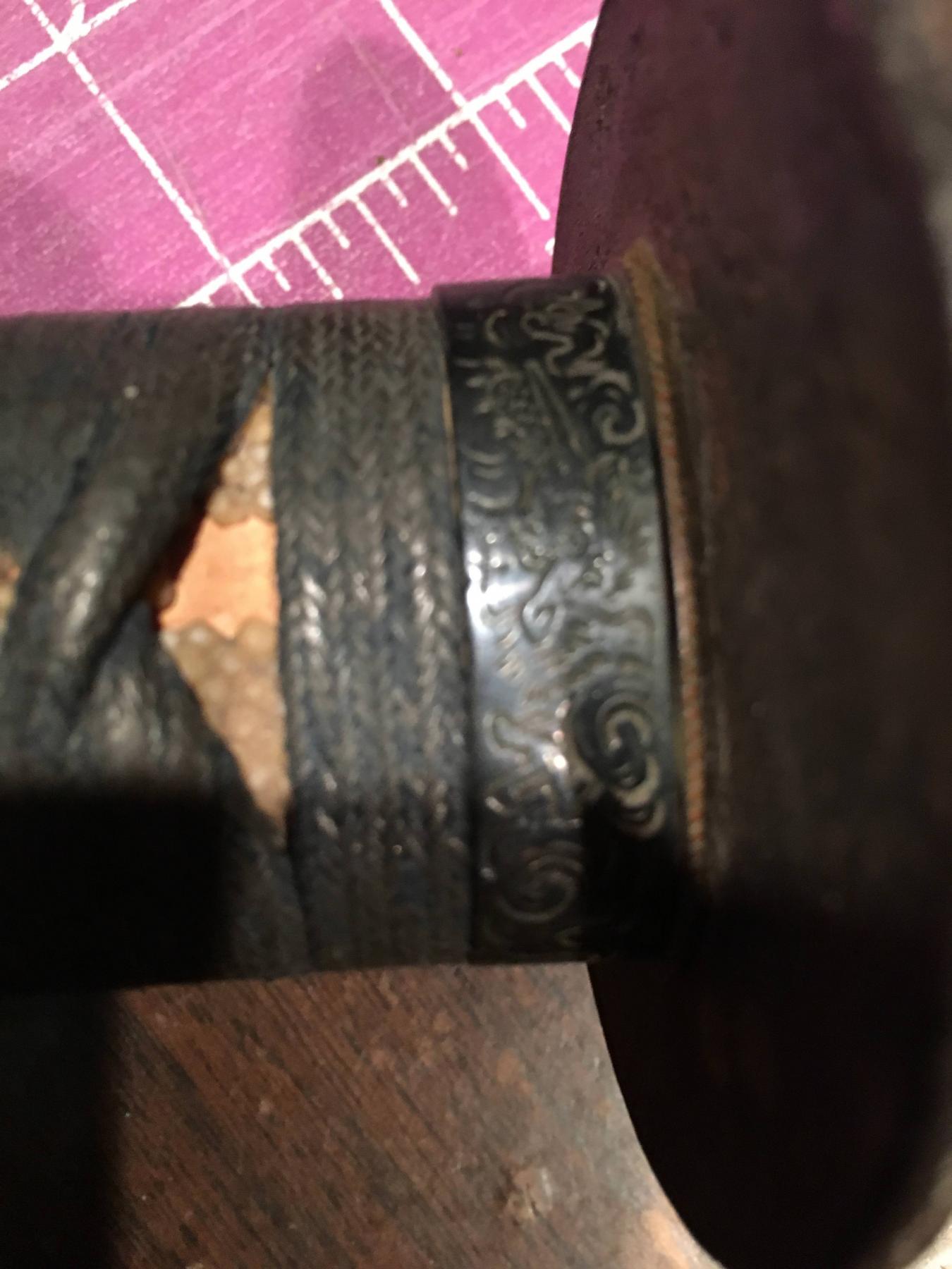

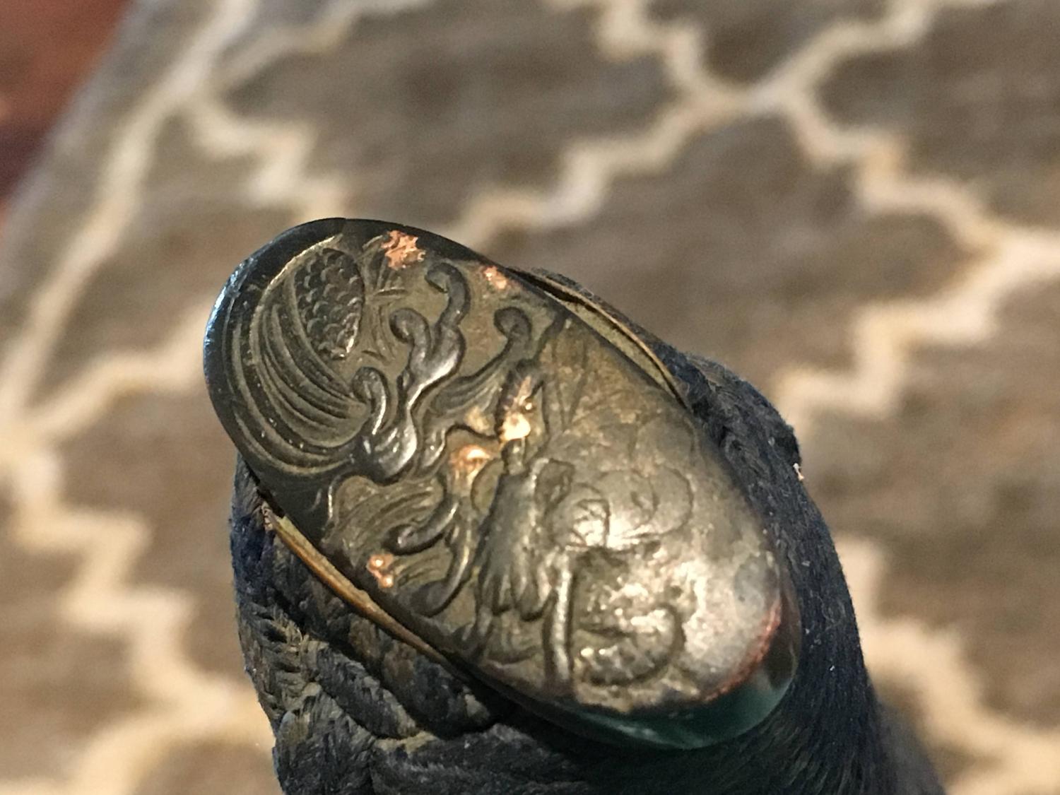

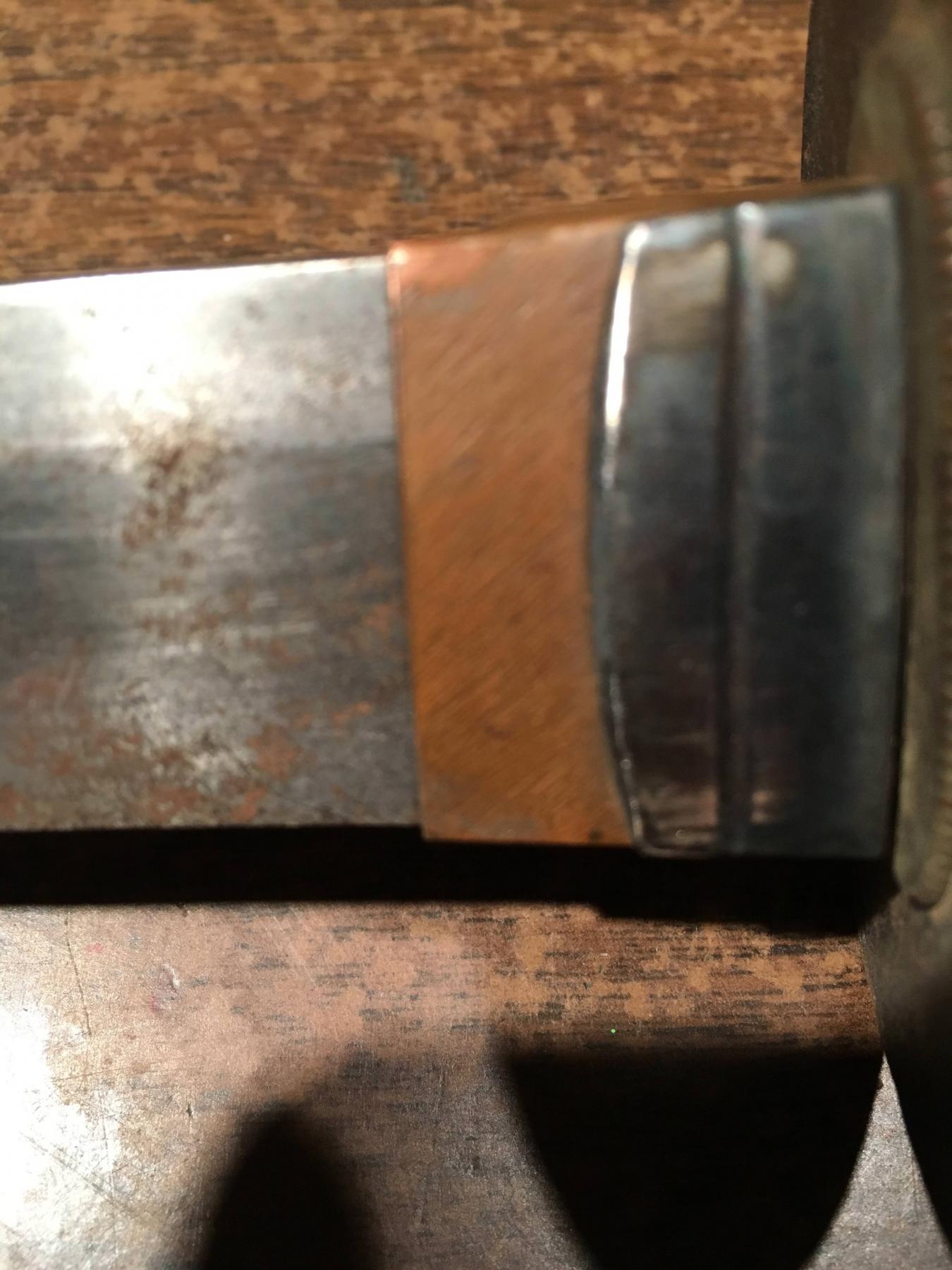

Hello, and thank you in advance for any help you can give me. This sword was recovered by my grandfather at the end of the war and has been in my family ever since. We know absolutely nothing on this and i was having issues finding information from reading websites. I'd like to be able to clean it up properly and have a bit of history on this sword. These are just some pictures sent to me so sorry for the potato quality, but i'll have better pictures once it is in my possession next week, the handle seems to be on pretty tightly, though the pin comes out rather easily so my parents didn't want to damage anything by trying to force it off. Thank you again in advance for the help!

Welcome to the board.  First bit of good news, this is a perfectly genuine Japanese sword, though it is hard to tell a great deal because of the condition and the photographs.  It is potentially something good and you should go slow!
You mention cleaning, hold that thought, a little light oil on the blade is ALL you should do.  It is very easy to ruin a sword and it's fittings by what seems like simple cleaning.  When you get the sword you will need to remove the hilt very carefully, if this is causing difficulties someone here can advise you on how to go about it.  The fittings look as if they have been with the sword for some time and as soon as we know what is under the paper and tape we can advise you on restoration.
Welcome to a fascinating study and we look forward to seeing some better images when you can, plus some measurements.  Lots of people will chime in with opinions and there may be someone close enough to you so that you can show them the sword in hand and get some advice.
Enjoy!
(Oh!  And by the way it is not a military sword as such in that it is not mounted for use in WWII.  This means that it is at least 19th century and possibly much earlier).

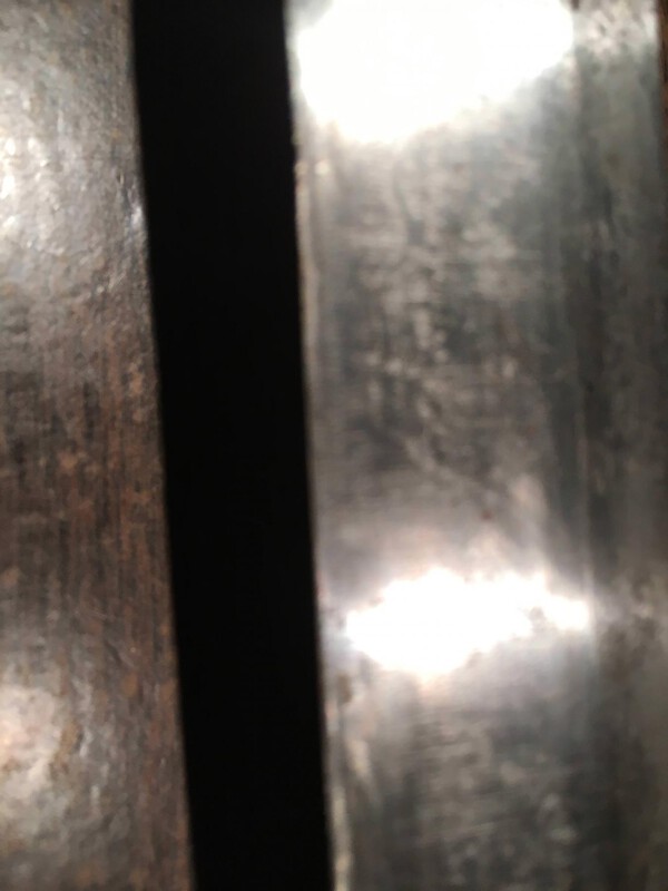

Alright so i'm back and i currently have the sword in my possession. I'm going to upload an imgur album to this just because i took too many pictures to upload them all into one post. The blade seems to be in somewhat rough shape, the edge has some damage from i can only assume being used for its purpose. The blade itself looks like someone tried to either badly sharpen it or polish it, so there's some scuffing and scratching in one area. There is some surface rusting but it's now oiled and will continue to be protected from the elements. There is no indication of any sort of makers mark or inscription on the tang itself, the tang came from the hilt rather easy by using the method from the link above. I haven't peeled the tape off yet in fear that i might damage the scabbard more than it already is, but i may attempt that later. I'm trying to get the pictures as best quality as i can but definitely let me know if i need to retake any and i'll do that as soon as possible.
