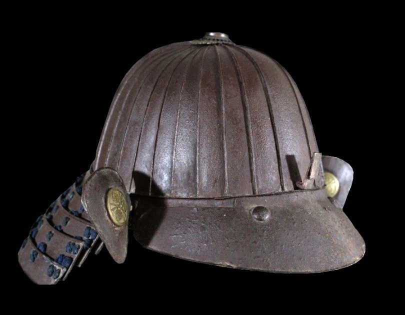

I have this suji bashi kabuto in my collection. After building up my swordroom i have now the place to present the helmet in display. I'm not the armor collector who knows much about it. I only know it has 32 plates and it is rusty.
The condition looks good for my eyes but it has no shinobi , ukebari and other material inside.
Would you refit the helmet? Or doing a complete restore?
How does it has looked in edo times?

Chris,  Your helmet is not rusty, but coated with russet lacquer - sabi nuri. It looks a little dusty in places and you are safe wiping it with a soft cloth moistened with a little alcohol just to get the dust off.
Ian Bottomley
Thanks Ian,
under the coat there is a little rust on some spots. And inside around the ring there is more. I oiled it from time to time with choji.
What you think how old is the helmet. I thought around middle edo?

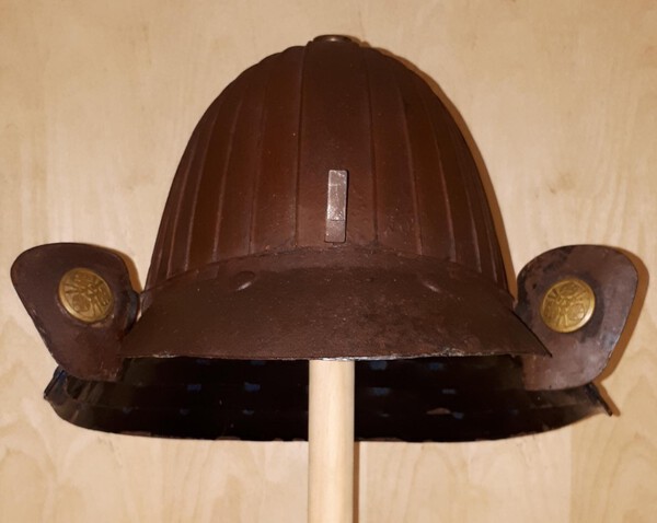

I think this is a good opportunity to point out to new katchu collectors about Tetsu-Sabiji Nuri.
it's a lacquer effect that simulates russet iron. You may ask yourself why would you apply a russet iron effect to an iron helmet? Well, there are a number of logical reasons.
Tetsu is often very thin or in some cases recycled (a common practice during Sengoku). The flaws and cosmetic flaws can be concealed. Also, the ground layers of the lacquer helps to strengthen the assembly.
More importantly urushi waterproofs the iron.
Here is are some images from a recent commission/s I had where I need to replace the tetsu-sabiji effect. It looks like iron, but you don't ever need to oil it.
Before
After
Replacing the Shinobi-no-o is easy, just can Youtube a video on basic rope twisting and then twist up some jute rope from the local DIY store.
Here are a few I made, they are dyed green with a little fabric dye.
