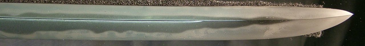

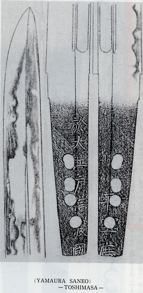

These are not my best photos but here are a few examples of activity seen in the work of Saneo.  This particular wakizashi was polished and papered by the elder and now deceased Yoshikawa San of the NTHK and was featured in the Token To Rekishi. It is unfortunately suriage but retains a partial mei and was signed Toshimasa.
