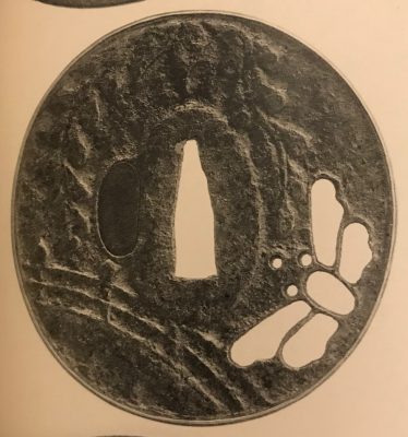

Thanks Henry. It's visible on photos that the surface is covered by hummer marks, it is not smooth. I compared the piece with a definite ko-tosho specimen (illustrated here), and remain in doubts. The age attribution is important. The seller said it's Momoyama, but it can be early Muromachi as well as mid-Edo. Any thoughts on this?
Ko Tosho tsuba that are ubu (unaltered) are usually quite expensive as they are rare.  It is quite thin which is a characteristic of older stuff.  However, the surface looks well hammered and seems carefully done in places.  The motif is also quite realistic (not as abstract as such older motifs can be).  It could be Momoyama, but I would think the care that it was made with seems more Edo to be honest.  By contrast, Momoyama stuff tends to be indulgent with inlay or elaborate motifs I think.  The Edo period saw a back-to-basic attitude amongst the warriors and revival in older styles of tosogu to consolidate this so by process of elimination would bring me to Edo... Or Muromachi if you are lucky...

I think if you sent it to shinsa, it would come back Tosho, not Ko-Tosho.

TENPÔ (JIDAI) may be a correct time of manufacture, but I think it is much later. I don't see hammer marks, instead the surface shows a very even ISHIME, probably from artificial corrosion/patination. The steel gives an impression of a modern sheet steel.
Without holding the TSUBA in hand, it looks to me like a late revival piece, nicely copied from a real KO-TOSHO TSUBA and with the correct dimensions..
Johni,
it is difficult to say with photos alone, but I don't see evidence of forging or fire-welding. Instead I think I see scale all over the surface, and remains of grinding a bevel on the rim (2nd photo, 5°°).
But that may well look different with the TSUBA in hand.
2.3mm thickness for an Edo Tosho revival piece did struck me as being unusual.
Most ive seen are over 3mm. Out of curiosity, anyone seen "authentic" Edo Tosho at this thickness before ?
I suppose sometimes you need to look that little bit harder, interesting.

Alex, the tsuba you attached is a Kamakura-bori, not Tosho or ko-tosho (and it's from my own post, actually). The reference tsuba of Sasano #21 is interesting. "My" butterfly cut EXACTLY the same, but Sasano's tsuba is smaller 85.0 x 84.5 x 2.3 rim, 3.0 center. His tsuba is thicker in the center and thinner at the edge. Mine is more or less flat.  It easily can be a replica.  Too bad!

The period spanned from December 1830 through December 1844. It is possible. Later? This is late enough to be considered a fake. My only excuse is that I paid a laughable amount of money. Still, the rule of only buying pieces with good provenance must be enforced on myself.

I wouldn't have called it a fake but a recent copy, unless it was sold to you as authentic KO-TOSHO and with a price according to that. In this case you should return it, if possible.

Jean, no, it was not sold to me as a ko-tosho and the price was not a ko-tosho. I agree with you.
