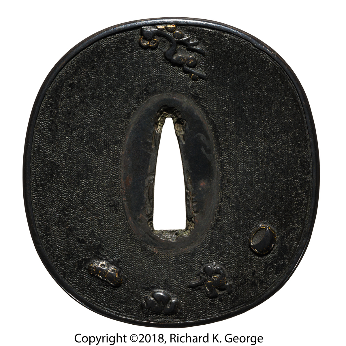

Hi,
Here's another recent acquisition:
  post-204-0-61567500-1517594895_thumb.jpgpost-204-0-43325300-1517594978_thumb.jpgpost-204-0-19357600-1517595027_thumb.jpg
The piece measures 81.0mm (H) X 77.6mm (W) X 4.57mm (T, nakago area), 6.35mm (T, max).  The piece is sanmai construction with what appear to be shakudo outer plates and a yamagane core.  I has lot of lacquer on the surface - and you can see gold uttori/remnants on most of the figures.  Both sides look the same, like they were both punched down in the same mold, though the nanako appears to be different.  There is a shakudo fukurin which appears to have been added (possibly as a replacement for an earlier one or damage repair?). here's a few close-ups:
The piece appears to be pretty old - aside from the crud, details like the gold appearing to be uttori, etc would point to it being  from the Muromachi period.
The thing is that I ahve not clue what the theme is - you got a bowl, a little guy running around that appears to be holding some crabs, an octopus(?), some crabs, and a pine branch at the top.  Are these items related to a particular festival, legend, etc, or...?  I spent some time looking through Joly and struck out on finding something (though given the random organization of the book, I'd believe I missed something).
Any help appreciated...
Thanks,
rkg
(Richard George)

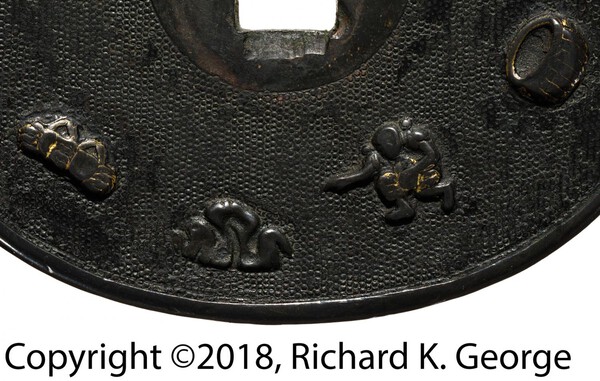

On the left side you see two crabs.
On the right side there is a basket.
The person could be a ama  海女 diver.
I have a Shigemitsu Tsuba and wonder everytime what it shows. After seeing a movie about Japan i realize that it shows shellfish collecting (mirugai  海松貝) in the same way like today at for example at mikawa-wan.
https://i.pinimg.com/originals/9a/0c/3e/9a0c3ea3937f1f7fce23ab8bb98315a9.jpg

While I think Chris may be right (and his Ama collecting guess - and picture - is better than mine), I can't justify the inclusion of the tree or blossoms/fruit with the Ama or collecting interpretation.  Perhaps you should explore the Japanese fable "Saru Kani Gassen" (the Battle of the Monkey and Crabs).  That story features a Kaki (persimmon) tree, an anthropomorphic monkey and several crabs.  To me, your tsuba tree looks like a Kaki (persimmon), and the figure could be an anthropomorphic monkey.  What's on his back?

Both sides are shown - the figures are pretty much identical - I did enlargements of the back side because the figures are in better shape.
here's an enlargement of the lower part of the front side:

Richard could you show the backside of the tsuba?
If you zoom in, you see that the person collect crabs.
No ama diver but crab collecting.  :)
George,
Thanks for the reply - I looked up this story, and I'm thinking you may well be correct.  It seems to have most of the major elements, with the "octopus" actually being seaweed...
