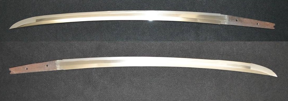

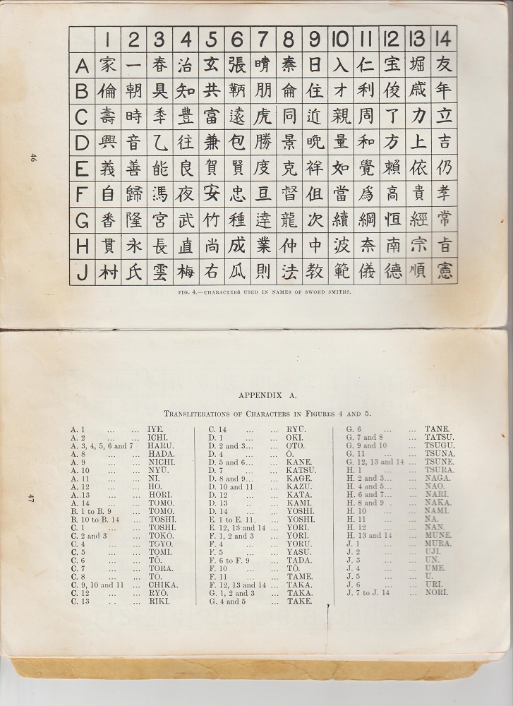

Thanks Jean i too started a search for niji mei starting Mitsu ...tachi mei Nambokucho era due to O kissaki, could be Shinshinto of course but the the end missing rest of the mei looked older
Did a double check in my Dobree and A14 looks closer to mei.
PM sending asap
im game ....lolo so easy... no really lets see what Morita sama says, getting interesting i say.

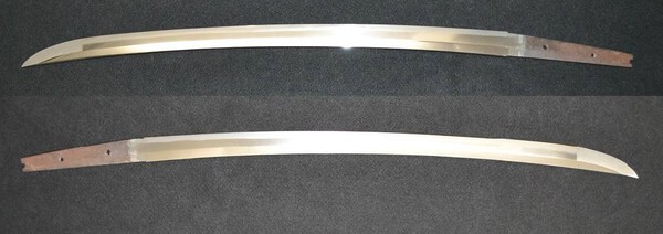

Is it a two-character name, or just the one character?

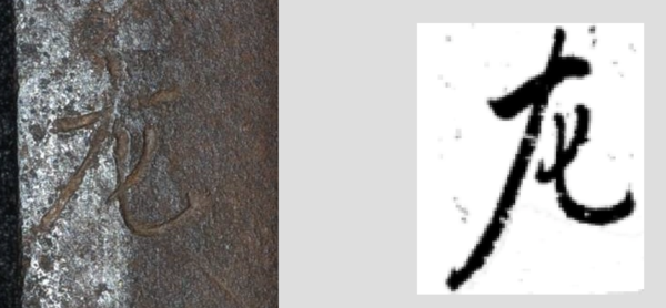

Edit: Looking at the photos now. Its hard to tell if its originally a two-character name that lost its second character due to suriage shortening, or if it was always just the one character.
Thought it is a two character signature... Having now the whole context, I tend to think it is only one character and somebody clumsily put a Sa (Samonji) gimei onto a mumei blade.
Edit: Its the same character though, 左, which is read SA by itself and SUKE in combination with another one (focusing on the readings of swordsmith's names).
