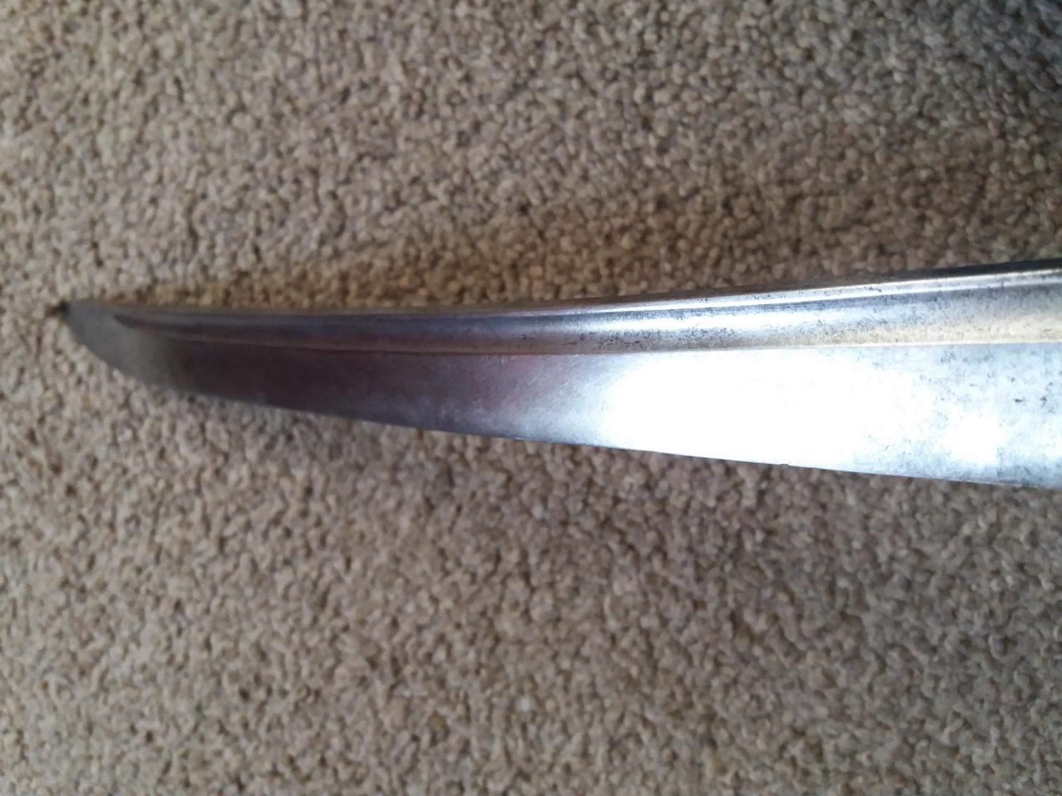

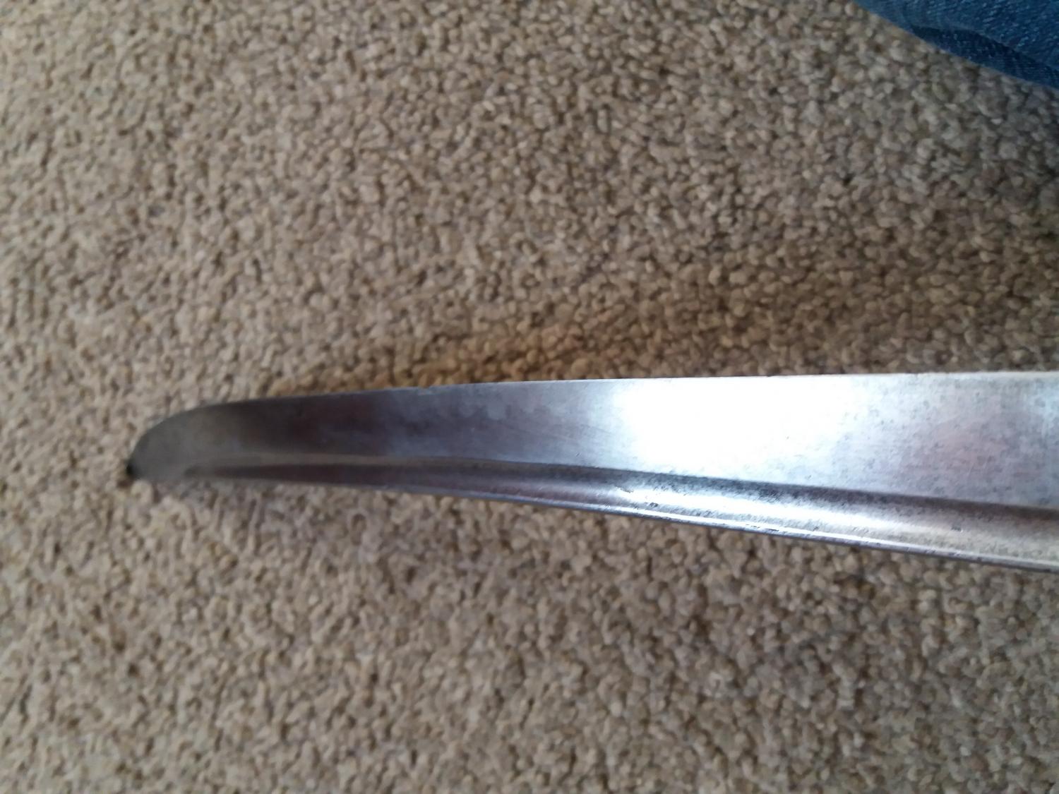

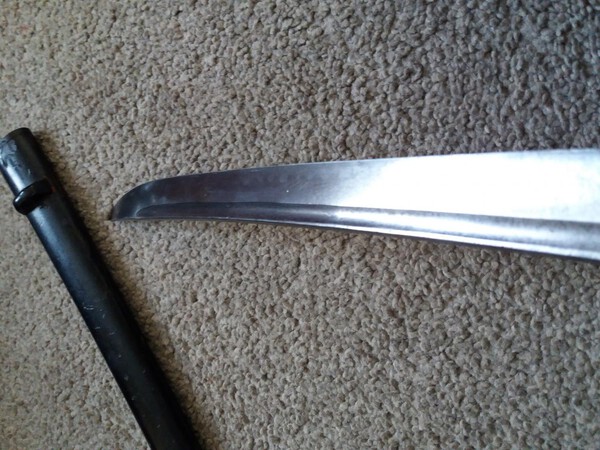

I recently posted a few pictures of this long tanto/short sword , and after holding the blade in the right light managed to get a picture of the temper line even though the blade is in bad condition, I'm just wondering if this will help date the sword ?

Hi Matthew,
Length is also a significant factor in dating a tanto - if you are able to measure the cutting edge that might give an idea. I'm trying to remember where I saw a chart of the various tanto shapes/ lengths related to era and set out for comparison...might have been on here...??

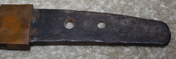

Its difficult looking at blades and judging them from photos, but this is just a thought I got whilst taking a look at the nakago.
First I thought it could be Machi-okuri, by imagining the habaki in the correct place with regards the bo-hi, two mekugi ana backs this idea up, you see it a lot on Sue Bizen katate-uchigatana. With machi-okuri though, I was thinking the nakago would also be longer than it appears to be.
Looking further, when you do this though, it appears the 2nd mekugi-ana is too near the tsuba, so, I was thinking "MAYBE" it was a proper suriage job OR after a bit more thought, had maybe Aikuchi fittings in the past.
As I said though, a pain doing it from photos, but I get the impression the nakago has been messed with.
Hello Alex, yes Machi Okuri is a type of shortening you are correct qwhile it will not alter the whol blade length unless it goes along with a shortening of the tang at the same time - which hurts the blade as a whole much more. My impression is that the tang has not been shortened but I can not say for sure. My first impression of this blade, until we had seen the addditioal images, was that it was an older piece and not Mino.
