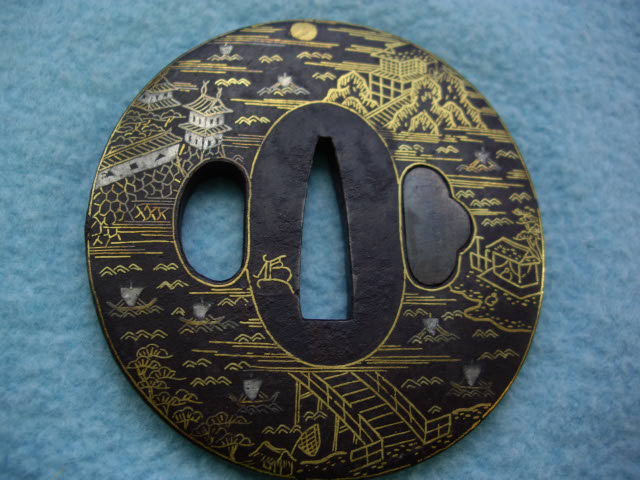

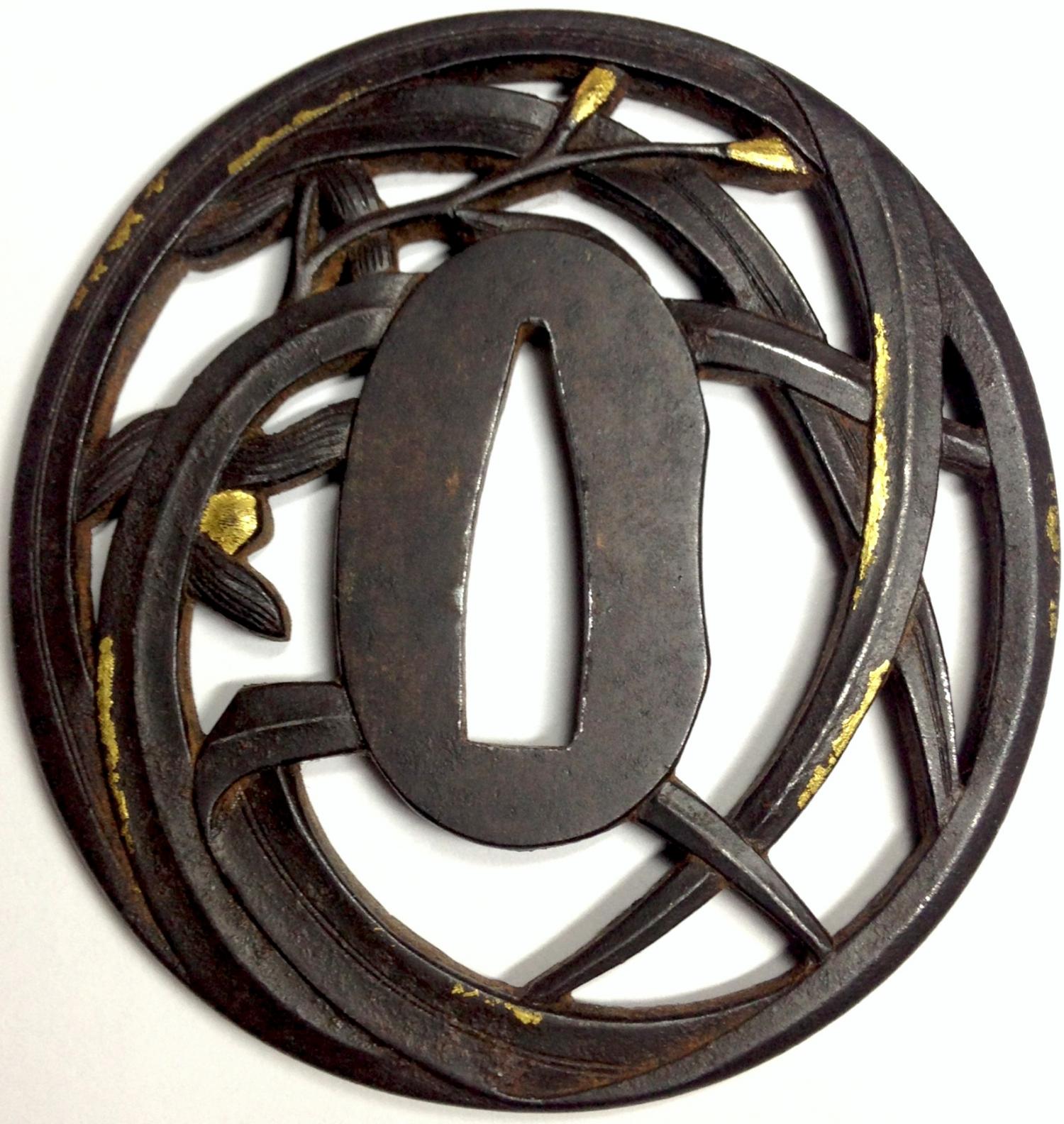

Hello,
I recently purchased an iron sukashi tsuba  (photo2) with remnants of applied gold foil (not amalgam gilding). (The gold is not inlayed, but appears to have been applied with some other technique; the usual damascenening file marks are absent). I've been able to find a photograph (photo3) of a similarly 'gilded' tsuba in the same style with even fewer remnants of applied gold foil.
I have found references in Henri Joly's work that indicate that many iron tosogu elements were stripped, at some point, to recover the gold from their decoration. Does anyone from the forum know if these tsubas may have been victims of such abuse, or is their condition simply the result of wear and tear?

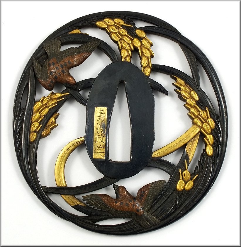

I would also be most interested to know, if any of you could suggest what may have been their original appearance. Photo 1 is of later shakudo example where the leaves were inexplicably (at least to me) only partially gilt in their original state. Is there any particular stylistic tradition which might explain this?

The 'buds' were certainly damascened as very fine cross hatching can be discerned through the wear of the gilding. The thickness of the 'gilding' on the leaves (>10 microns, no cross hatching), however, makes me think that this is not amalgam. It also seems that the pattern of the gilding on the leaves is more reminiscent of wear than of deliberate decorative intent. The reason I included the shabuko example is that it seems that partial gilding of entire sections of leaves apparently belonged to the tosogu esthetic. Here is another photo which depicts a fuchi/kashira set with very similar partial gilding of leaves, illustrated in the shakudo example of my first post. The question which is of greatest interest to me is the origin of this unexpected, yet elegant treatment of leaves.

Marc,
John answered your question.  All three look as originally intended ( excepting some slight wear), no heavy wear or intentional
"stripping" of precious metal has occured. An open questioning mind is a good thing....self manufactured conundrums or apple/orange comparisons are not. Relax.

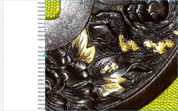

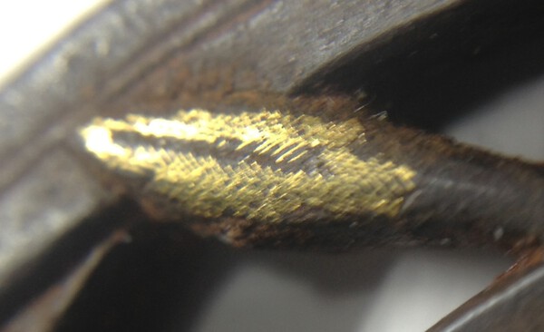

I thought it might be useful to include a close up of the damascened buds, in which wear reveals the cross-hatching which I have since learned is associated with Numone-Zogan. I also came across a quote from H.C Guansaulus from his 1924  work: The Japanese sword and its decoration p119 which seems to confirm that Numone-Zogan was used, at least in part, on this tsuba:
"Nunome-zogan is produced by hammering the inlay upon a surface which has been cross-hatched and scratched to a texture-like appearance, in the little threads of which the inlay gains a hold. This process may often be discovered upon pieces that are worn. "

I'll just offer a few observations...
Mercury amalgam gilding cannot be applied to iron or steel. This is because the mercury simply won't stick to the iron. This problem can be resolved by first copper plating the iron and then applying the mercury solution to that. As far as my experience goes I've never seen evidence that old tsuba-ko ever did that though.
The mercury amalgam, when applied to non-ferrous metals or alloys isn't simply rubbed on the bare metal either. A special solution of mercury dissolved in acid and diluted with water is rubbed on the prepared the ground, a bit like applying a flux, this leaves a thin mercury layer that then readily absorbs the amalgam.
A less well known or recognised way of gilding non-ferrous metals and alloys involves fusing, at relatively low temperatures (about 400 degrees C) , thin gold sheet. This is not to be confused with the contemporary Korean technique of Keum Boo. The technique, on tosogu can be recognised where the edge of the gilding really does have a defined edge that you can feel with you fingernail. To my knowledge this process, which appears to be quite common , hasn't properly been defined in tosogu literature nor is it practiced today. It is also distinct from uttori as far as I can detail.
With nunome-zogan, as has been described, it can most readily be identified where traces of the chisel work crosshatching shows through the worn gold foil but it's important to realise that simply because you cant see the crosshatching doesn't mean it's not nunome-zogan. The finer work is cut such that by the time the iron is patinated the marks are invisible to the naked eye.

Although this thread diverged onto an essentially technical digression about amalgam, I must thank Ford Hallam for indirectly suggesting an answer to my primary question:  What may have been the extent of the original gilding on this tsuba?
Indeed, in one of his contributions to the thread, he concluded by stating "The finer work is cut such that by the time the iron is patinated the marks are invisible to the naked eye". If I have chastised myself for not thinking of this myself, his comment prompted me to inspect the tsuba under higher magnification. Therein lay the key to my original query. I have yet to map out the extent of what remains of the preparatory work for the Numone-Zogan, but it seems clear that what remains of the gilding is a very partial rendition of the craftsman's intent. From the cursory inspection I made of it, I suspect that the original Numone-Zogan highlights likely resembled those of the later shakudo examples I've illustrated in this thread.
It certainly make me wonder how many iron tosogu fittings, originally adorned with Numone-Zogan, now present an appearance far removed from that which they originally had..

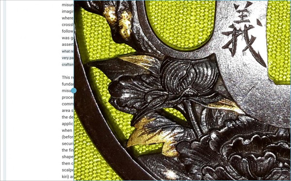

I hope you'll forgive me using your various comment and observations to illustrate more specifically the pitfalls I've described in my previous post.
 ....in one of his contributions to the thread, he concluded by stating "The finer work is cut such that by the time the iron is patinated the marks are invisible to the naked eye". If I have chastised myself for not thinking of this myself, his comment prompted me to inspect the tsuba under higher magnification. Therein lay the key to my original query. I have yet to map out the extent of what remains of the preparatory work for the Numone-Zogan, but it seems clear that what remains of the gilding is a very partial rendition of the craftsman's intent. From the cursory inspection I made of it, I suspect that the original Numone-Zogan highlights likely resembled those of the later shakudo examples I've illustrated in this thread.
Your point about the extent of the preparatory ground crosshatching is incorrect, I'm afraid.  Your apparent misunderstanding stems, I imagine, from your belief that wherever there is/was crosshatching then it would follow that originally there was gold attached there. You assert; "...it seems clear that what remains of the gilding is a very partial rendition of the craftsman's intent."
This reveals your fundamental misunderstanding the process. In fact it would be common practice to cut an area somewhat bigger than the desired eventual gold application. Even the gold foil, when initially lightly applied (before the final fully securing) is a little bigger than the final outline. The rough shape is tacked in place and then carefully cut out with a scalpel-like tool (mawashi-kiri) and the excess peeled away, leaving only the precise shape as required. The foil is then properly secured and burnished smooth, obliterating the crosshatching seen in the un-worn gold, and the surrounding iron ground.
In time, as the gold is worn away through handling, the underlying crosshatching becomes visible and the gilding takes on the appearance we easily recognise today. We appreciate, today, the suggestion of "wabi-sabi" this worn effect implies but the likelihood is that this isn't what  it looked like when new.
Sometimes, if you examine this sort of work under a microscope you can still see traces of the scalpel cuts.  All this to say that the irregular gold edgings in the Bushu iron tsuba's leaves is deliberate and mostly exactly as the maker intended. Period illustrations of similar designs reveal exactly the same sorts of details, ie; those irregular edgings to the leaves, just as happens in nature, and in Japanese art illustrated to suggest the transience of the beautiful flower even as it blooms.
As for the Shakudo tsuba and it's somewhat angular hard edged graphic gilding style , that too is simply yet another an artistic convention. One we see in many woodblock prints and period painting of certain schools.
  • Like 4

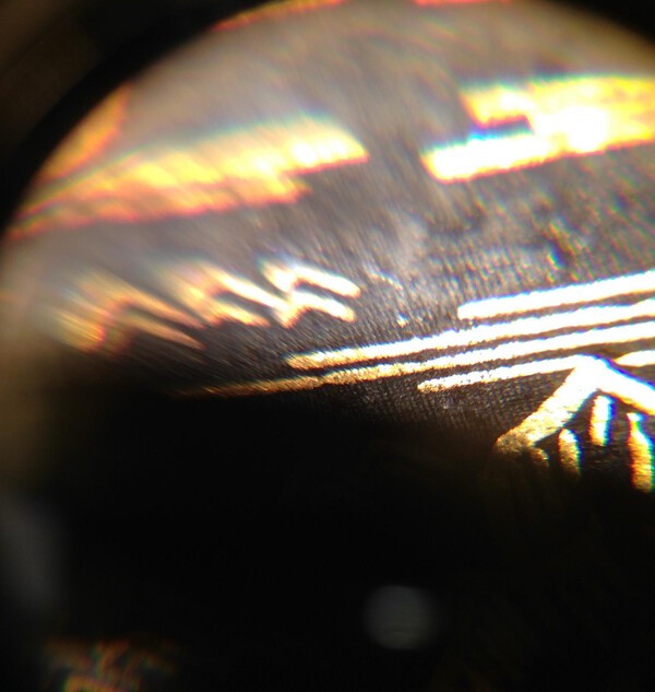

I finally dug out the tsuba pictured above and viewed it under light through a loupe. By golly, very very fine hatching contiguous with the gold applique. It must have been very thin gold leaf pressed as it, (from wear?, intentionally?), has no thickness to it. Another thing I saw was that the hatching was only in the areas where gold appears, no worn, completely bald hatching observed anywhere else. John
