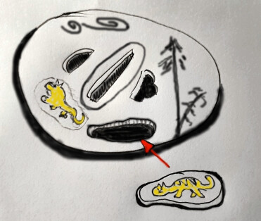

Today i saw an iron Tsuba with a nice motif of 2 tiger and bamboo. I think it was from the 18th century. 1 tiger inlay was loose. I thought the motif is a weaker material than iron. But here the Tiger was on a metal plate and this plate fits into the tsuba. In the afternoon i come home and looked through many pictures from iron tsuba with motiv and now i see in many that iron plates on which the motif is fixed. My question ist how they fixed the iron plates with the motif on the iron tusba? And how they made it that it is not seen later. The tsuba is forged and also that plate for the motif is from the same material.
I think that Chris is referring to the practice of inlaying a design element, a piece of iron to form the body of a tiger for example,  inlayed into an iron ground.
If this is the case then the ground is cut away to the shape of the inlay, the edges slightly undercut, the inlay piece inserted and the edges punched down to secure the inlay.

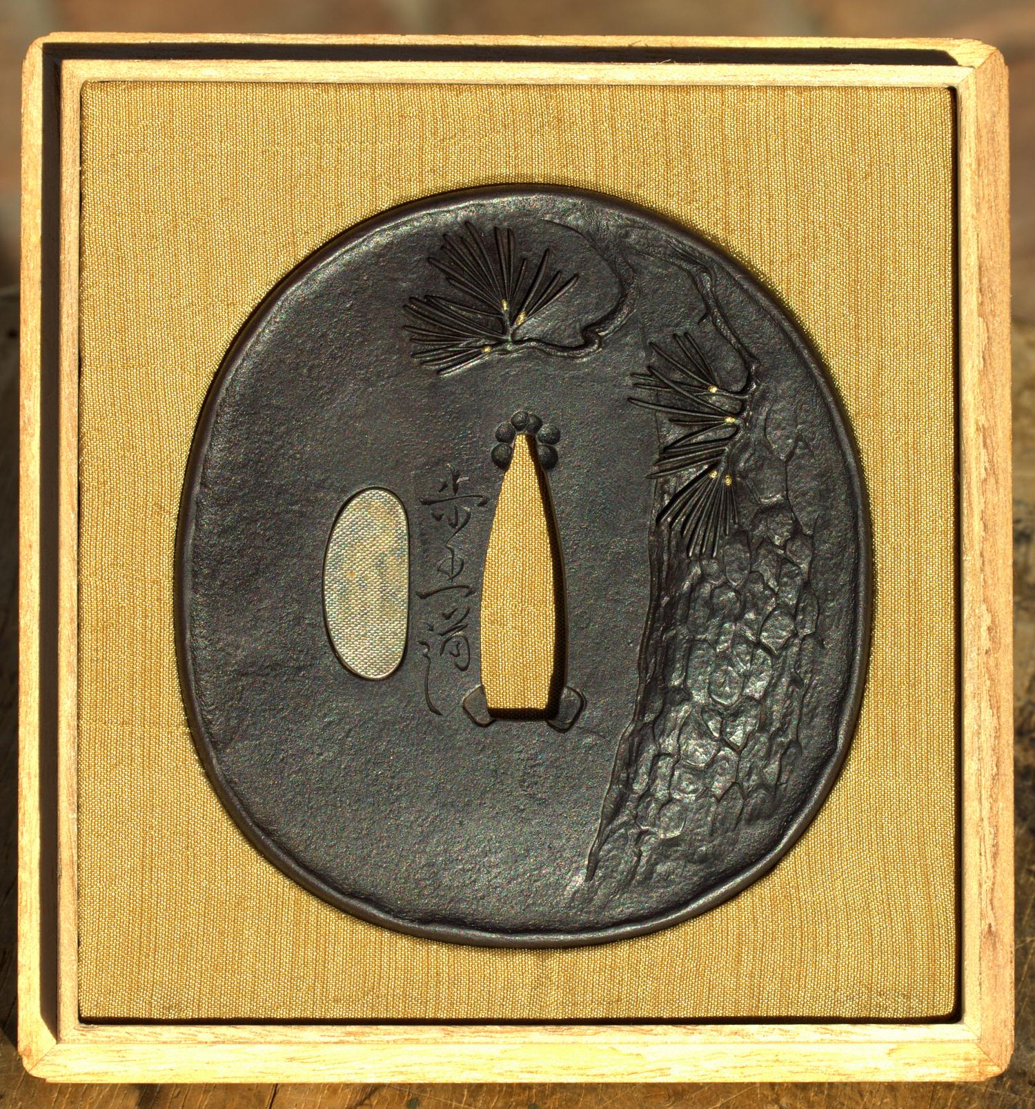

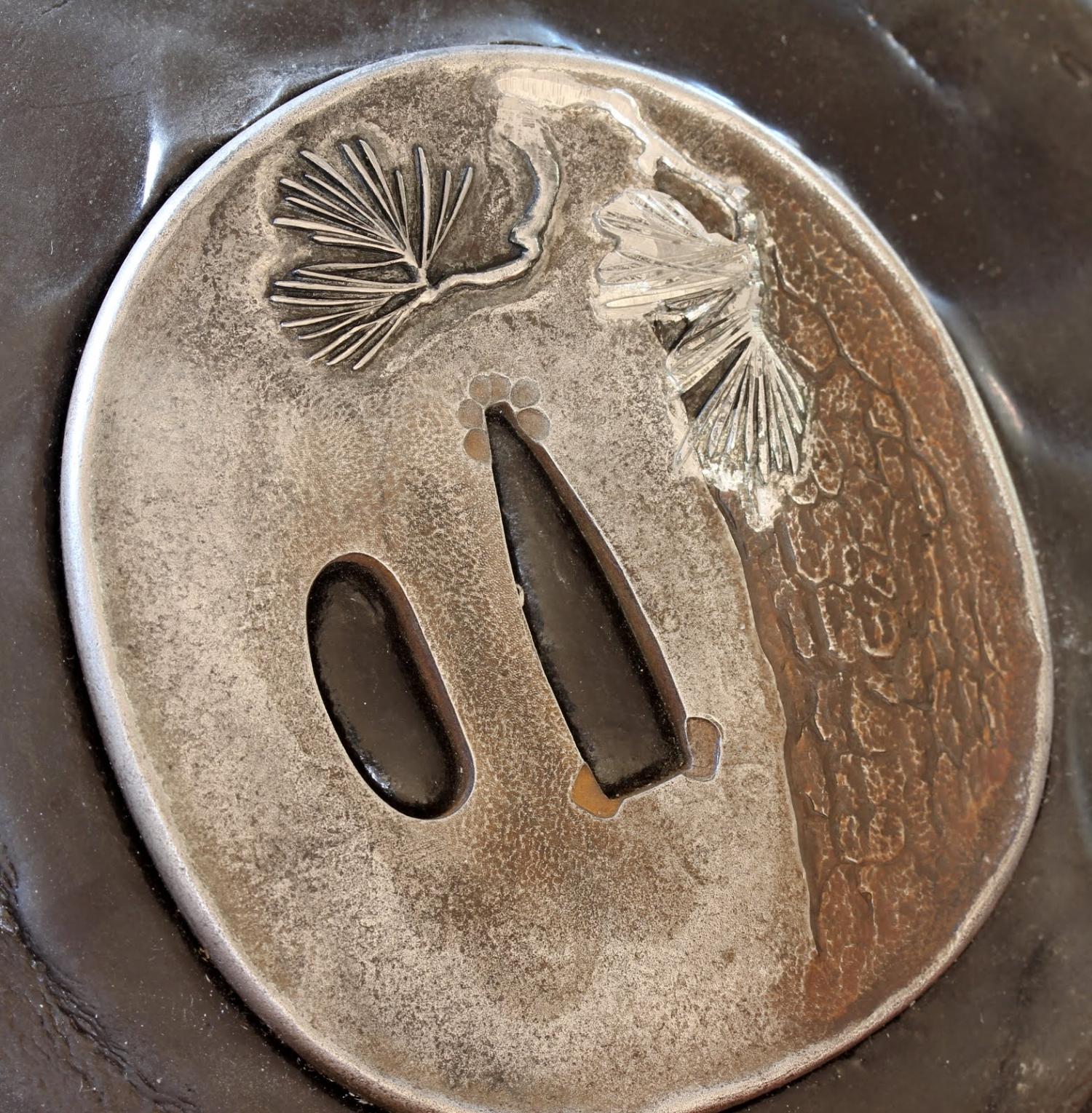

In the image below you might be able to see where I inlaid two oversized iron pieces where I wanted the pine needles to be. The more completed group has a clear outline where you can see I've worked the join in to hide the seam.
The other group is in this image is not so far in terms of defining the needles but you can see the larger patch I set in and how I've outlined the needles. The excess iron was then simply carved away to leave the fine cluster neatly separated and appearing to lie on the undisturbed iron ground.
...and what can't easily be seen in the photo is that the centre of the pine tree's trunk also has a section added in  that it allowed me to create some volume and a feeling of roundness up beyond the level of the base plate of iron.
