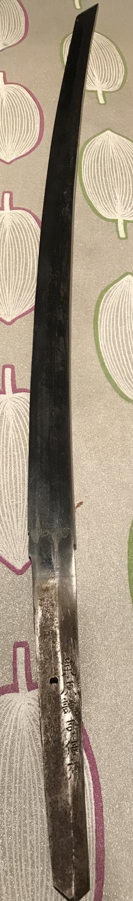

Dear Michael.
(Please add your name to your posts)  John has supplied you with the translation, now comes the rest.  Big names are often faked but this looks worrying from a number of viewpoints.  More pictures of the overall shape of the nakago, (tang) would help as would more pictures of the sword.  As Gordon suggests there is something not good about the surface of the nakago and the style in which the mei is cut is a worry.  Have a look at this one to compare and do  post more pictures if you have them.  http://www.aoijapan.com/img/sword/2016/16208-2.jpg
All the best.
Guys, without being too forthright here, I shall enedeavour to be objective and constructive to our fellow member as this to me appears gimei without a doubt.
So, Michael, while this is not my area of collecting and I am not familair with the smith, below are some thoughts and suggestions:
- look at the execution of the chiselstrokes of your mei / signature and compare it to the one posted by Geraint. Analyse the confidence and smoothness of execution of both signatures
- look at the yasurime (filing marks) strokes on the nakago of a genuine nakago/mei (the one from Geraint or the Juyo image which I have attached) and compare them to the left hand side of your omote nakago
- look at the spacing between the different kanji (characters ) - do you notice how your forth one is almost dangling lonely, separated from the ones above by too big a gap? Compare to the genuine ones.
- do we think the makura of the mei (the raised edges of the signature) would not be affected by subsequent scratching (ie one would have difficulty scratching or cleaning just around the mei and chiselstrokes)
obviously not a good photo, but it looks like a fresh drilled hole with the burr's still around the rim , not a good feeling about the tang , Japanese ??
better and more photographs to be certain and showing all the tang + blade.
maybe well off the mark , but not convinced with the current pic's it is genuine .

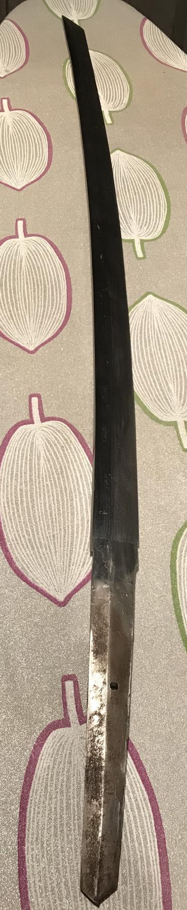

Here are some new bad photos of the whole sword.
I will follow up with some photos of the other stuff.
post-4368-0-42183800-1515619617_thumb.jpgpost-4368-0-86386200-1515619624_thumb.jpgpost-4368-0-55712100-1515619634_thumb.jpg

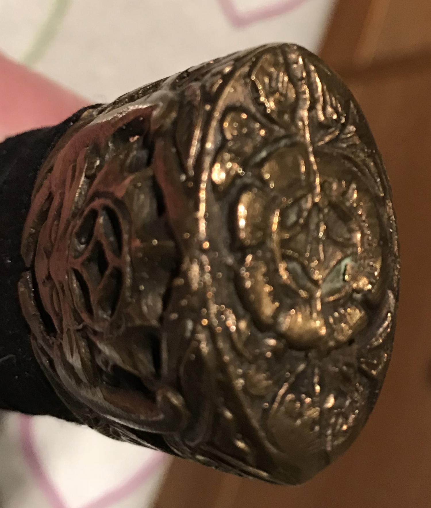

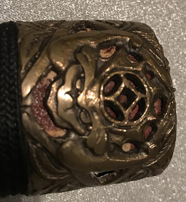

Here are some more pictures, chinese or not :)
If there is any interest I can try to take some better photos of the blade in daylight on Saturday.

Michael,
Get your money back. There is zero chance this is a real Japanese sword unfortunately.
Even if he had it for 50 years...it is still a Chinese fake, and a poor one at that. Sorry. But if any consolation, there are MANY members here who started out the same way, and today are collectors. Don't give up, but ask before laying out funds.
We have Swedish members. See if you can visit one and examine some real swords.
