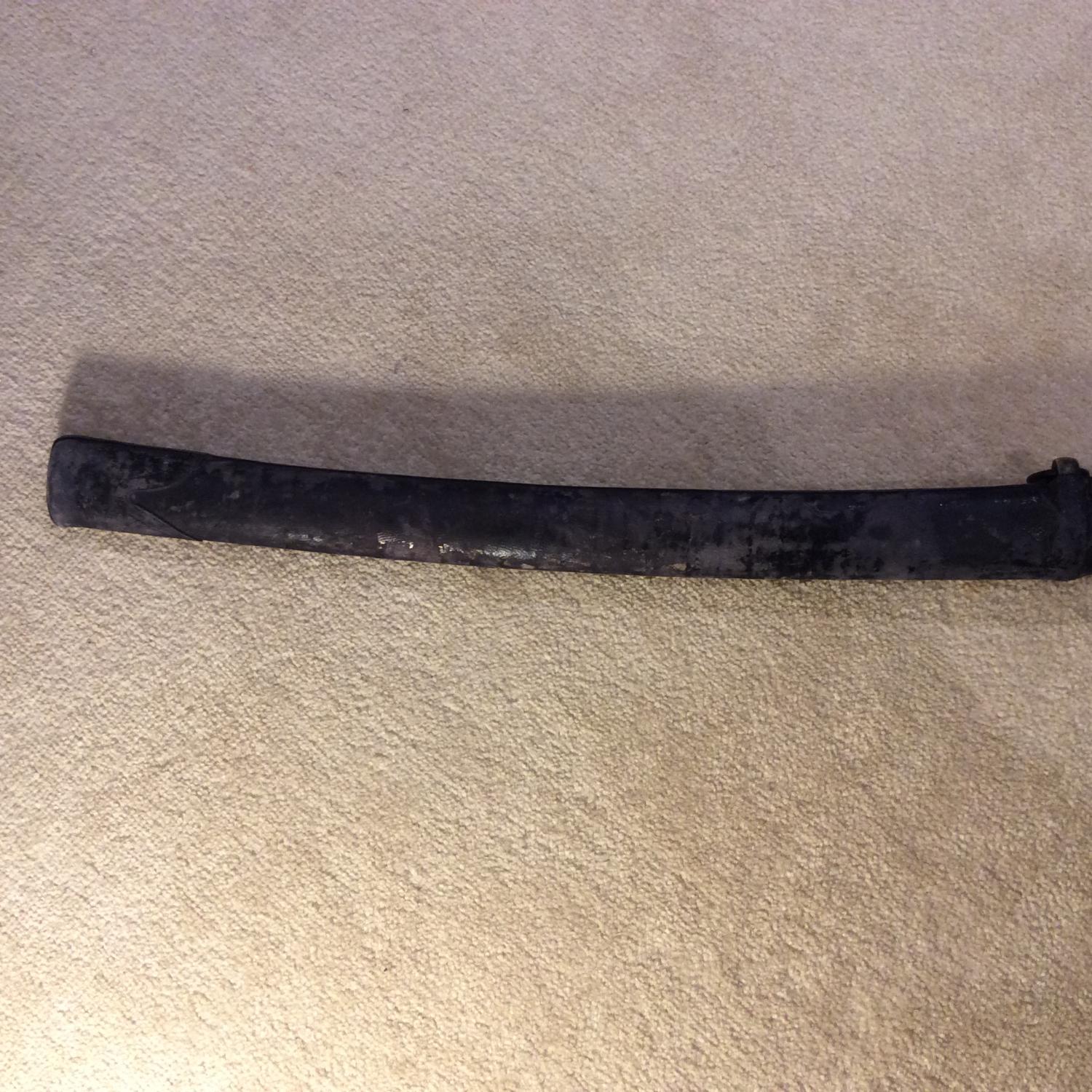

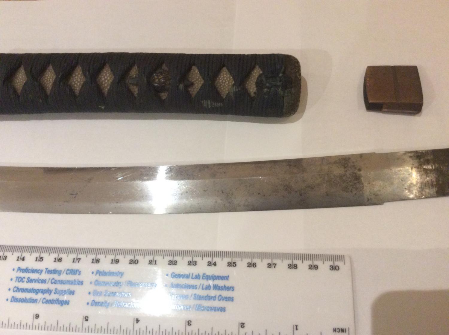

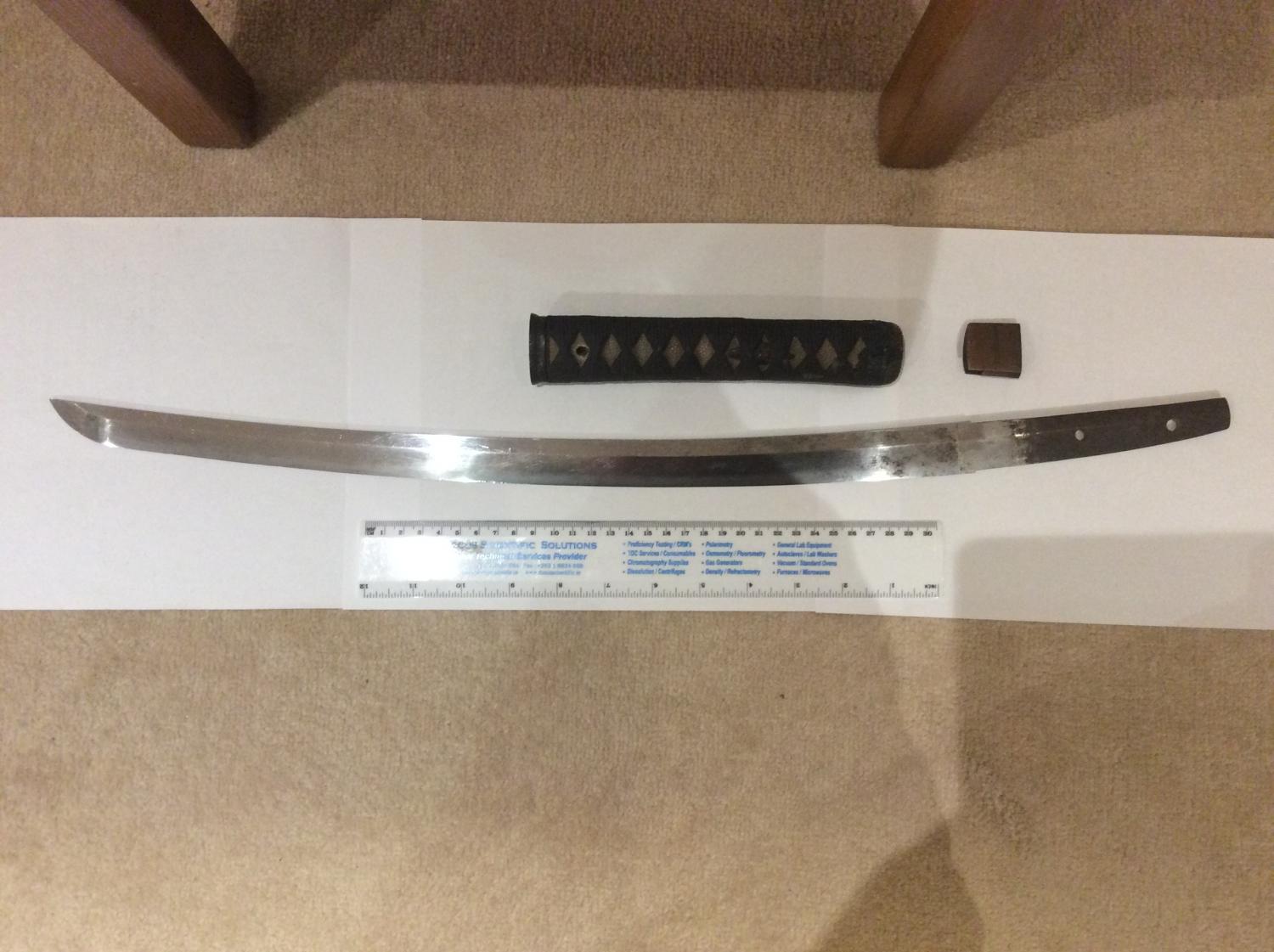

I just got this Wakizashi in a job lot of swords
I know nothing at all really about it I am not into it for much cash so no need to hold back on the comments if it’s all bad news.

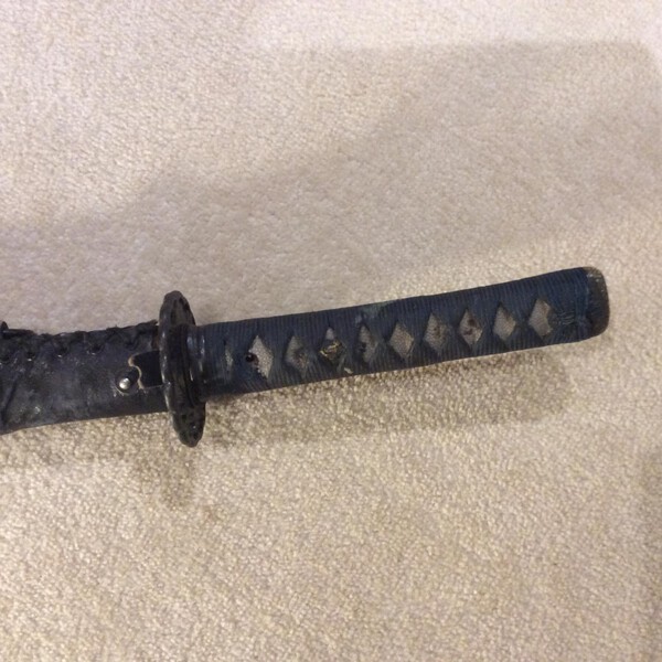

The scabard is leather covered timber and there is a stud fastener to stop sword falling out, half popper is missing though

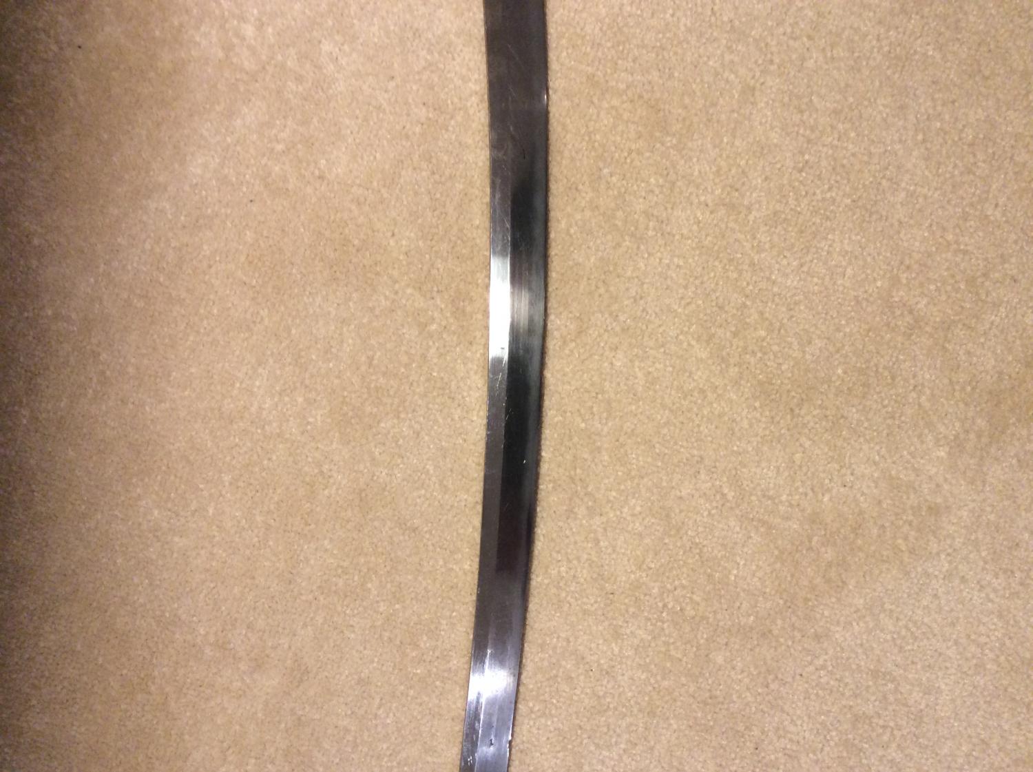

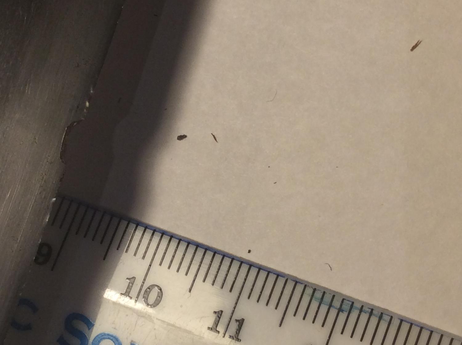

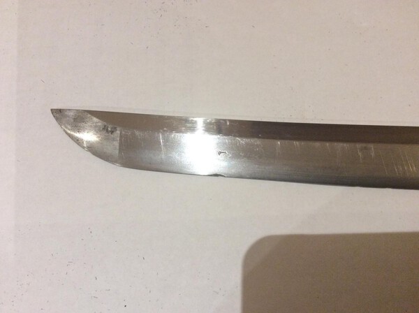

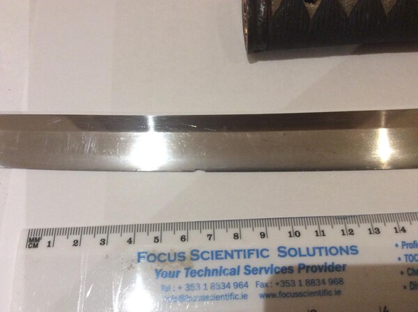

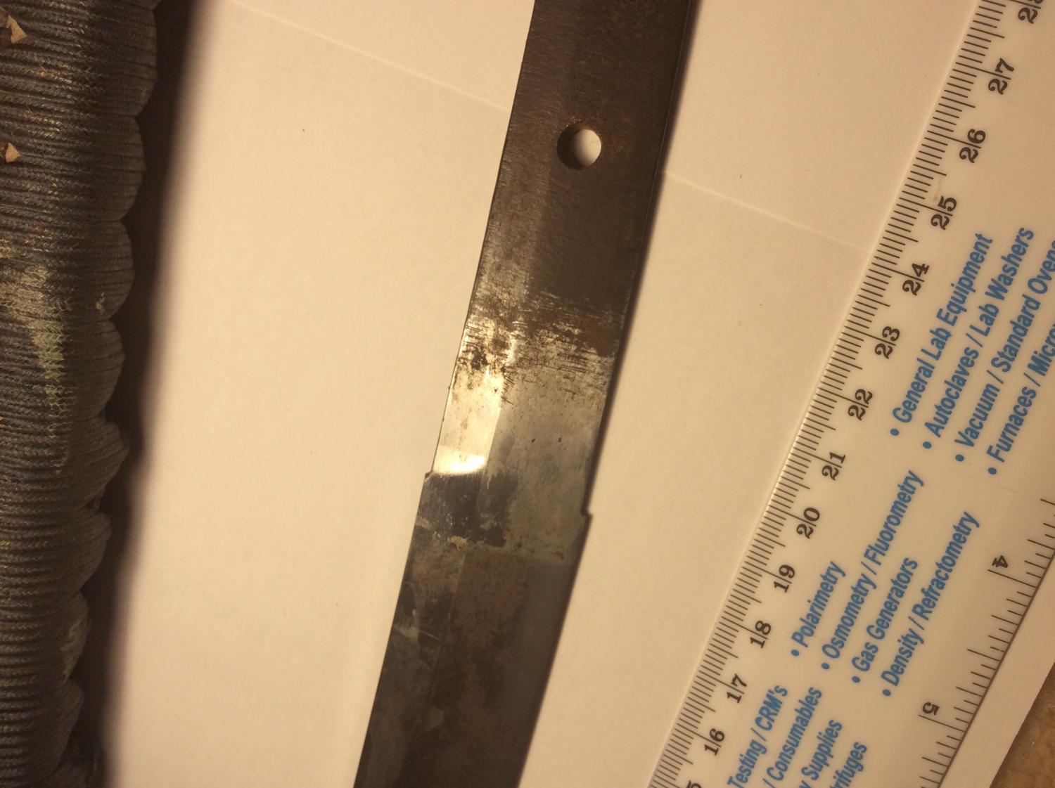

20 inch blade with a chip but it is not too deep, 2 mm or so . Blade has visible hamon for the full length not sure if it will show in pictures
Blade is in ok condition with some discoloration

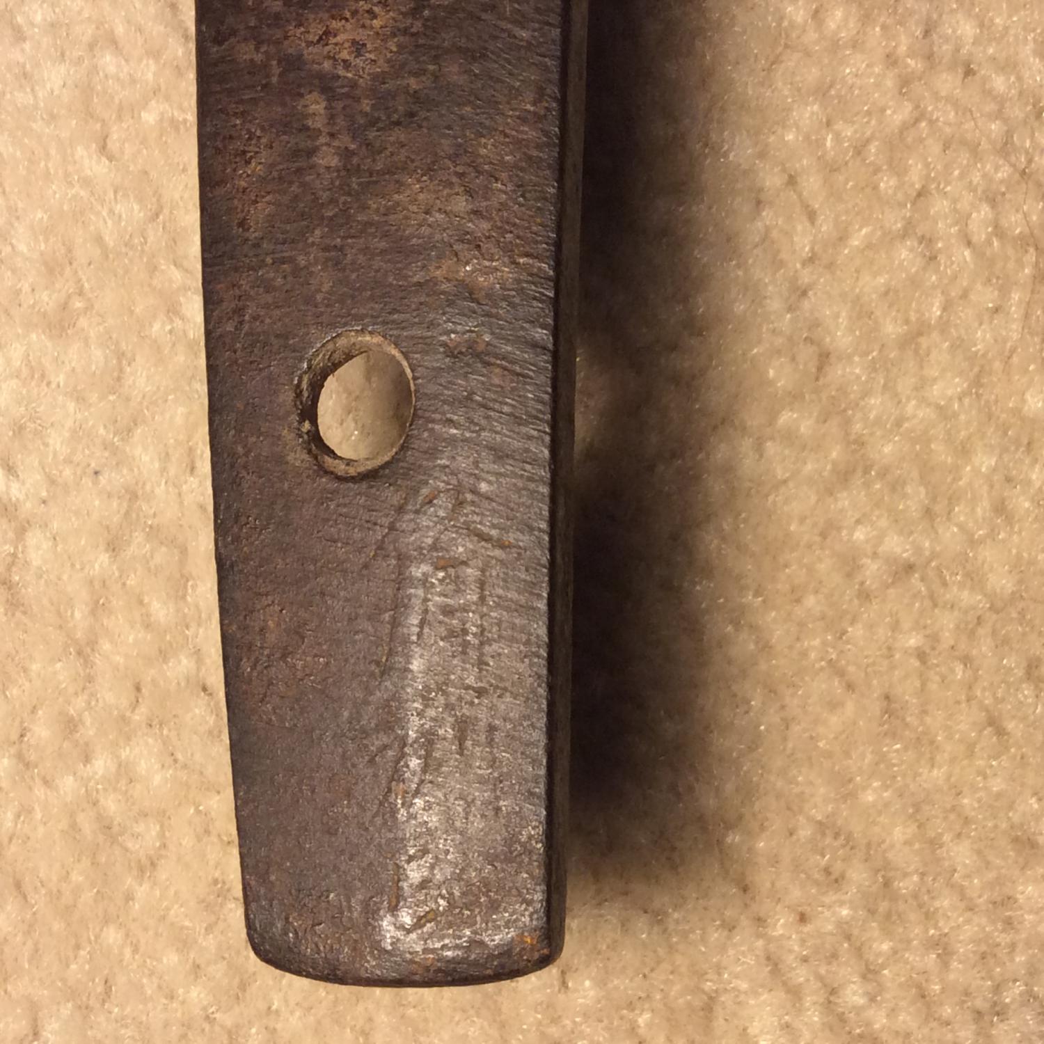

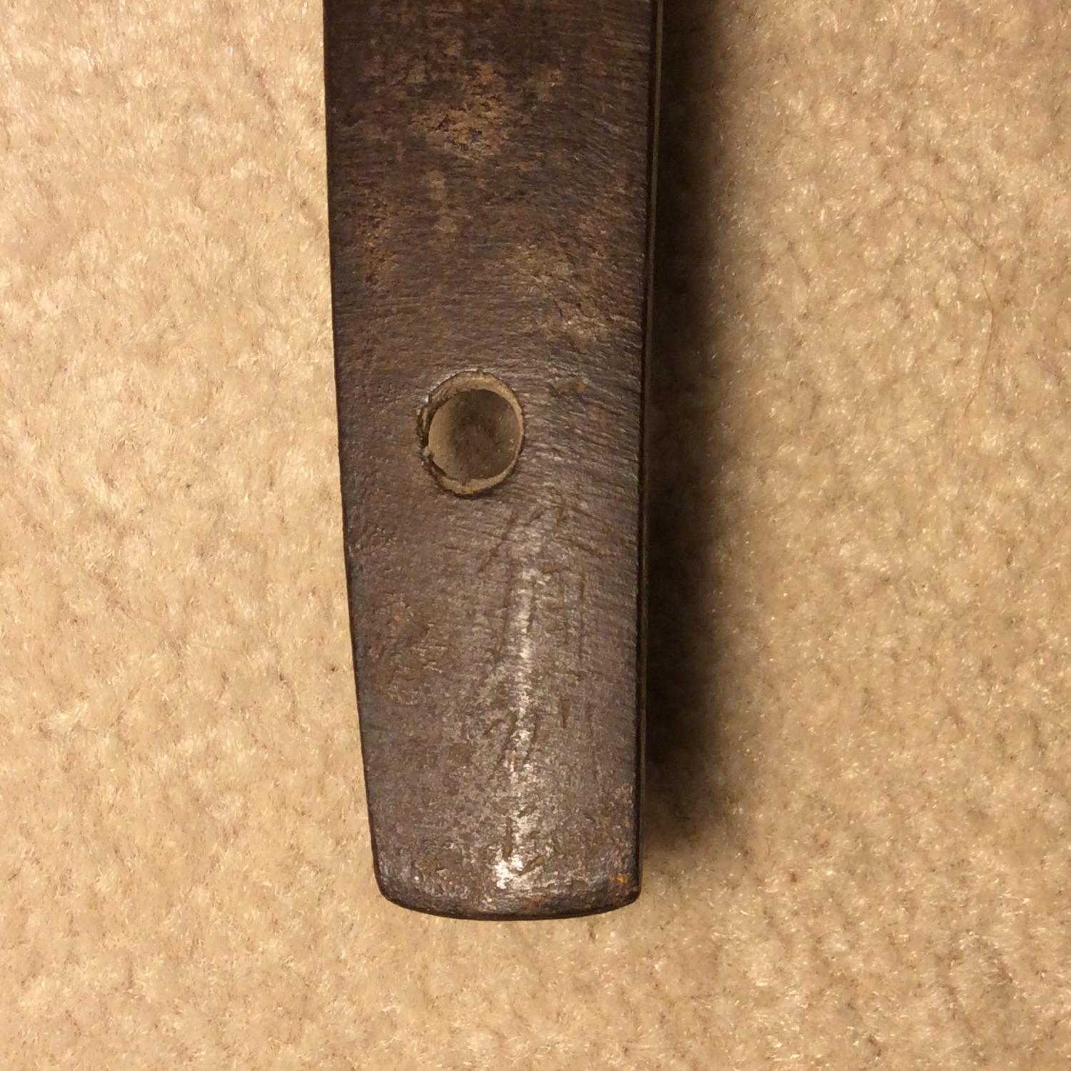

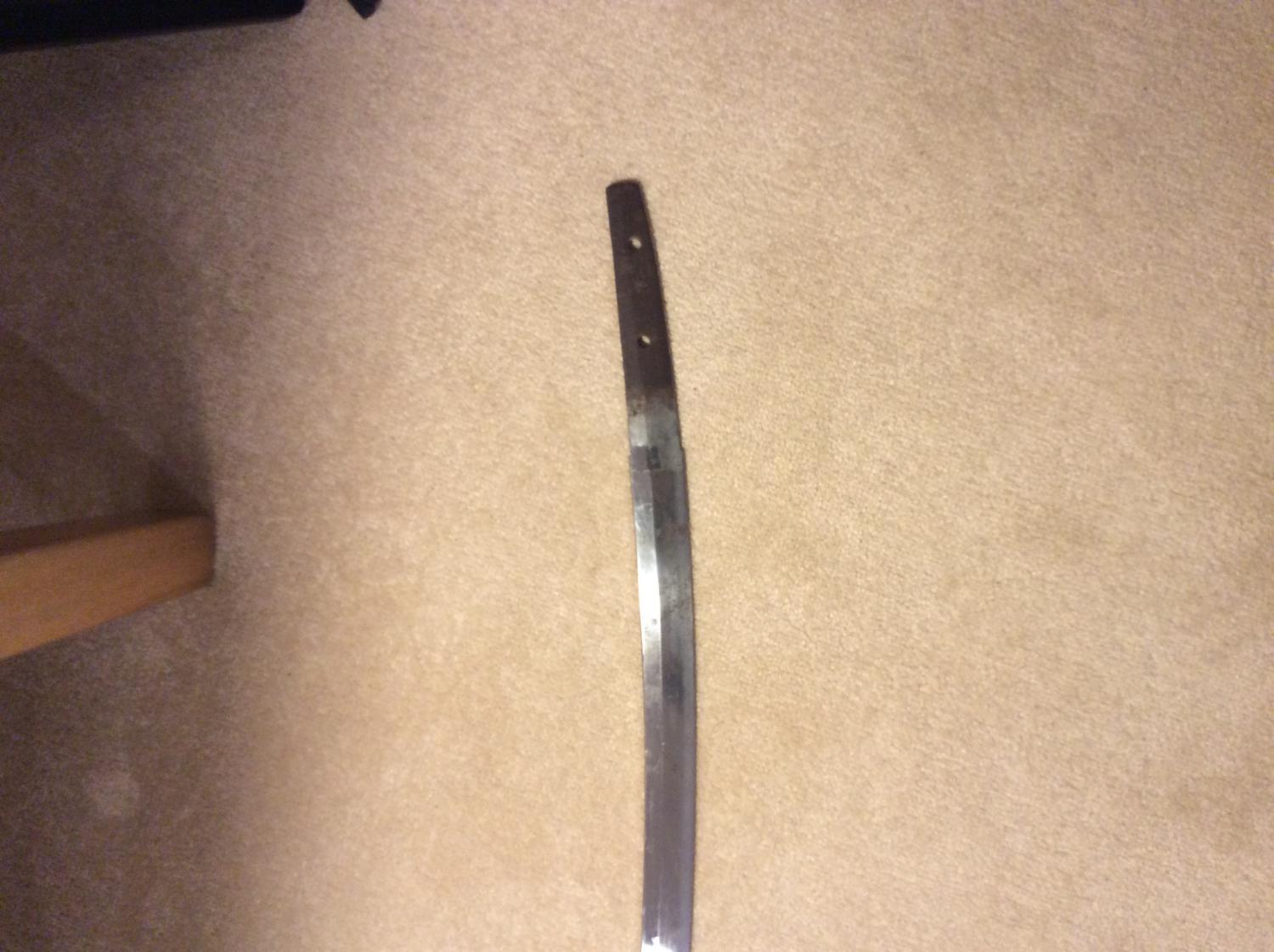

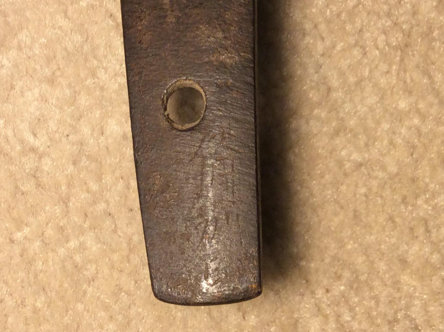

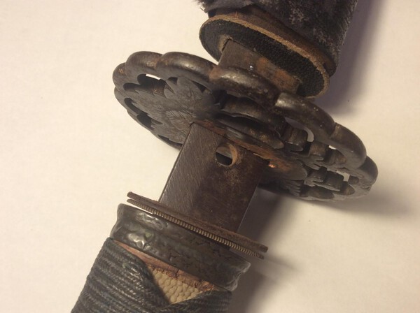

The tang does have a signature but I think it has been cut at some stage in its life

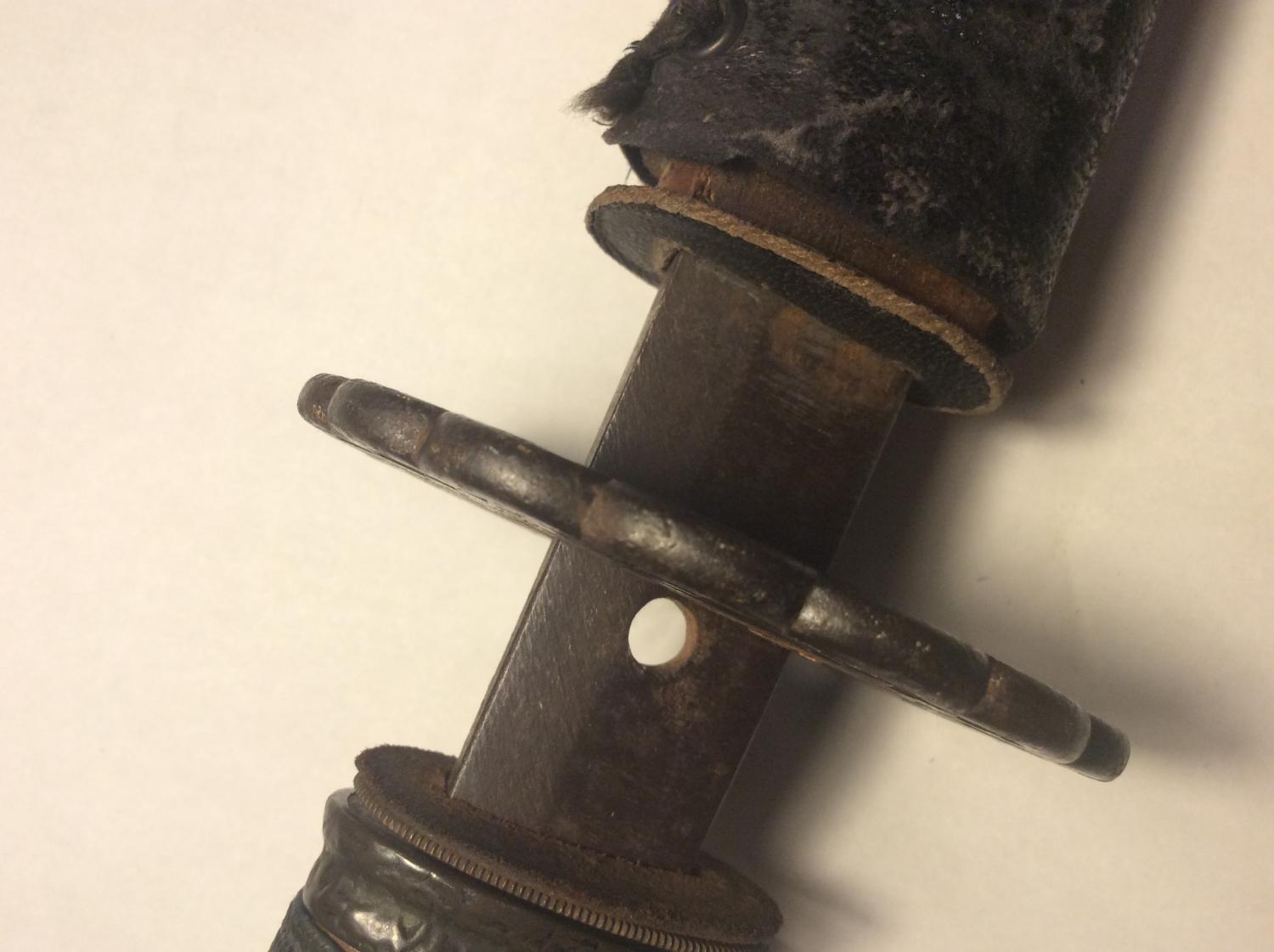

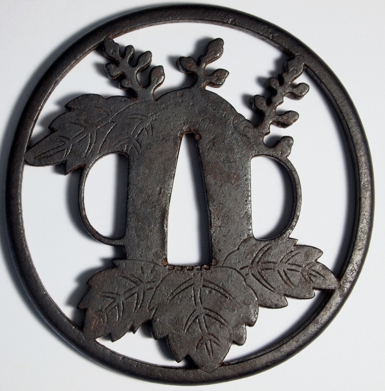

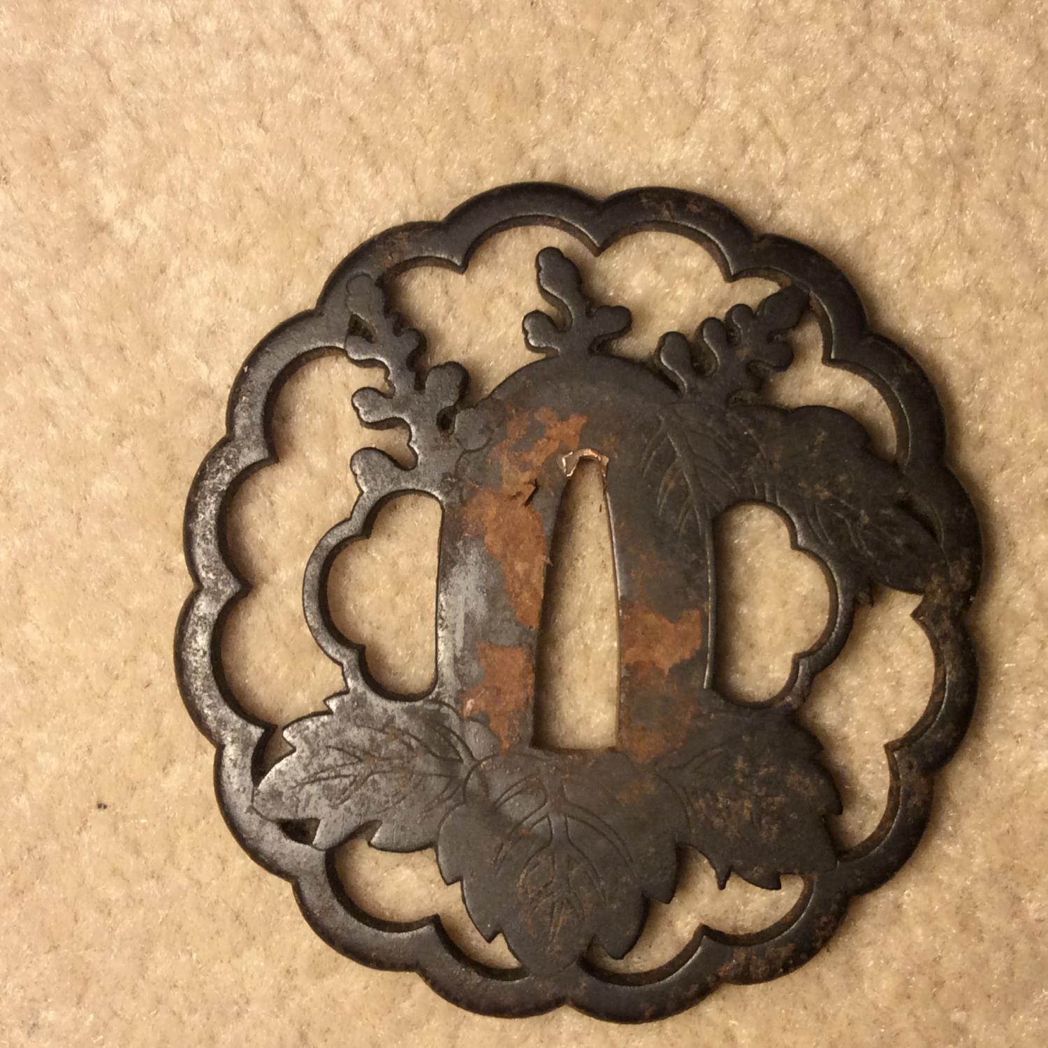

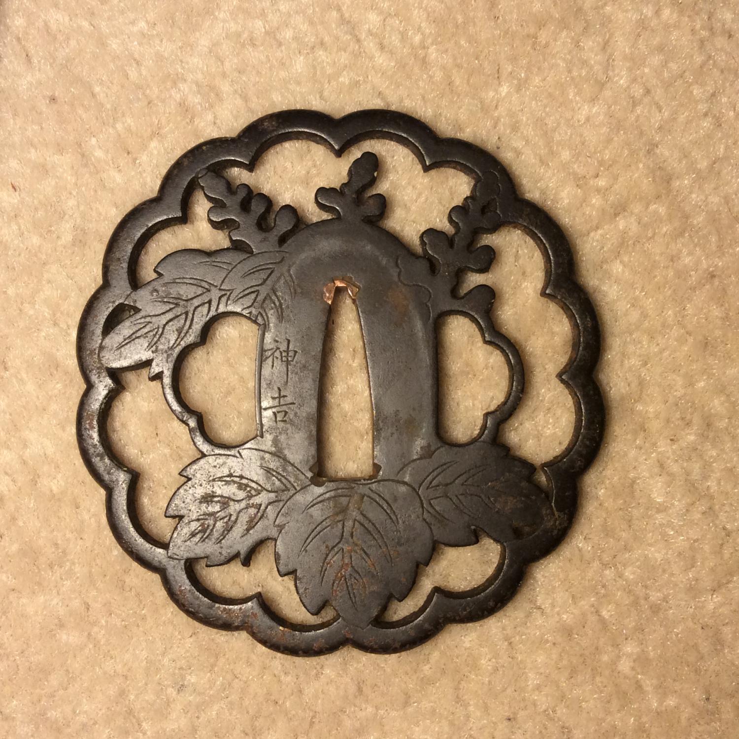

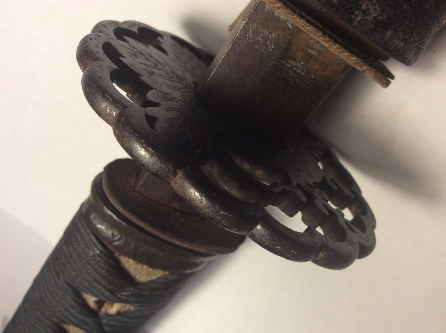

There is a mark on the tsuba which is quiet clear hopefully I have photographed it right way round
Any chance the tang markings can tell you anything or the markings on the tsuba
I would love to have an approximate period of manafacture.

Dear Ken.
It's late but I think I see Bishu and the start of Osafune on the sword.  This would suggest a Bizen blade.  Read up on care of this.  The tsuba is interesting and appears to be signed Kamiyoshi.  Out of my comfort zone but go slow on this and careful, that's a good name.  Higo tsuba ko which goes well with the Higo style mounts on the tsuka.  Better pictures of the  rest if you can please.
If nothing else this is an interesting find, I think you did well here.

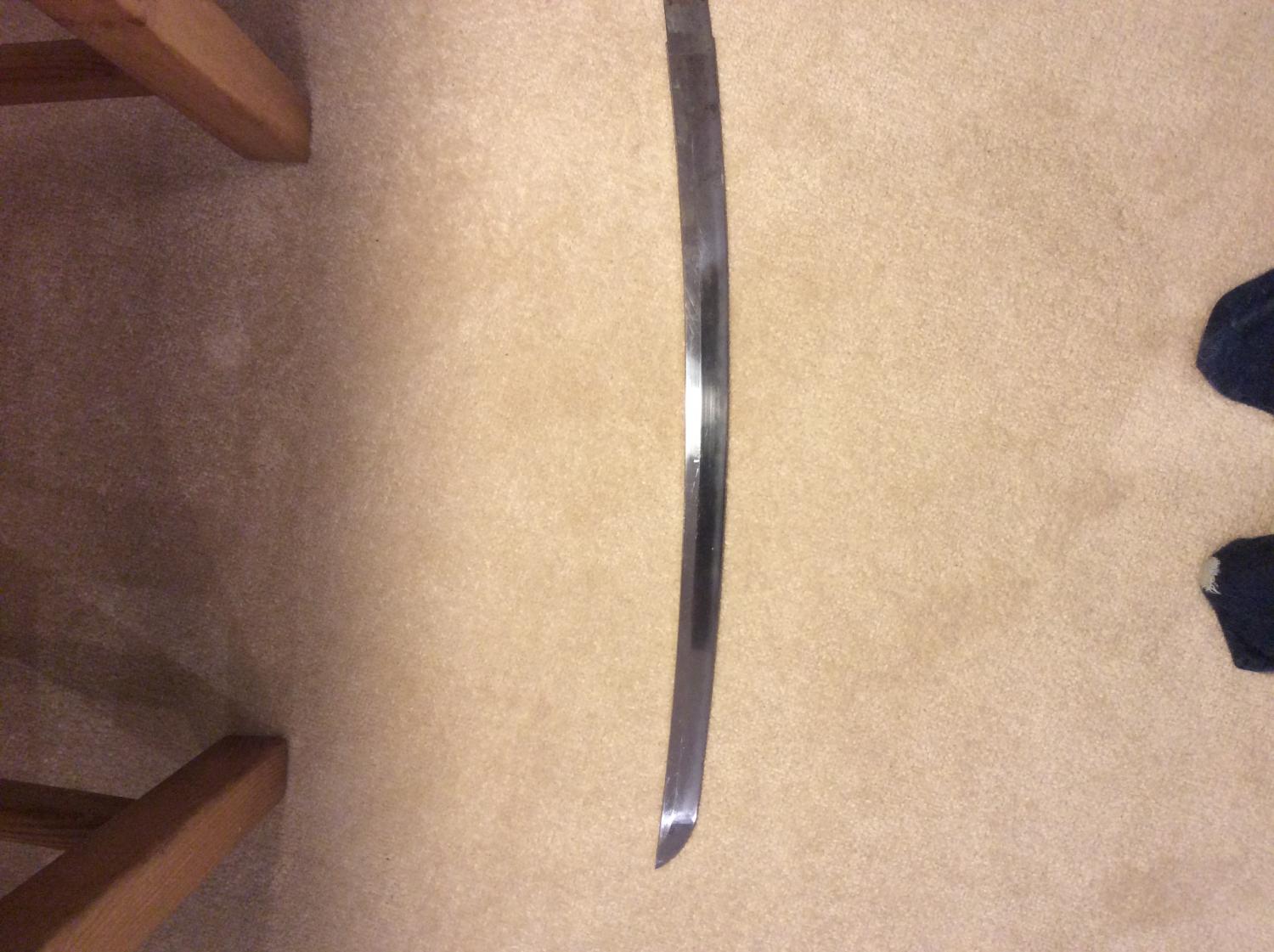

If you can get a good overall shot of the whole blade, tang included that would help.  First impressions would be that it's probably late Muromachi.  Swords signed as this one starts are very common from Bizen smiths of this period.  Most of them are regarded as mass produced blades and do not rate very highly, as almost all the details of your blade are obscured it will be very hard to tell a great deal more about who made it.  Have a look here for a good example, https://www.aoijapan.com/wakizashi-bishu-osafune-sukesada

Maybe nice to know...the paper (or what's left of it) on the tsuba, is/was there to get a good tight fit.
I guess the tsuba will now rattle a bit. A new piece of paper (acid free) will solve that.

It does look like paper that is atached to the tsuba alright, but I will not try and remove so don’t worry.

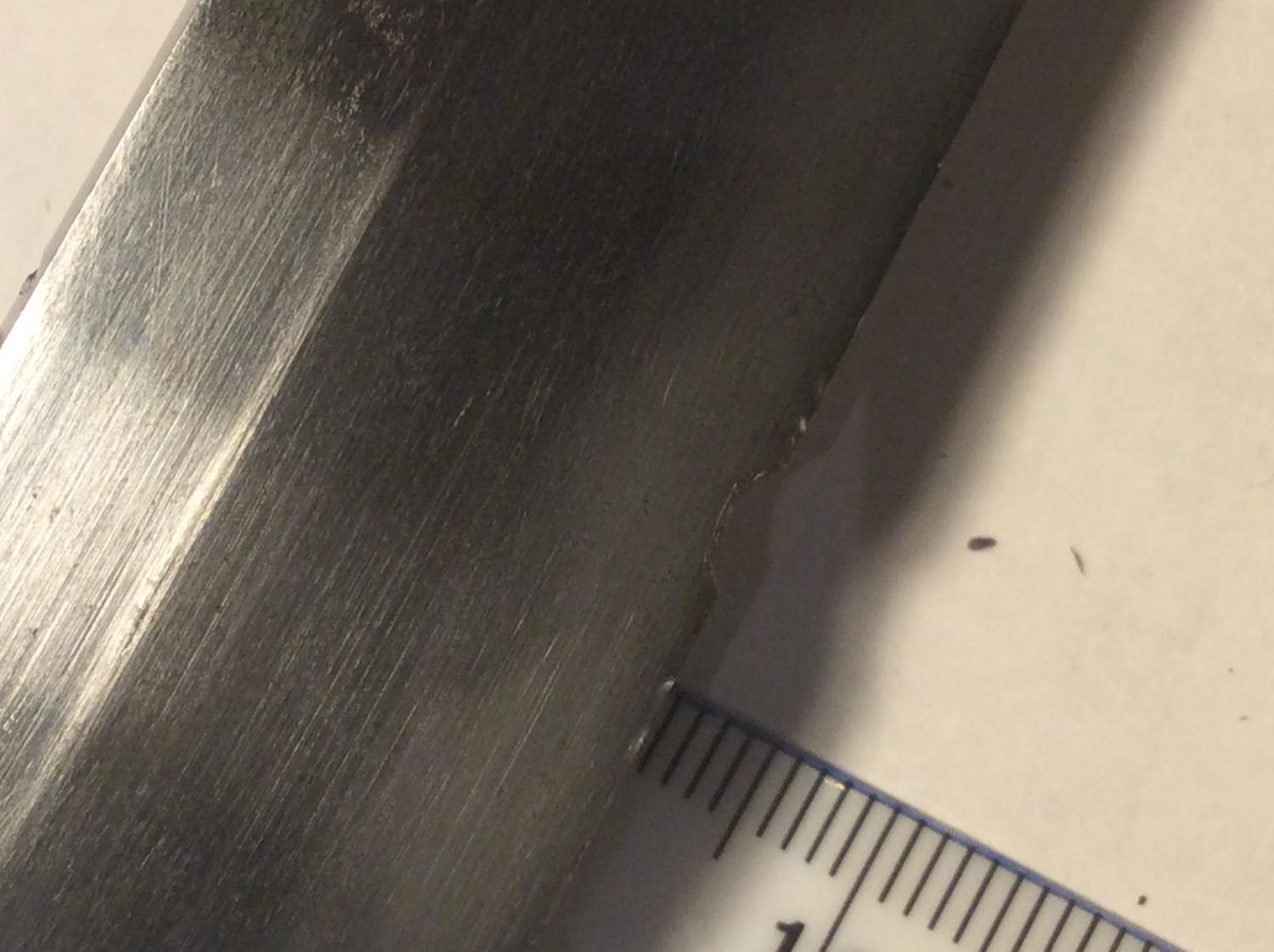

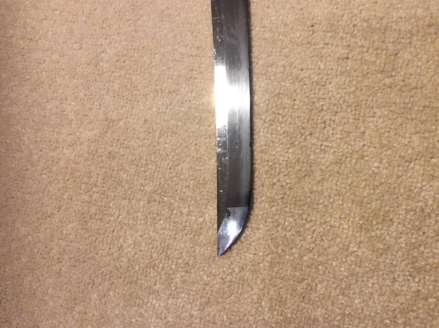

I have taken some more pictures you can see the few delaminations and the chip in the blade, it was this damage that enabled me to talk down the price

What I can see of scabard neck looks nice as well but it is covered in a leather outer scabbard which is laced closed, I think if I tried to open the lace it would tear. Might there be anything of interest under the leather.

The edge on your tsuba isa the same as my (Higo) Nishigaki example so that is my guess
An earlier discussion:
http://www.militaria.co.za/nmb/topic/9704-nishigaki-school-tsuba/

From what I can see, there appears a faint partial signature on this short sword. Maybe someone else can help with that.
The blade looks like someone used it to chop the hedges a few times.

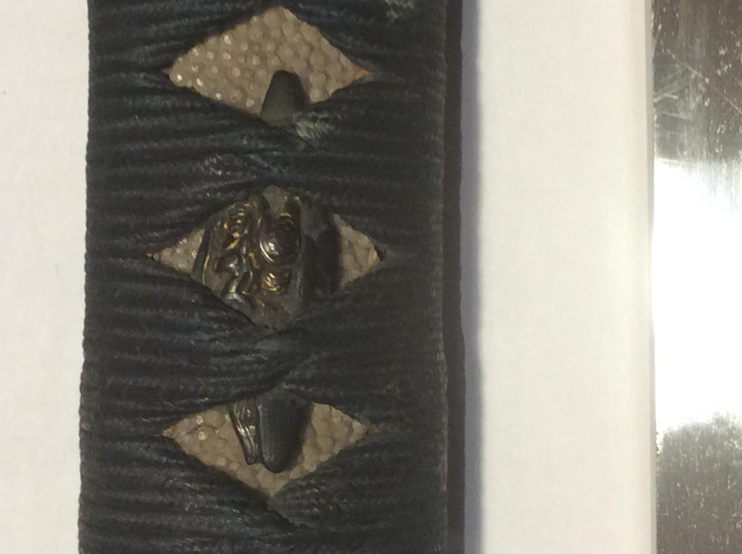

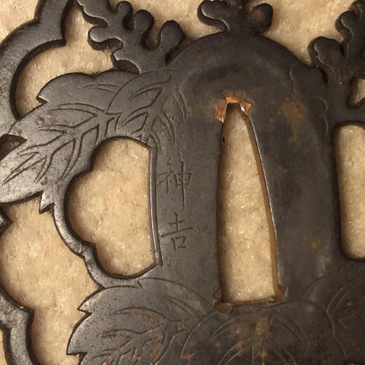

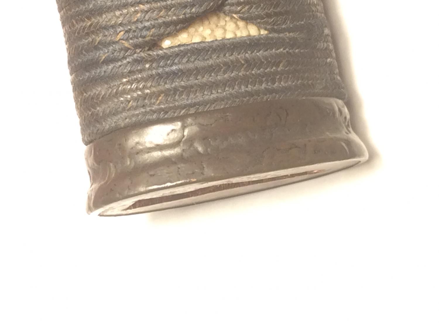

The fittings:  The tsuba, fuchi, and kashira all look Higo.
The tsuba is signed Kamiyoshi and looked very Kamiyoshi school to me from design, dimensions, and carving. If it looks like a duck and quacks like a duck, then probably a duck.
If someone wants to try and pin it on a particular smith, maybe they can. Without a signature or the punch marks used by some, I would just leave it at Kamiyoshi school for now.
Of the Higo schools, there are the 4 original ones and Kamiyoshi being the +1 added when they thought the Hayashi school was dying out.
Given the resurgence of the Hayashi school, I regard the Kamiyoshi as the sort of spare tire of the bunch- producing mostly in the 1800s as a background to the other Higo.
I confess that Kamiyoshi school is the one I tend to avoid, as I am not crazy about the 1800s works unless the design interests me.
Still, this is a nice design and is pleasant to me.

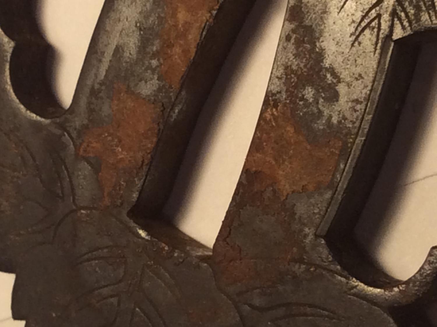

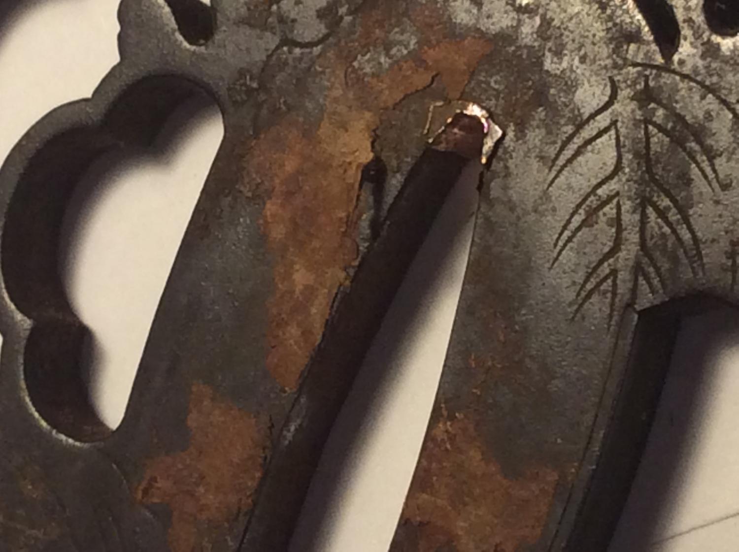

I hesitated to comment yesterday because condition is rough. Explaining this sort of news is rarely welcome.
A very good condition one with papers can sell for $1000 or so:   http://www.nihonto.com/rh460/
          This one has both patina and rust issues that it needs such Time and Tender care, I would pay $100-125 for it as a project to keep my hands busy.
Even then, the patina might require artificial help that I am not willing to do. It is sort of a gamble whether or not it will restore.
I think this is an example of the sort of beater sword that sometimes comes into a sword show and gets broken up:  someone buys the blade and the fittings get sold off individually.

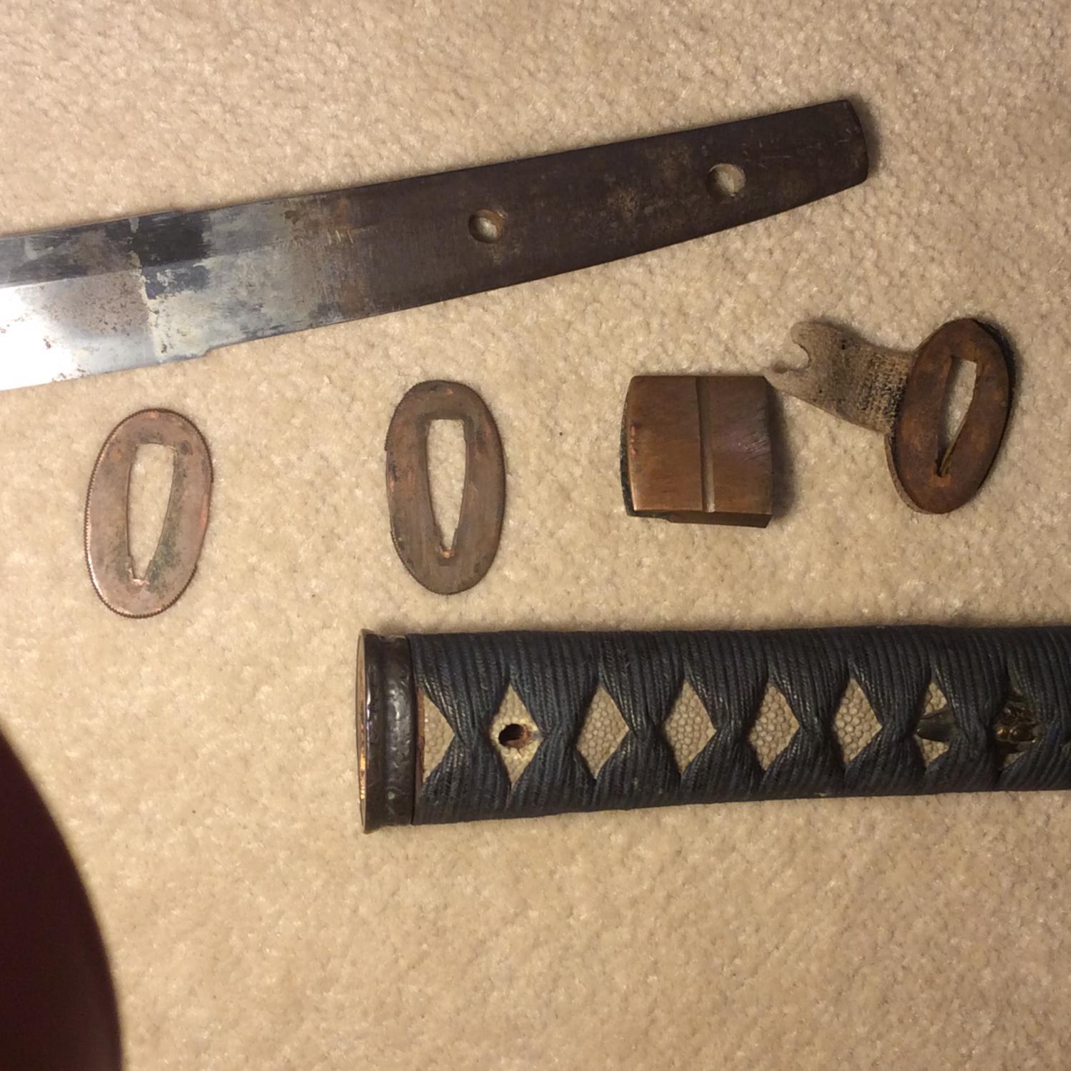

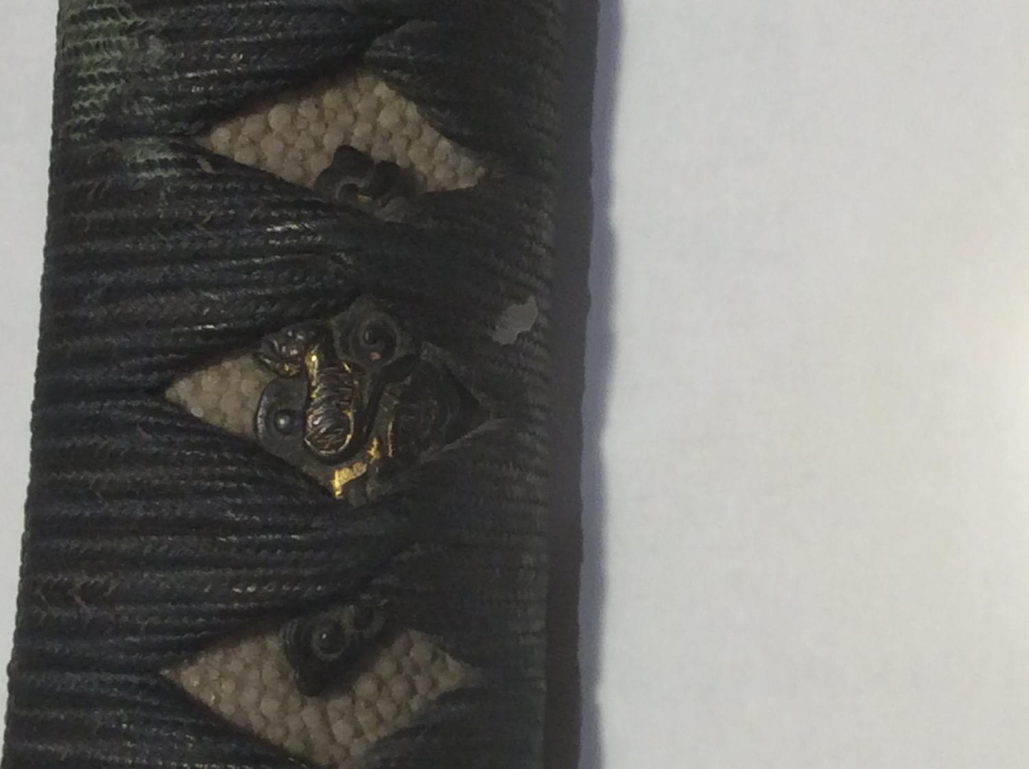

The fuchi and kashira don't look a pair to me, though the fuchi might be more interesting. I cannot really see the menuki.

One of my swords did have a nice saya under the leather wrapping but it's not worth trying to force if off (mine came off easily)

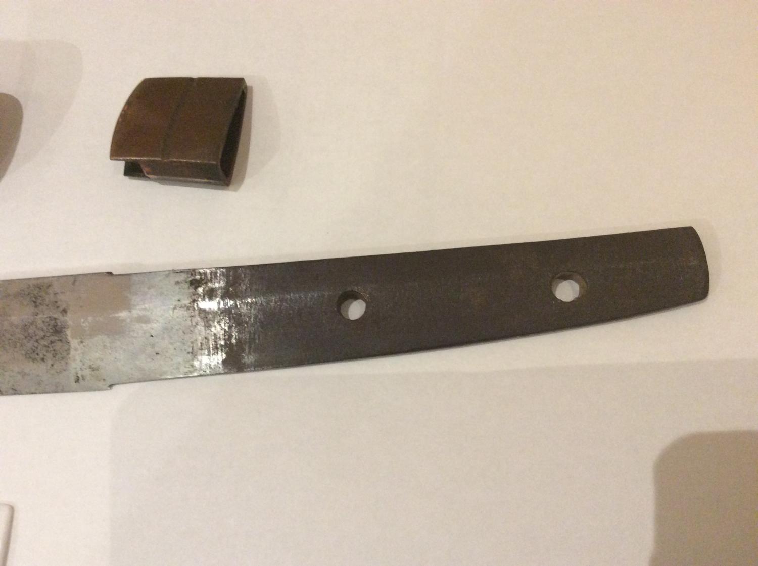

The sword looks to be signed faintly "Bishu ?" and the rest cut off.
It looks to be in the 50-60cm range, making it a long wakizashi or a greatly shortened sword.

It is a pretty tsuba in poor [but not 'dead'] condition.
As calming things to do when stuck working at a desk waiting on things, my wife sometimes knits. I sometimes pull up a magnifier and work on tsuba.
This Kamiyoshi is probably worth saving, but it is going to take a fair bit of work.
120 USD will buy you a crap Tsuba on most occassions - and this tsuba is NO crap as even a well known idiot like me can see at first glance.
If anybody does have more tsuba of that type at 120 bucks I'd be happy to sell my stocks and buy them in the hundreds .. you should sit down, clean it with some ivory ... if you decide to sell it, you may want to conseign it with some good dealer like for exameple Andy Quirt of nihonto.us whose site has allready been mentioned in this topic. Andy is one of the best places to buy quality Tosugu and always honest in his dealings.
The sword is solid but probably Muromachi around 1500 - 1550 ... Suriage. Blades signed Bishu are often inferior to the ones signed Bizen ... but this has of course to be evaluated on a case by case basios. The nicks are none fatal but deep enough to reduce the width to a significant degree. Also there is one Ware. I'm not sure if I would get it polished. Probably not. Atleast I would want to keep a tight budget on it and make sure not to put a Mukansa priced polish on it. The Chohji Hamon will probably look nice.
Fact is the tsuba is a better find than the wakizashi which is average.

Hi Curran
Thanks for that, i don’t see an obvious signature on the one you have put up. Maybe it is there just I don’t see it.
Does this matter or is it all about style of work.
Basic question here, is the one I have signed to an individual or to a school and what age are we talking about.
