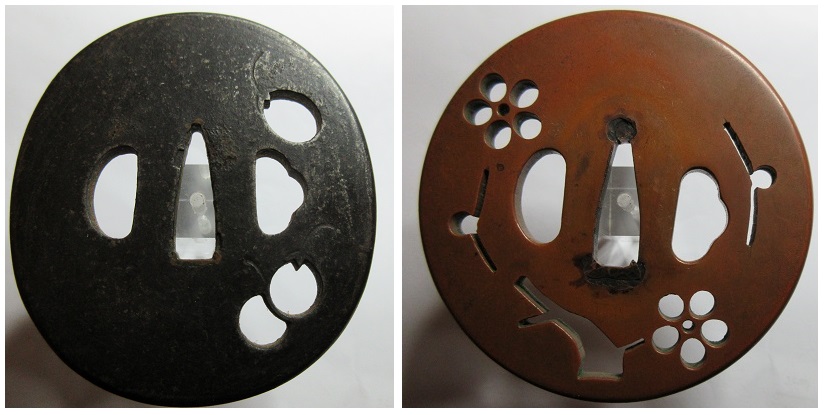

While I keep my wallet closed for a nihonto until I learned much more...collecting some tsuba's won't do any harm.
I like simple sukashi designs most. For now I stick to the more affordable tsuba's not to make expensive mistakes.
Like nihonto...I have a lot to learn about tsuba's also. :unsure:
1. Forged iron. 7,4cm, 6,7cm, 3,9mm.
Seems to be folded since it has a crude dasmascus like surface and the mimi shows many layers.
The fruit might be loquat (awe 枇杷) or Japanese apricot (ume 梅).
It looks a bit small for a katana, so I guess this is a wakizashi tsuba.
No idea about how old this is. Tosho school perhaps?
I payed 32 euros for it on ebay from a Japanese seller.
2. Copper or copper alloy. 7,8cm, 4,7mm.
Crude sukashi blossom (plum?), wagasa umbrellas and a branch.
Probably not old(?), but it seems to be a honest used (sekigane made to measure and the "shadows" of used seppa) tsuba.
About 55 euros, same seller.
Information and comments will be appreciated.
Thanks,
Robin
No. 1 Bushū-Itō school, late Edo, depicting 3 oubergines (三茄子透 - mitsu nasubi sukashi). Often those tsuba have very faint inscriptions, so check thoroughly if a mei is present.
No. 2 probably Meji or later, depicting a prunus branch (枝梅透 - eda ume sukashi); the supposed straw hat should be part of a branch with a blossom bud.
Just my opinion.
Bye, Mauro

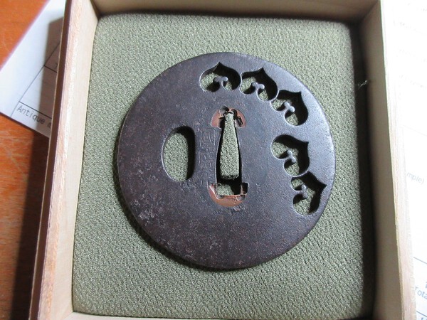

Today I received a tsuba I was looking forward to, simply because I like it a lot.
Aoi leaves sukashi (please don't say I got this one wrong also :()
71mm, 3,5mm, iron. Signed 國廣作 Kunihiro Saku.
From Matsukaze.Japan on ebay. The tsuba box came as an unexpected surprise with it.
Maybe, because my $157,50 winning bid came as an unexpected surprise to the seller.
Anyway...I just wanted this, so when it's a bit over the top...no regrets. Feel free to facepalm! :roll:
And now about this Kunihiro mei. I stumble upon this name really often, both tsuba's and swords.
I found 10 Kunihiro sword smiths. Were the tsuba's produced by these smiths or in their workshops, or is this a coincidence?
Robin
Hi Robin,
looks like aoi leaves to me too. Nice theme and the execution looks quite good.
I once heard a theory, that tsuba signed Kunihiro were forged as blankets and a different artist added sukashi or inlays later to finish it. Whether it was a workshop or if there was a connection to the sword smiths, i do not know.

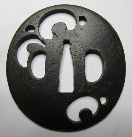

My latest on the other hand has a faint mei. Looks like 2 kanji, but most of it faded.
71mm, 67mm, 3,5mm
The sukashi? Please help me out...I have no idea.  :dunno:
