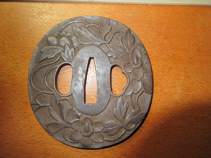

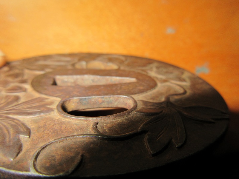

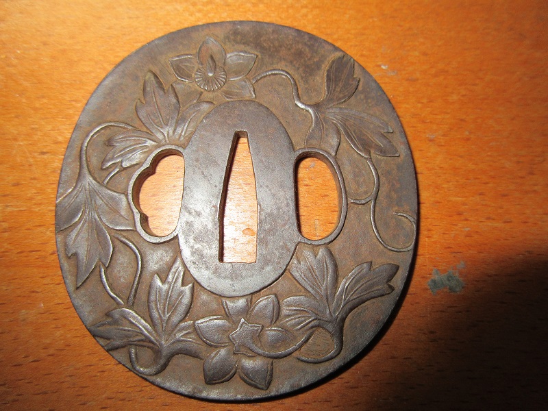

Hello guys,
This was my first tsuba and I'm not sure about it.
77mm,  71mm, 4mm. Iron.
post-4355-0-72349300-1514512988_thumb.jpg post-4355-0-04718200-1514513001_thumb.jpg post-4355-0-55558100-1514513015_thumb.jpg
I hope it's at least Japanese rust. When it is...any information about it will be appreciated.
When it isn't it's a newbie lesson learned.
Thanks,
Robin
Late Choshu?
Seems perfectly fine to me. Better than many beginners first tsuba.

I think the realistic (lotus flowers?) design is what made me worry, the lack of sekigane and tagane ato didn't help either.
I presume this is a cast tsuba? Since it was covered with old wax, oil or god knows what I boiled it in water.
It's clean now and the rust seems superficial only, but I better leave it as it is I guess.

Sorry to be the nay-sayer but to my eyes this looks like a fairly modern piece. It's clearly emulating one of the Choshu groups in style, as Curran pointed out,  but it's not the work of a professional Edo period tsuba-ko in my opinion.
The design itself is interesting for the fact that it isn't really typical for the Choshu group the actual technique is attempting to copy. The design feels more like something we see on certain types of Heian-jo brass inlay works.
Hi Brian
it's carved, but if you the look at the actual technical skill in evidence you might begin to notice many awkward spots and 'missteps'.  The nakago-ana itself, is poorly shaped too.
Overall it's a fair attempt at classical work using traditional tools. I see evident of the maker having used a hisage ( a scraper) to smooth the craved surface. In the stems and tendrils, in a few spots there are little ripples left, this tells me the maker wasn't completely proficient in the hisage's use. Used heavy-handedly it will leave chatter marks, those ripples I see.

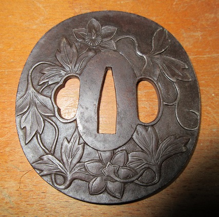

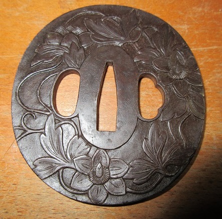

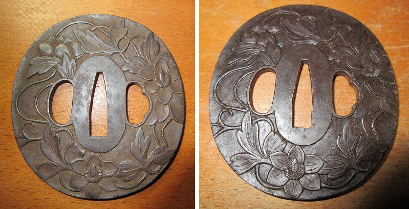

After the previously posted photo's I noticed there was still a lot of rust and grime left. Boiled it again and spend most of the day with pieces of ivory from an old domino game cleaning the tsuba (or tsuba shaped thing). In between removing the scraped off rust and dirt with Blu-Tac.
After a drop of choji oil and a good rub...this is the result:
post-4355-0-71080600-1514583537_thumb.jpg post-4355-0-46187500-1514583546_thumb.jpg
It's original choclate brown patina wasn't damaged and no more red rust.
Before and after...
Thanks,
Robin
The flower depicted is clematis (tessen - 鉄線), quite common in tōsōgu.
I'm with the late Chōshū school hypotesis (very late Edo or Meji).
I'm sticking with that too.
For a supposed newbie, its good to see Robin has read up on how to strip off the old oil and go at it with ivory.
Having worked a piece like this before, the After photo looks as I would expect. I'll leave it at that.
