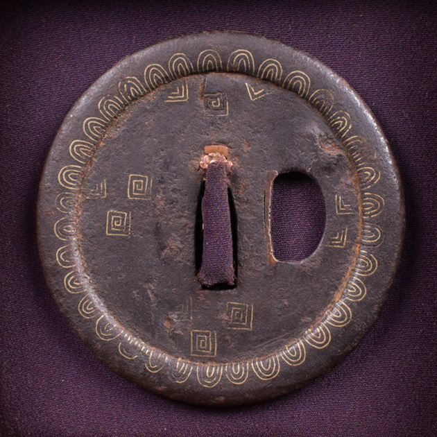

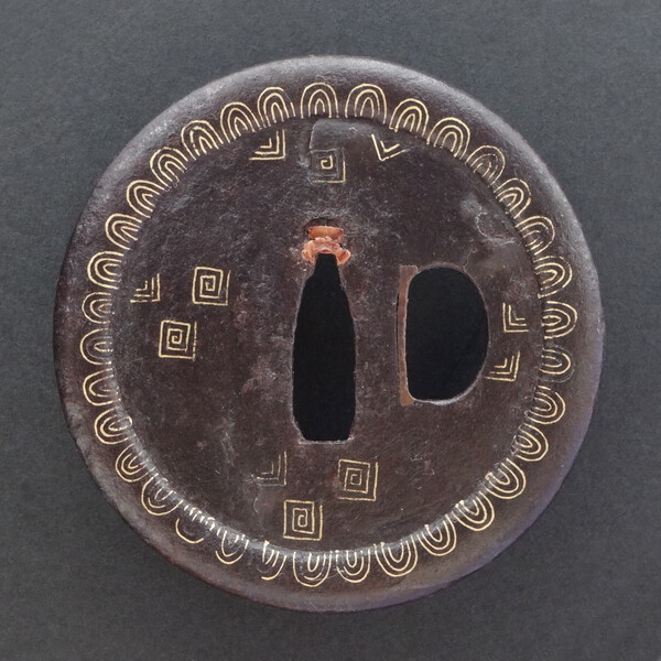

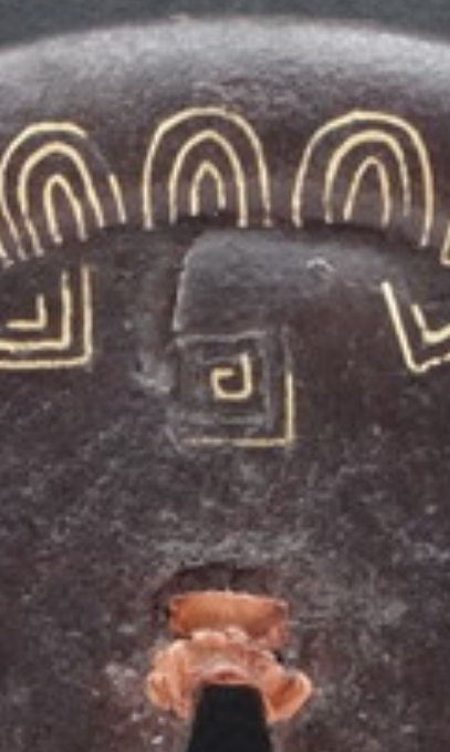

This maru gata tsuba have a chrysanthemum petals design the inner surface of the dote mimi and of scattered stylized lightling on the body of the tsuba (hira-ji). Both motives are inlayed in brass flush with the surface (shinchu hirazogan). The dimensions are 75.8 mm x 75.0 mm and a thickness of 4.2 mm at mimi.
I had it cheap on Yahoo Auctions because it was not in the best of conditions with a good deal of rust.
Though it cleaned up nicely, what do you think?

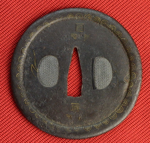

Based on one reference found in Otani
and a NBTHK Tokubetsu Hozon papered tsuba
I think that my tsuba can be classified as Heianjo Zogan.

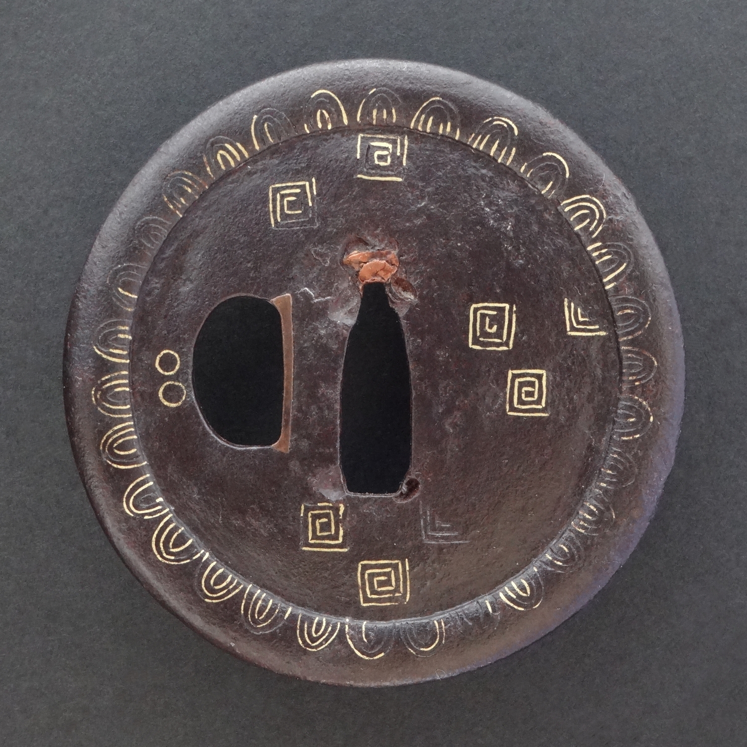

This tsuba shares with both references an almost identical design of chrysantemum petals on the mimi and with the second one the same stilyzed lightling design on the body (raimon). On the hira-ji of the omote side on the left of the kogai hitsu-ana there are two small inlayed circles
On the reference of Otani the same kind of inaly is also present close to the wave thus it could be probaly interpreted as droplet. In analogy the two circles of FT-0082 could be inffered to be rain drops given the presence of the stylized lightnings of the raimon.
As for the two references the hira-ji of this tsuba shows also a surface finish looks like ishime-ji to me (but I defer to your judgment on this).

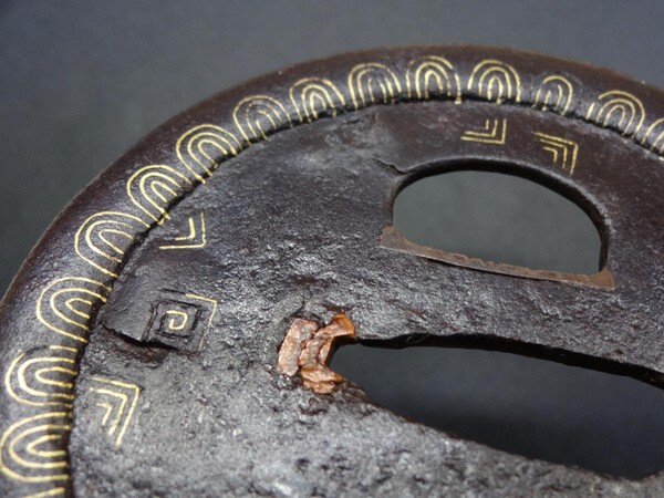

Close to the top part of the nakago-ana, on the omote, and on the edge of the kogai hitsu-ana, on the ura side, there seems to be traces of layering as consequence of folding and fire welding of the steel.
The patina is uniform and in very good conditions except of a few spots on the mimi and on the hira-ji and have a dark brown/chocolate color with red undertones when seen under sun light.

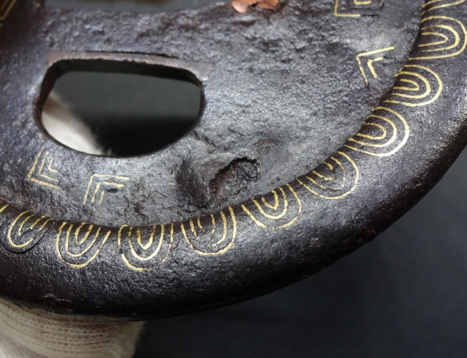

On the ura side hira-ji  there are three damaged areas (or so they looked to me initially) that seems, at a first cursory analisys, to have been subject to de-layering of the iron as consequence of corrosion or damages due to blows.
On this particular feature I would like to have the opinion of you NMB members, at first I mistook these regions as damages but on a deeper analysis I have start to wonder wether these can be an intentional part of the decoration.
The extent of the "damage" expecially the one above of the nakago-ana tip and the one close to the kogai hitsu-ana is so great that the surface of the "burst" part protrude from the surface of the iron by an extend comparable to the
thickness of the plate.
Given the extent of the protrusion one would have expected to find a cavity under the protruding region that is not there. There is no cavity just iron with a patina that is identical in color and texture to the rest of the hira-ji.
Damage from blows seems also unlikely in view of level of deformation of the metal on the ura and the absence of any trace of visible damage in corresponding spots on the omote side.
Could it be that those "damages" are rather made on pourpose as part of the ishime-ji desing of the hira-ji?
However if part of the desing why have them only to the ura side of the tsuba, visible only when the sword was drawn?
I am open and grateful, to any comment from more experienced NMB member on this puzzling, to me at least, aspect.
I have several dozen Heianjo & Yoshiro tsuba, but have seen none of the damage that yours exhibits. It almost looks like someone was trying to pry out a section of the brass inlay. I doubt that the damage was incidental, or part of the design, but real experts like Ford Hallam should weigh in on this.
Yes Pete that was my first thought too.
But what I have found so puzzling is that the blisters are not empty or full of rust. Upon probing their interior with bone splinters I found under a thin layer of rust the what look like the same metal of the hira-ji with what look like the same patina.

First off, maybe its the lighting, but your brass looks a tad bright - you gotta be careful when working on the brass itself While I've seen a couple of old "bright" ones (maybe its an alloy thing), typically un-messed-with ones (well, un-messed with for a while) brass has a patina (especially on work that would be binned as heianjo zogan). .  While  the wabi aesthetic was strong ( I think some losses were either "encouraged" or the pieces were actually made that way - more on that in a minute), the bubbles here look like a forging flaw that got water in it and 'bubbled"/corroded away.

-I like the square lightning and rain drop motif of the tsuba... wouldn't have guessed that was the intent before seeing this post.
-Great info on the corrosion factor from John B
-Delaminations of the plate for sure. You can see that two large flakes (outlined in red) have already popped off on the omote side.
429499685_Screenshot2021-11-09084040ab.thumb.jpg.47a0246caedabf1f74af099a09686c2a.jpg

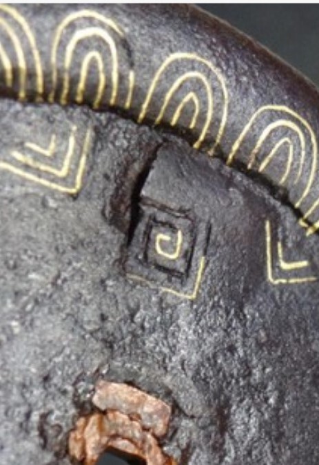

-That "nick" near the mimi at the top of ura side is a bit of mystery... looks almost like an angled chisel mark to me.
It appears to slope in from the left side side, but then there's a pretty straight edge on the right side of the nick.
Why someone would do that? I don't know... But that's what it looks like.
