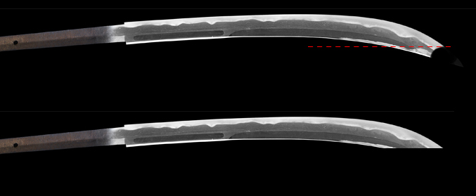

I have to say that I like the sugata of this sword. It is almost like what you would expect to see in a Satsu-age naginata, but clearly the sword was made this way (looking at the kaeri). I have not checked references, but would assume that the is gimei (for Nanki Shigekuni)...
Roughly speaking, this is what I mean by a satsu-age (repaired) naginata however I have no doubt that the example here has it's original sugata.

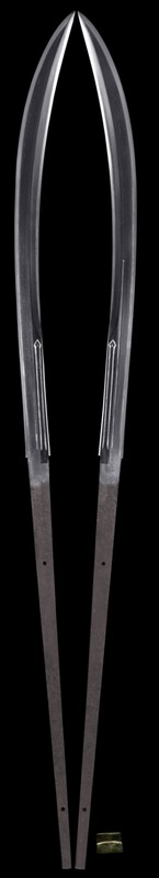

Moroba naginata are rare but I have seen a couple. Here is one which was discussed on the board previously...
Is there a ha on the mune in the monouchi?  It seems to be tempered there.  If so, it would be difficult to slide into the saya without either cutting the saya or dulling the blade.  I like it too.
