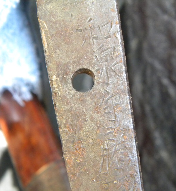

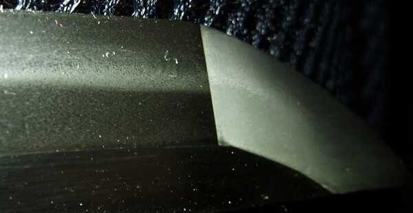

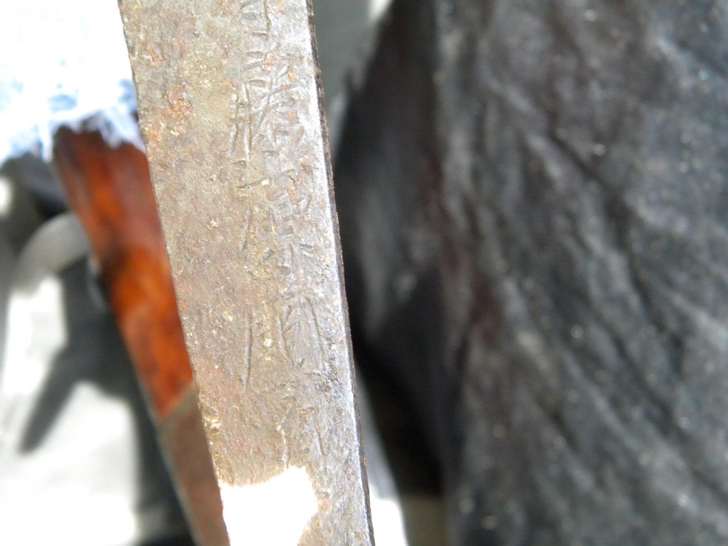

i was hoping for some expert opinions on a wakizashi with this mei izumi kami fujiwara kunisada. i believe
it could be a jishin mei done late in his career just before his son started signing daimei for him. of course

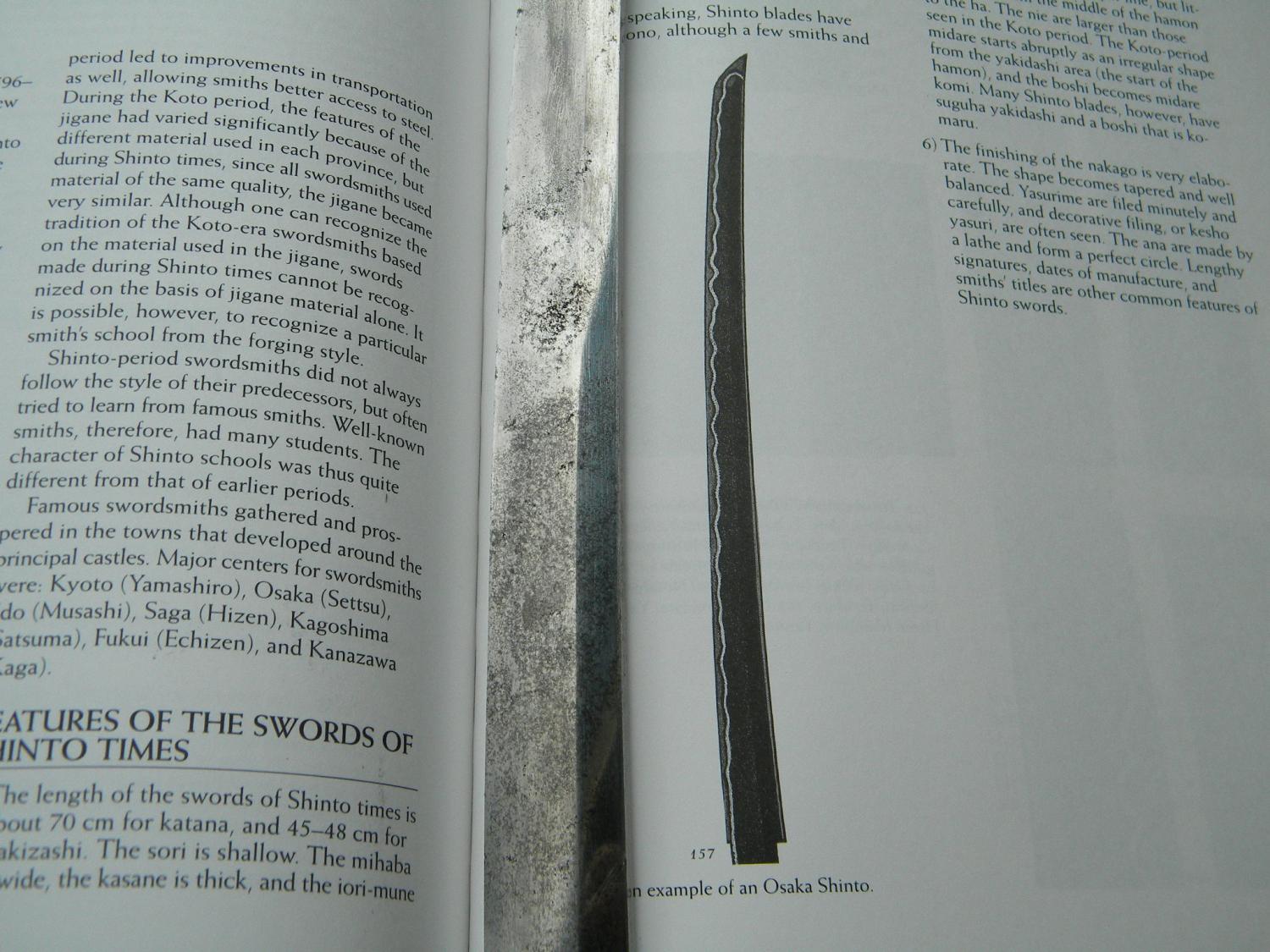

it could be a clever gimei. i've checked and compared the article by massey and wada and i'm not sure
of anything. what do you experts and amateurs say?
post-4260-0-79901500-1513193339_thumb.jpgpost-4260-0-61629800-1513193357_thumb.jpgpost-4260-0-79699900-1513228947_thumb.jpg

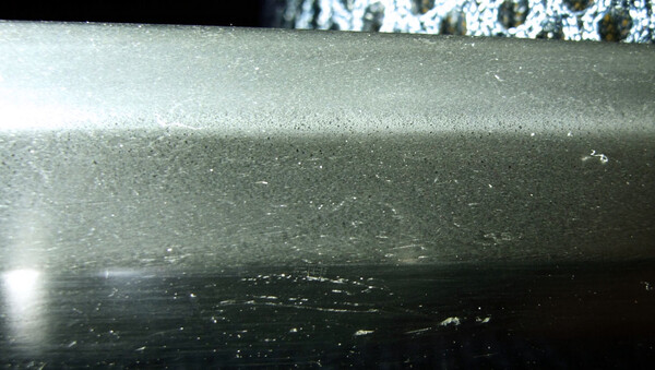

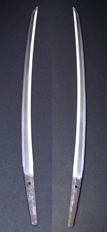

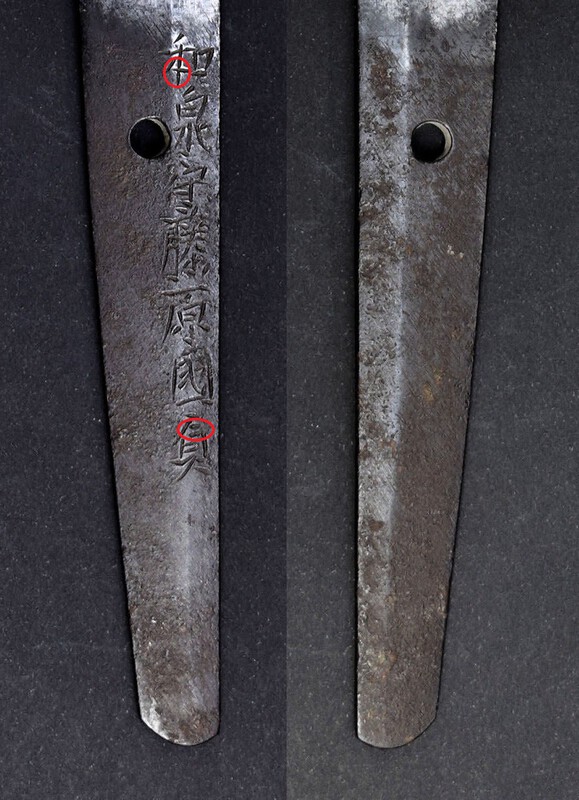

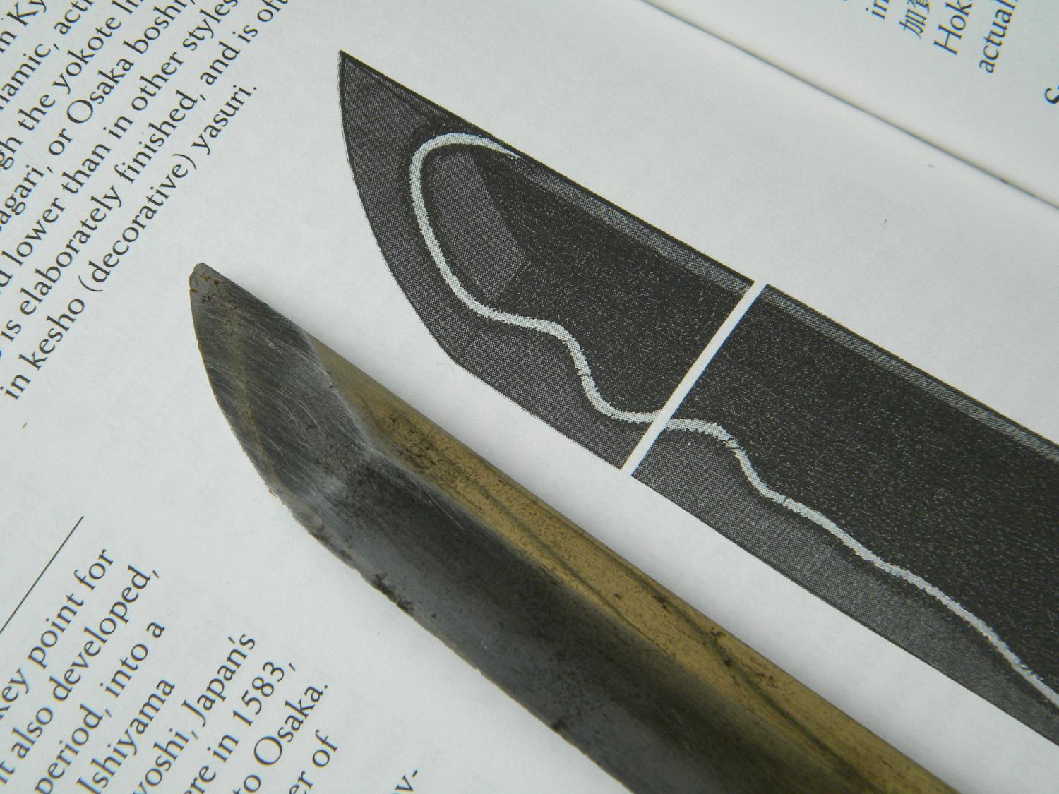

Pete,   Danny Massy's article is a good easy way to look at the mei.    If I remember right Kunisada's boshi and hada have distinctive characteristics.   Maybe you can take a good close up of those areas.  .  The  wakazashi shape, length and hamon look like a Oya blade,  Post some up close pictures and maybe a pro can give you more info.   I'd bring it to Chicago and submit it.    Here are couple pics of a possible good mei and reference book pics I have on the puter.
Best regards,
  Bob
it does seem out of character compared to his earlier mei... the third stroke, of the sada character which you point out,
looks to be pointed left to right. here's a very clean and clear shoshin oya kunisada jishin mei earlier in his career to compare.
I would still consider it a bit of a long shot, but considering he is viewed as the founder of the Osaka Shinto school and trained Inoue Shinkai, it is a big name and a hundred bucks is not that much to find out if it is good or not (that of course is the cost if it isn't good - if it is good, no worries about paying off the rest of the shinsa cost!).  Good luck with it!  Cheers, Bob
