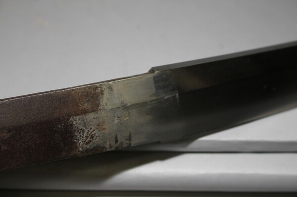

I have some really problems to judge a blade in age.
Hamfish shows today an ebay offer of a Gunto with "old" blade. The sword is sold, but i tried today to find out if this blade was a gendaito, a shinshinto or older blade. I didn't know.
The sword had some flaws, that is not typical for wartime gendaito. The shape is typical showa, in my eyes. But the nakago has a deep patina.
What is your suggestion about the period of this blade. If you could explain why?

As a start, look at the Hamachi and compare whats left of it to what you will see on a more modern blade, an indicator of a blade seeing a number of polishes.
Ps Chris, could do with dimensions, hamon appears to run into nakago.
original or not, the last time that nakago was messed with was no older than 1700 approx., but likely newer, judging by condition and patina.

Sorry but from what I can see I dont think this is very old. The patina on the nakago looks constructed rather than developed over time. Overall shape suggests gunto and the finish of the bade  looks Showa  but difficult to judge with this polish and images. I dont see anything that suggests older.

Looks to my eyes like a large kitae-ware. The uplifted layer of steel, separated from the body of the blade, shows better when the image size is increased.
there is a classic " temper-crack" here.....?
least, this picture looks like this....
shure to have a discussion on such?

I see that such a sword is not easy to judge. I hope I'm right that this is a traditionel, with tamahagene forged sword. Otherwise i must start new with my lessons in nihonto?
I see activities in the hada and the hamon.
And the sword is in Japan. I can't belive that a showa-to could be overlived and has a registration paper.
Looks to my eyes like a large kitae-ware. The uplifted layer of steel, separated from the body of the blade......
Yes, that is correct. Not a tempering KIZU, but a forging/fire-welding fault, which tells something about the quality and about the fact, that it is not signed. The smith knew exactly what he had produced!
If there is really HADA to be seen, the blade might not be GENDAI, but more late EDO. It is difficult to say only with photos.

some pictures from the ebay offer.
post-3496-0-73640100-1511355323_thumb.jpgpost-3496-0-75279500-1511355333_thumb.jpgpost-3496-0-87207400-1511355345_thumb.jpg
