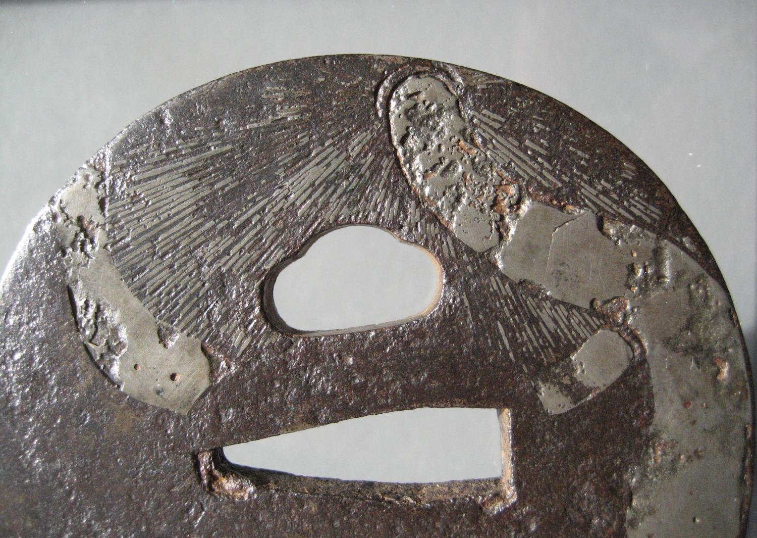

Hello,
I found tsuba with inlay like I never seen before. After going through my books I found just few similar examples (with Sahari in desription). But the book is black a white so I am not certain if this is the same thing...
Best Regards,
Krystian

It has that look of saharizogan, but is this actually zogan? more a nunome technique perhaps? John

No, not sahari.

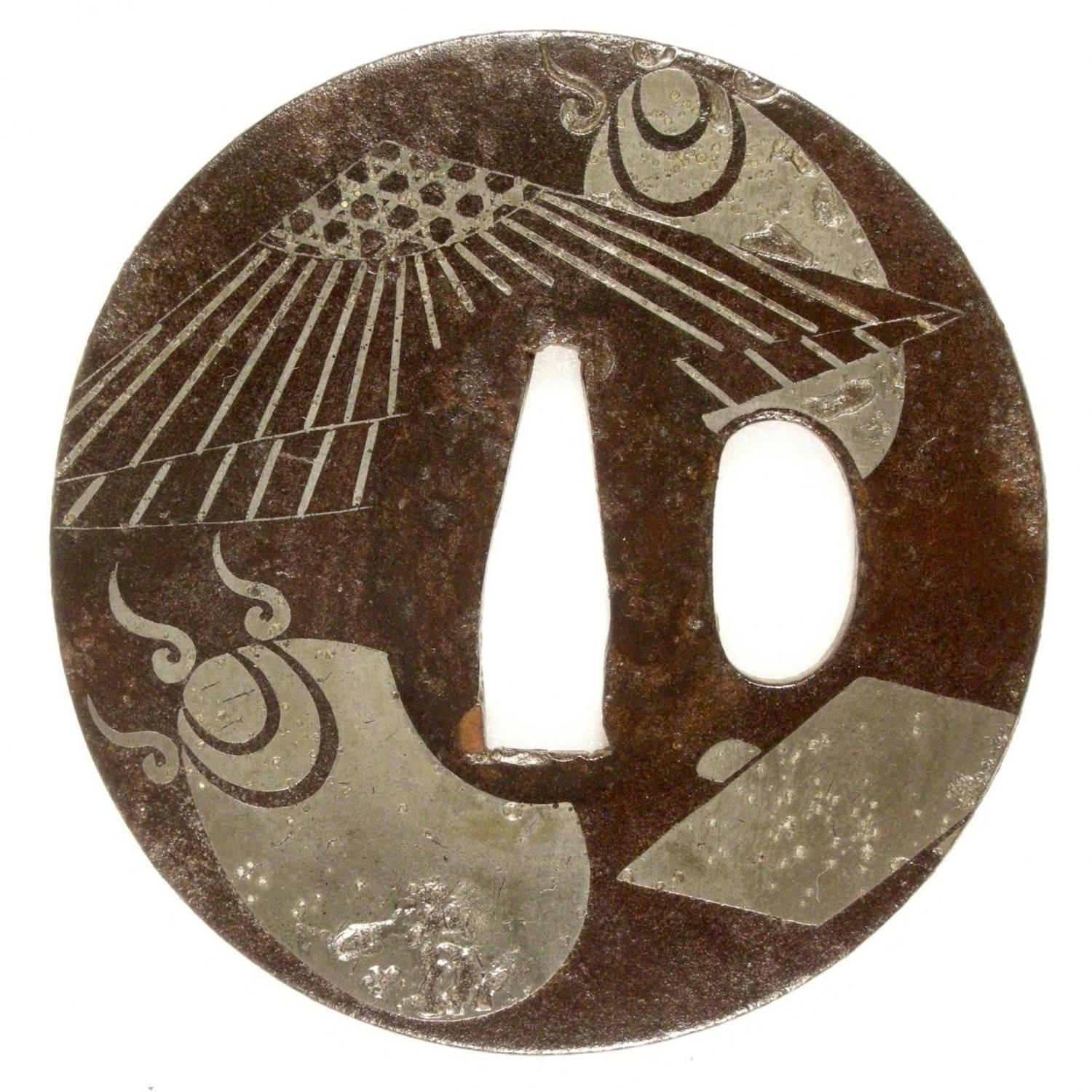

Attached is sahari.
NBTHK Hazama tsuba.
NBTHK signed Kunitomo Teiei tsuba.
Despite what others claim, modern sahari never looks right.
The original stuff was quite poisionous to the producers. On contact, it will test extremely hard like the surface of a diamond. In comparison, iron will feel extremely soft.
Iron may come and go. Sahari rocks on. Long after the iron had decayed, the sahari will be there.

Thank you Curran. On color pictures you can see very well that this is not Sahari on my tsuba.

Sahari is a cast product usually and is subsequently fired to remove surface lead from the object, I think it is called yakiageru. Anyway on tsuba I find blemishes, bubbles, pits etc. that look as if the tsuba has been baked after the sahari added. This might account for the look some pieces have, fired a little longer than others. John
