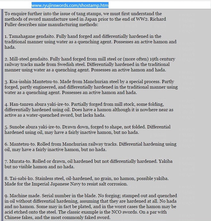

as you can see from Dave's attached info paper, folded steel and HAMON are different features. Quenching in water for an 'active' HAMON requires a very pure steel free of alloy elements (except carbon), but most industrial steels (which can contain elements like manganese, silica, chromium, nickel, vanadium a.s.o.) have to be quenched in oil to prevent cracks.
Certainly it is 'an o.k. sword', depending on what you were looking for. It is a modern war relic, not a SAMURAI sword.
