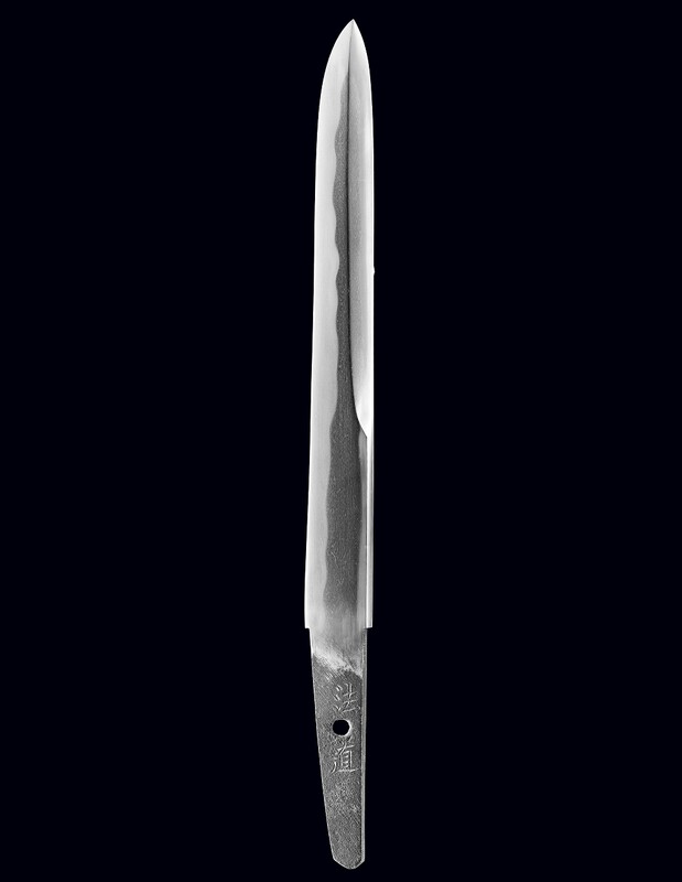

Hello new poster,
Norimichi 法道
See this entry and the one following it
https://nihontoclub.com/smiths/NOR8
I cannot comment on the authenticity of the signature. I will say it is misleading for the seller to list this as unsigned. Unsigned should mean unsigned, and shouldn't have to be second-guessed as a judgement on the existing signature.
Note the forum rules that require people to sign with a real name.
John A. S.
I have no idea why it would be listed as 'unsigned'.
The smith is rated as 'jo saku'. I don't think it would be a likely target for gimei signature.
It looks like a nice, and possibly Kambun from the shape.
That also happens to be when the smith worked.
https://www.the-saleroom.com/en-gb/auction-catalogues/mallams-ltd-cheltenham/catalogue-id-srmall10048/lot-e974f92a-e54c-46e2-8499-a80900a9fbe2
Thank you for confirming my guess about the blade, and despite the claim by the auctioneers that it was 19th Century, and with no mention of a signature
This sale did contain gimei pieces, and I guess the auctioneer did not want to legally guarantee the piece by making an attribution.
i bought because it seemed right- and it called to me.
Thank you for giving me the smith's name, and thus confirming my guess of Shinto.

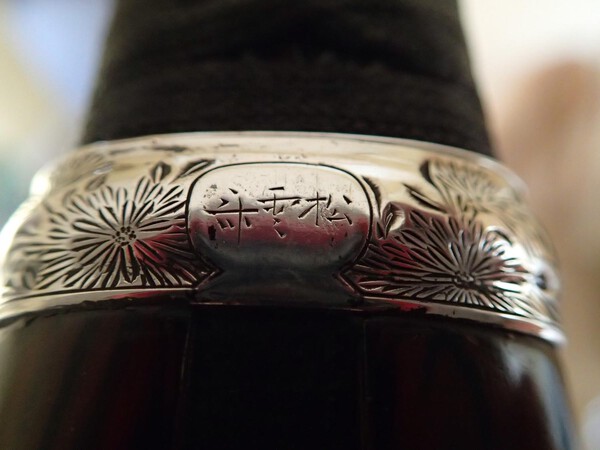

On further examination I have found a signature in the Aikuchi fittings.
I have taken a look through Markus Sesko's "Signatures of Japanese Sword Fittings Artists" but haven't spotted it.
Can you also help me with this as well, please.
Thank you,
