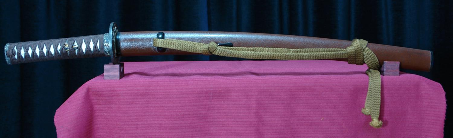

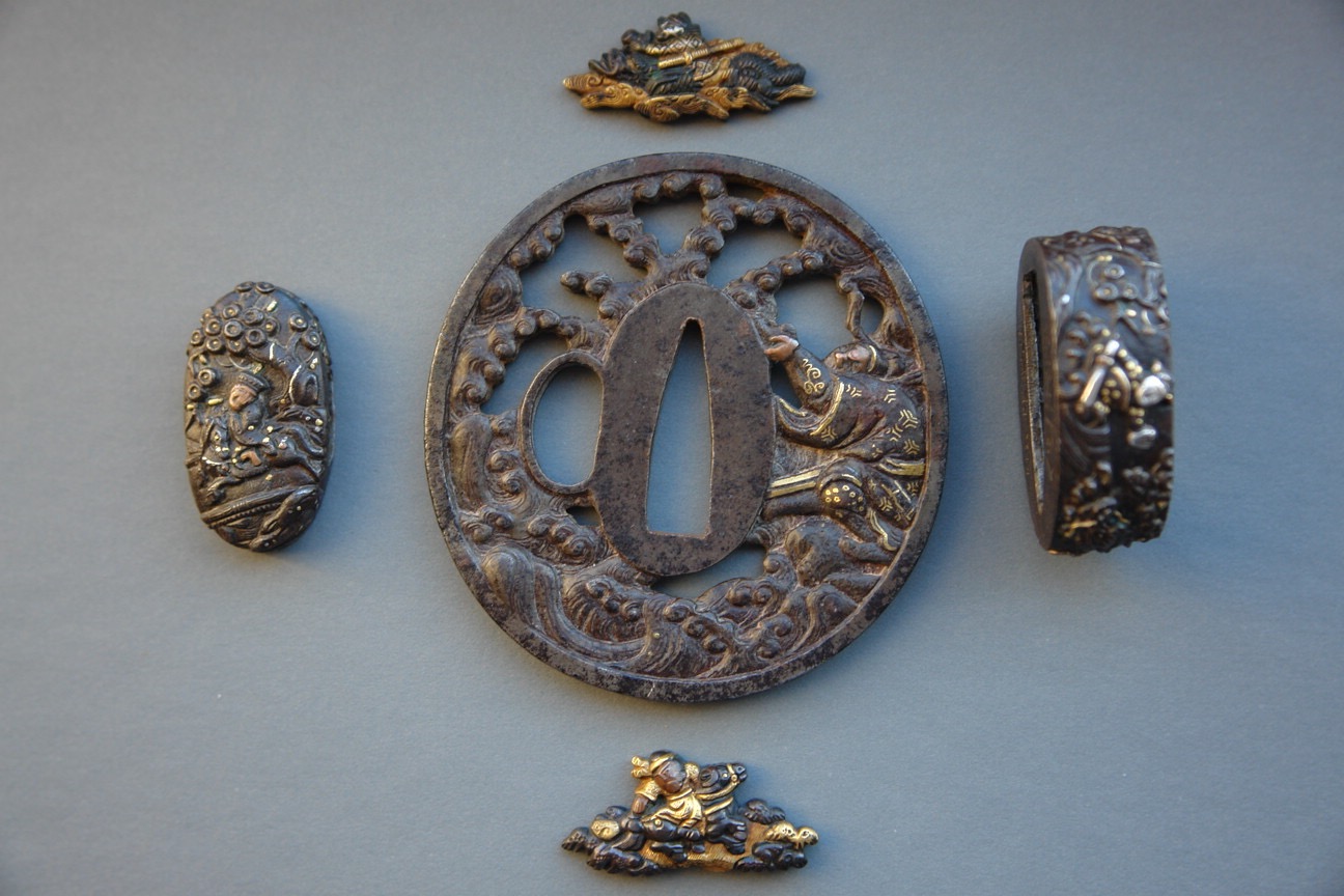

post-2022-0-84728500-1508598438_thumb.jpgpost-2022-0-29025100-1508598457_thumb.jpgFranco has put it right.
Your bought saya, could well accept your blade, and you could be thinking great job done.
Wrong! And wrong it many ways you cannot see from outside. Alex A has it right.
Tsuka, here is a bigger problem, nakago fit and the mekugi ana.
Do you know what the chances are of a match in these areas? At very, very best, nil!
I had this as a decision for a blade.
The only way is a new build, chose your own fittings, get the comfort of those who have the skills around you, and go for it.
Set aside thoughts of future sales costs recovery, you are in the wrong business for that anyway.
