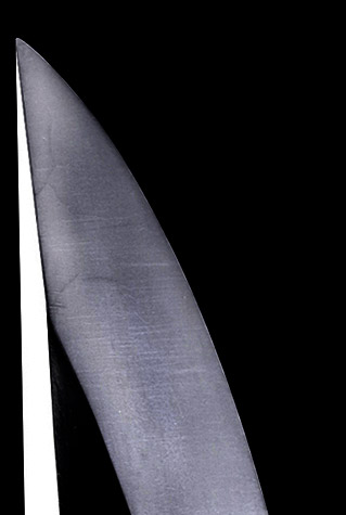

obiwanknabbe Posted October 20, 2017 Report Share Posted October 20, 2017 is this a deal breaker? It does run over into the mune.... It was delivered this afternoon. Should I be asking for my money back? Got it from AOI and this was not in any description. Kurt K Link to comment Share on other sites More sharing options...
Guest Rayhan Posted October 20, 2017 Report Share Posted October 20, 2017 I'm crying for this sword. Does it appear on the other side at all? I've never known Aoi to omit a flaw from their description they have no reason to with the volume they do. Is it papered? Link to comment Share on other sites More sharing options...
obiwanknabbe Posted October 20, 2017 Author Report Share Posted October 20, 2017 Not all the way through.. but as stated, into the mune... about half way across.. not papered.. it was not super expensive but then again, im not rich. this is the best shot i could get of mune.. point and shoot does not want to focus on such a small surface. Link to comment Share on other sites More sharing options...
Ray Singer Posted October 20, 2017 Report Share Posted October 20, 2017 I would consider this to be a fatal kizu. http://www.ksky.ne.jp/~sumie99/episodes.html#temperingcrack 3 Link to comment Share on other sites More sharing options...
obiwanknabbe Posted October 20, 2017 Author Report Share Posted October 20, 2017 I would consider this to be a fatal kizu. http://www.ksky.ne.jp/~sumie99/episodes.html#tempering Kizu or hagiri? I want to make sure i word it properly when i write to them. So angry.. waited almost 1.4 months to get this sword. Link to comment Share on other sites More sharing options...
Ray Singer Posted October 20, 2017 Report Share Posted October 20, 2017 I would refer to it as a crack in the kissaki. http://www.ksky.ne.jp/~sumie99/flaws.html 1 Link to comment Share on other sites More sharing options...
obiwanknabbe Posted October 20, 2017 Author Report Share Posted October 20, 2017 I wrote them a respectful letter and included the pics.. I guess i'll have to wait and see what they say. Link to comment Share on other sites More sharing options...

obiwanknabbe Posted October 20, 2017 Author Report Share Posted October 20, 2017 Original page with description is gone.. but it did not say anything about this.. They are saying its Kitae, not hagiri.. it's a crack.. no question. They will give me my $ back.. - shipping, insurance and registration. This is definitely leaving a bad taste in my mouth... especially after having done so much business with them in the past. Link to comment Share on other sites More sharing options...
PNSSHOGUN Posted October 20, 2017 Report Share Posted October 20, 2017 Fatal. An unlisted flaw like this is completely unacceptable and is grounds for a refund. I would not have a problem if the price and listing reflected it and you got a steal, considering these aren't combat/martial arts swords anymore there is no risk beyond problems reselling it. Link to comment Share on other sites More sharing options...
Jean Posted October 20, 2017 Report Share Posted October 20, 2017 Generally, Aoi pictures are HR and you can see all kizu, even Hagire. Link to comment Share on other sites More sharing options...
Gakusee Posted October 20, 2017 Report Share Posted October 20, 2017 So, this does not look like kitae ware (forging issue) but a crack which might have been due to impact or could be due to tension release upon polishing etc. It looks fatal to me from a combat perspective as if the sword is thrust (less liikely) or swung and the kissaki hits a hard target it might break. Now onto Aoi Art.... I have had successful purchases from them. But I have also seen instances where they Photoshopped out some kizu (flaws) or misrepresented the hamon in their oshigata. So, one needs to inspect photos and items very carefully. The fact that they do a high volume has little to do with integrity etc but the price point they sell at and the English language market they target (one of very few Japanese dealers with full English websites). One also needs to construe carefully the broken English translations and for Juyo items - read the setsumei etc, as those sometimes reveal wishful or very clever marketing. Mostly they are OK though. Link to comment Share on other sites More sharing options...

sabiji Posted October 20, 2017 Report Share Posted October 20, 2017 http://www.militaria.co.za/nmb/topic/23450-buying-gimei/ If you look closely, you can see the crack. Has the blade also a Nioi-gire, as I warned? Gimei, Crack etc, now you know why the blade was so cheap. Link to comment Share on other sites More sharing options...
Guest Rayhan Posted October 20, 2017 Report Share Posted October 20, 2017 Ok so forewarned is forearmed and you can see that crack in the picture clear as day. If you still bought it stop complaining. Ray Link to comment Share on other sites More sharing options...
Ray Singer Posted October 20, 2017 Report Share Posted October 20, 2017 To clarify, it is not a hagire, or crack in the cutting edge (ha = edge), but I believe this type of crack still occurs during the yakiire process. I completely disagree with their comment that this is a kitae-ware. Original page with description is gone.. but it did not say anything about this.. They are saying its Kitae, not hagiri.. it's a crack.. no question. FWIW, I do not believe they Photoshopped this particular piece. When I take the original photo and adjust the levels in Photoshop, this series of cracks can be seen. Link to comment Share on other sites More sharing options...
Alex A Posted October 20, 2017 Report Share Posted October 20, 2017 Ok so forewarned is forearmed and you can see that crack in the picture clear as day. If you still bought it stop complaining. Ray Do you see that crack clearly in the Aoi pic because you know its there?, I wonder. Anyone can make that mistake. Link to comment Share on other sites More sharing options...
Guest Rayhan Posted October 20, 2017 Report Share Posted October 20, 2017 No disrespect intended Alex, but yes it is right there clear as day. Link to comment Share on other sites More sharing options...
Alex A Posted October 20, 2017 Report Share Posted October 20, 2017 Clear as day, in this pic?, you have good eyesight. Ive just bought a sword from Aoi, wished id sent the images over to you for a once over. And for what its worth, I don't think it was me you where being disrespectful to, the guy could obviously do without the Link to comment Share on other sites More sharing options...
Shugyosha Posted October 20, 2017 Report Share Posted October 20, 2017 Ok so forewarned is forearmed and you can see that crack in the picture clear as day. If you still bought it stop complaining. Ray It's pretty clear in Kurt's original post in this thread but not particularly so in Aoi's. Even if I blow the page up to 400% then it still doesn't jump off the page, though the magic of hindsight does make it easier to spot. We all live in a world where we expect to buy and sell at a distance without the benefit of a hands on examination and something as significant as this flaw ought to have been pointed out by Aoi, as they do with hagire. I don't know what the Iaidoka amongst us think, but if they suggested that this blade was suitable for Iaido practice as was suggested in the original thread, then that too may be material. For me anyway, by stating that the blade is suitable for Iaido practice implies that it is structurally sound Best wishes to Kurt and I hope that this gets resolved quickly. Best, John Link to comment Share on other sites More sharing options...

Jean Posted October 20, 2017 Report Share Posted October 20, 2017 Cool guys. To be factual, you will notice that all kissaki pictures are generally overexposed and so difficult to study. I have good sight and would have passed on this crack if not mentioned by Kurt. I fully concur with Alex. Ray had to photoshop the picture to have a clear view of the crack. Link to comment Share on other sites More sharing options...

obiwanknabbe Posted October 20, 2017 Author Report Share Posted October 20, 2017 As john said, the magic of hindsight.. i look back at my old post and can see it this time around, but it's easy to find Waldo when you already knew where he was. I'm not mad about having paid what i did.. otherwise it's a really nice sword and the fittings are sweet.. I am upset at the fact that it was not pointed out at all in the listing... If it has said i would have seen them for what they were .. and moved on..... Further, i'm disappointed at how it's being mischaracterized now... especially seeing as everyone here seems to agree that it is a quench crack. I may return it with lesson learned.. anyone know what the registration cost is? Just trying to figure out what this lesson will cost. and no.. there is no Noigiri.. its totally solid otherwise. just a slightly raised eyebrow.. did ANYONE catch those cracks the first time when i posted about this blade? Not at all to say it's not totally my fault for missing it (it is and mea culpa).., but i think i get a few less points off if the pros (which i am not by any stretch of the imagination) missed it too. Link to comment Share on other sites More sharing options...
Ray Singer Posted October 20, 2017 Report Share Posted October 20, 2017 If I was evaluating based on the photos as-is I would likely not have caught the presence of this kizu, but I always enhance photos of swords I am considering in Photoshop (increasing contrast and adjusting levels) to see more detail. It is shocking what can be seen sometimes which is not obvious in the default images. For example, an area of kakedasu that can been seen through the kesho by adjusting the image. Aoi handles a large volume of swords and it is apparent that things like this slip through, but they have always offered a refund in the past when I found something that was not accurately described. did ANYONE catch those cracks the first time when i posted about this blade? 3 Link to comment Share on other sites More sharing options...
obiwanknabbe Posted October 20, 2017 Author Report Share Posted October 20, 2017 Thanks for that piece of advice Ray.. I don't have photoshop anymore but this is a good technique for getting a better feel for swords being offered from afar. Live and learn. I'm going to return it and take the 150 dollar or so hit. Cheaper than a college credit and a better lesson all around. Link to comment Share on other sites More sharing options...
